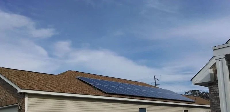

Any reason you can't use your roof? That's where most systems get installed anyway. Mine is and all my neighbors the same. I wanted to completely cover my roof but they have a residential limit of 6kW in my area for grid tied. I could put more up but would have to have a battery setup for it.
Cost, size and orientation.
It was about half the price to do a ground installation vs a roof installation. Then I factored in my 15 year roof would need replacing in about 10 years and it would cost $10,000 to uninstall and reinstall the panels at that point.
My roof also maxed out at about 12kW of panels. I could load the front side as well but I’d be paying for extra panels without the same output. On the ground they’re due south. My frontside would face northeast and would produce less than half what they do on the ground.

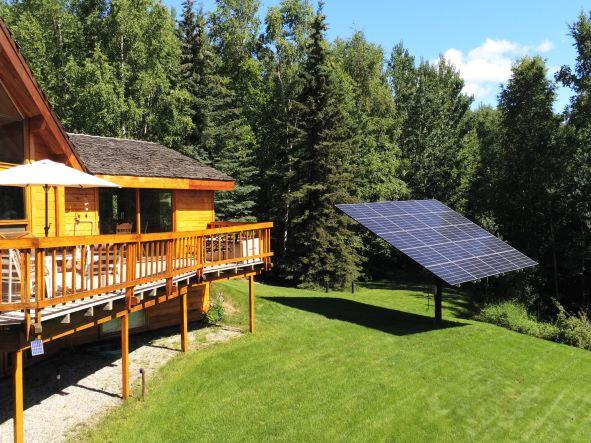

That's exactly my problem. They're all ground mount but I'm running out of ground.
How about a pole. Only 1 sq. ft. of ground and a little bit of blood every time you mow. You can locate the pole anywhere and rotate the array on the pole to whatever direction you want. And you can adjust the tilt seasonally if you live at a more northern latitude.

@Bandit216 Single pole mounted systems are not permitted/against code where I live.
