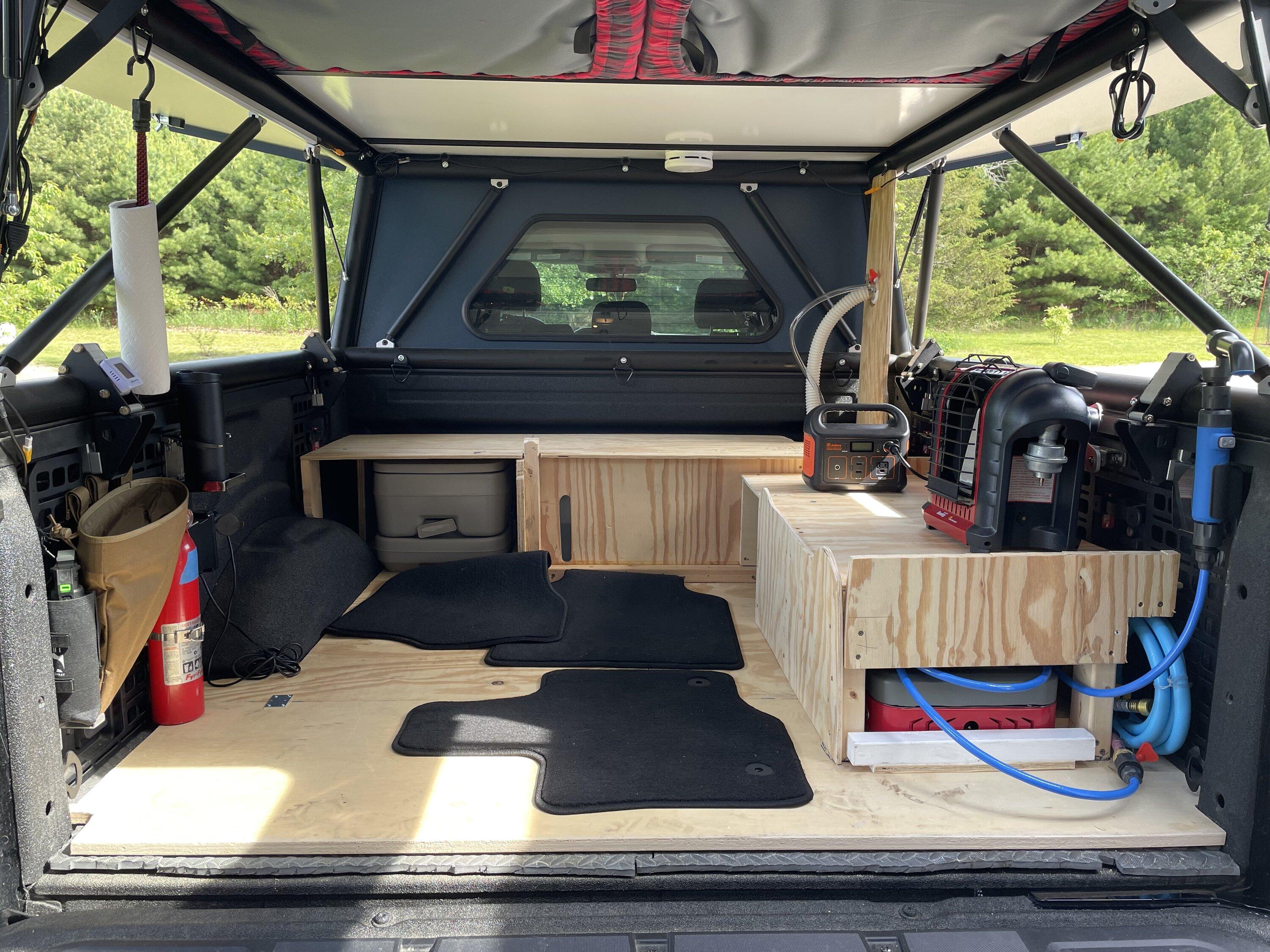

Bro's - JOOLCA rocks! Camping with mine this year in my truck camper, is amazing to have running water, and hot when you want it! Uses propane to heat, but heats wicked fast and plenty hot. I even got a shower awning bolted to my GoFast Camper so I can shower like a BOSS.
Now to the Lightning - This year, I did all that with my hypbrid F150. The downside to Joolca is takes up more storage space; so for my longest trips, I actually left the heater at home, and just ran a 12v water pump. That is where the Lightning frunk comes in, because from here on out when camping, my Joolca lives in the frunk, and will be the old guy with the s**t eating grin on my face after a shower. Be warned though, that will suck down the water pretty quick. I roll with an 18 gallon RV-style tank, and that can go quick with showers... but worth it if you have good water supplies. And don't forget how much cleaner dishes are when using hot water; when not, mine build up a bit of a greasy film.
Attached pic shows my setup, with my 18 gallon water tank at front of bed on the right, including my hi-tech water guage (slot in wood). The awning is off the R topper side rail, not open in this pic. But does show the Joolca hose and faucet; to add the shower/water heater, the blue hose would just be plugged into the Joolca water heater, and red hose comes out to shower, which attaches magnetically to a steel plate on the GFC camper side door (which is aluminum).
Currently, I just power the 12V pump off a Jackery (the orange box there), because that way I didn't have to wire a switch, LOL. Turn on or off the 12V socket on the Jackery, and water flows. Could use it to truck AC, but would have meant an intermediate inverter step anyway for the 12v pump, and I am lazy, would rather be hiking and driving!
