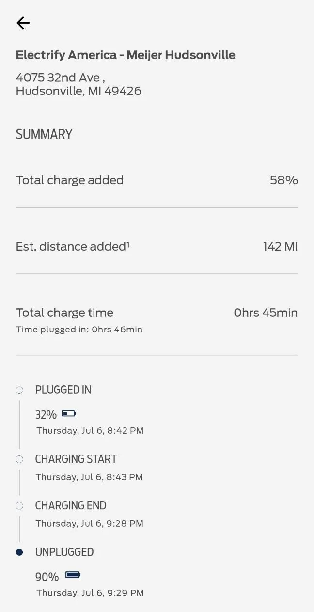

You're going to miss your Tesla when you fast charge. This is the best I've ever done. This was on a 350kW EA station. It's about the same time going 20% to 80%. Add another 5 minutes or so on a 150Kw station. And this is if they are dispensing perfectly, which sadly as of late, is pretty rare in my experience.
Ford F-150 Lightning How many miles? Screenshot_20230808_221141_FordPass
With home charging, the fastest you can charge is at 48 amps, so 11.5kWh. Your battery is 98kWh, so about 8.5 to 9 hours from 0 to 100%.
