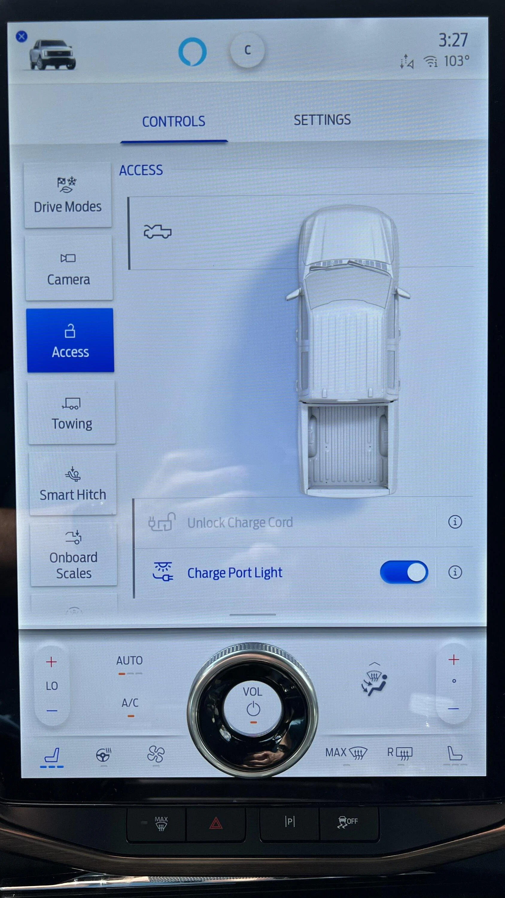

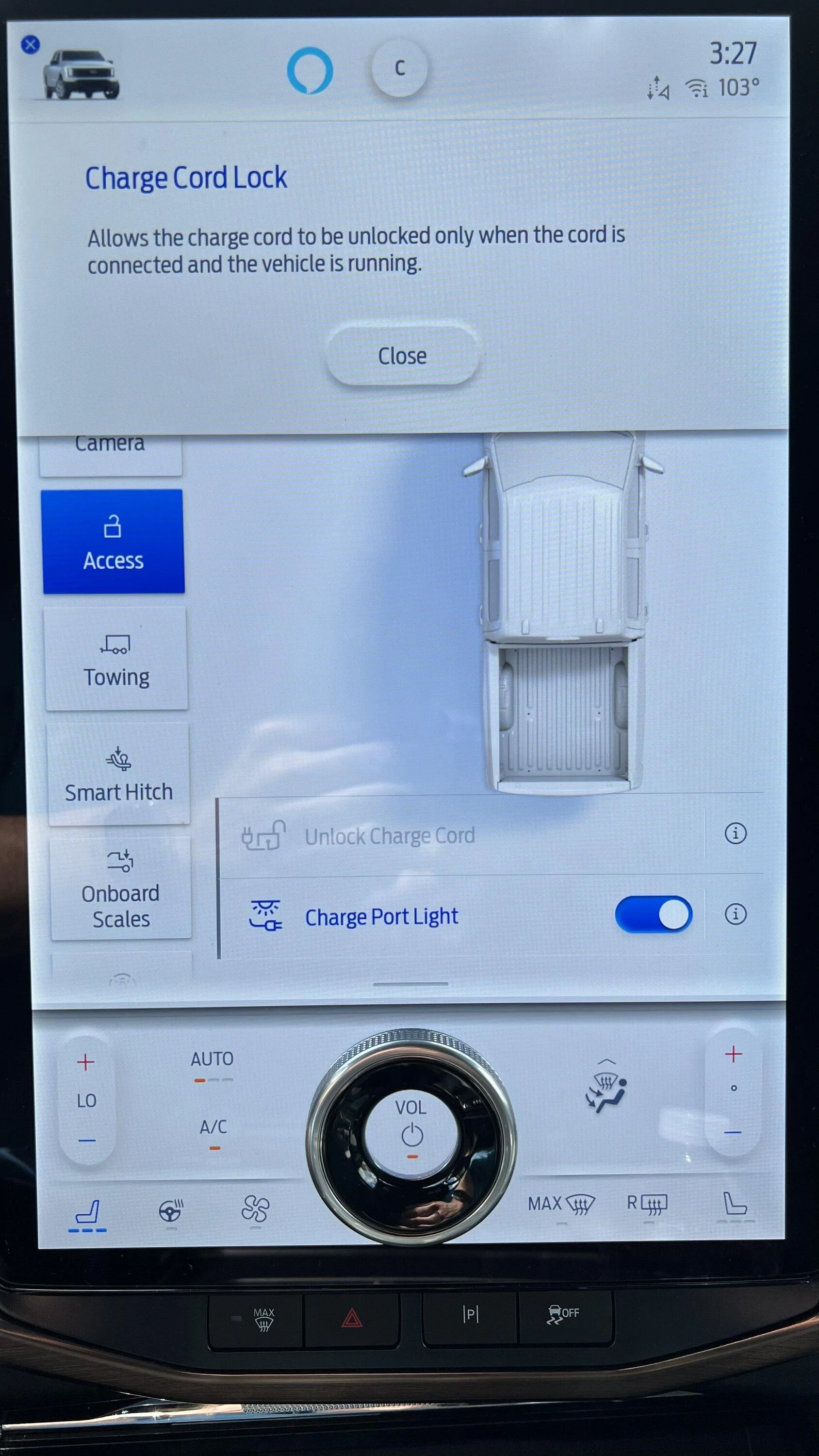

Does the “Unlock Charge Cord” setting only apply to DC chargers (and Charge Station Pro)? This is my first EV and I have yet to use a DC charger with the Lightning and still haven’t received my CSP. The setting can’t be modified when it’s connected to the mobile charger.

Correct - only the DCFC's lock. A big oversight. All chargers should lock into the port.

The physical standard for the J1772 connector expects all unlocking to take place at the handle, not by the vehicle. Some manufacturers created some lockable designs (and someone even created a special collar that will prohibit a J1772 connector from coming loose from the Tesla J1772 adapter). It's a pretty significant oversight, and the engineers figured the safest option was to allow disconnection and they really didn't consider malicious intent by anyone.
