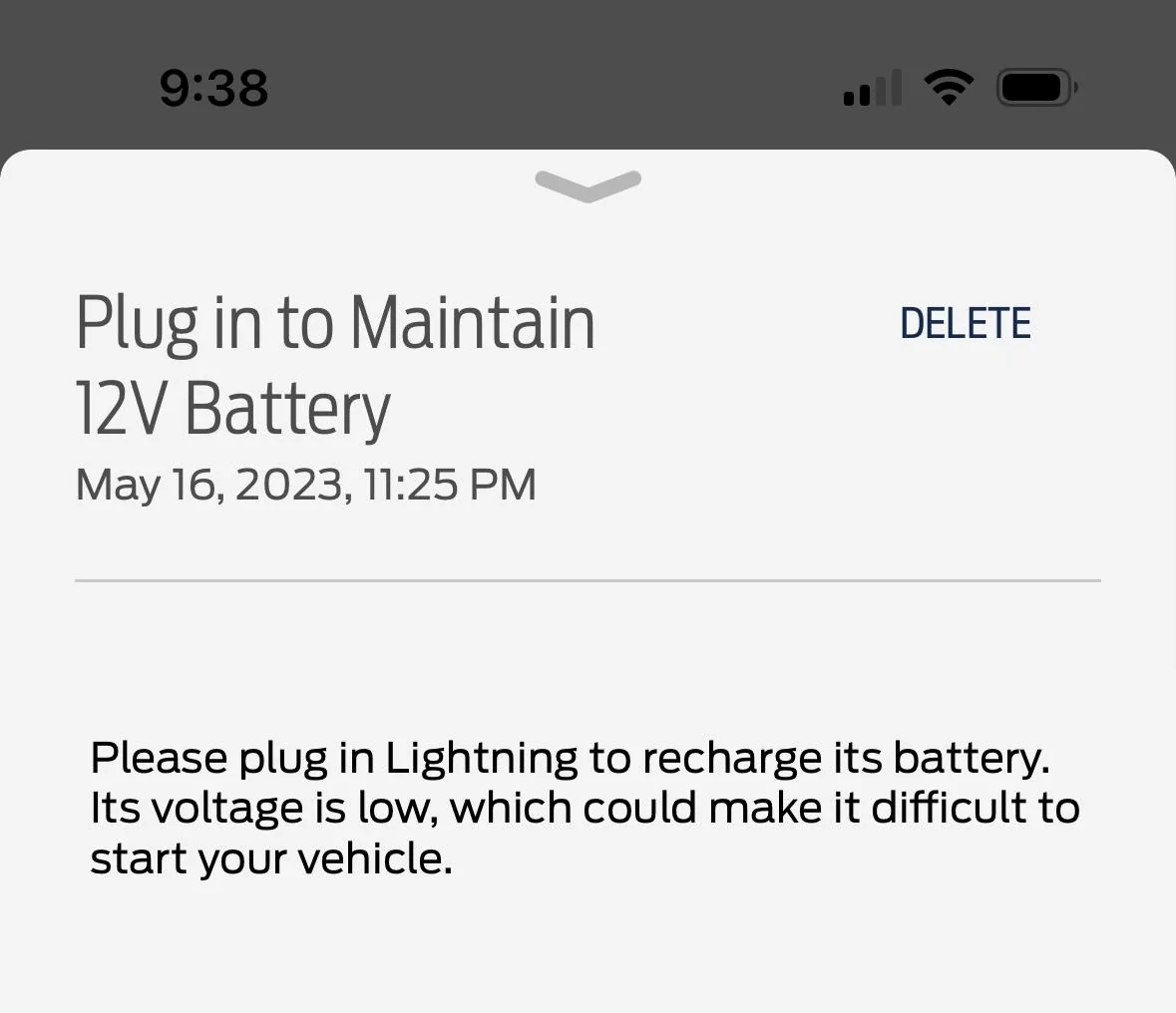

I get the "Electrical System Drain Service Required" message from time to time. Dealer "Performed Battery Minder Reset" and said it was fixed. I got the message again 2 days later.
Here's a new one below from last night which was paired with the drain message. The craziest thing is - I only get these darn electrical drain messages, and now the "plug in" message, WHEN THE TRUCK IS LITERALLY PLUGGED INTO THE FCSP, waiting to charge during its preferred time (12am-6am).
Sometimes it goes into deep sleep mode, then misses my scheduled charge window, which is probably the most frustrating aspect of the whole situation.
I don't have any aftermarket accessories. I sometimes leave a phone charger plugged into the USB but not charging anything.

Make sure the 12 volt battery cables are tight and then check the body connection side of the negative cable if you can see it. I'd have the dealer start checking the grounding points and make sure they are all clean and secure and then replace the 12 volt battery as well.

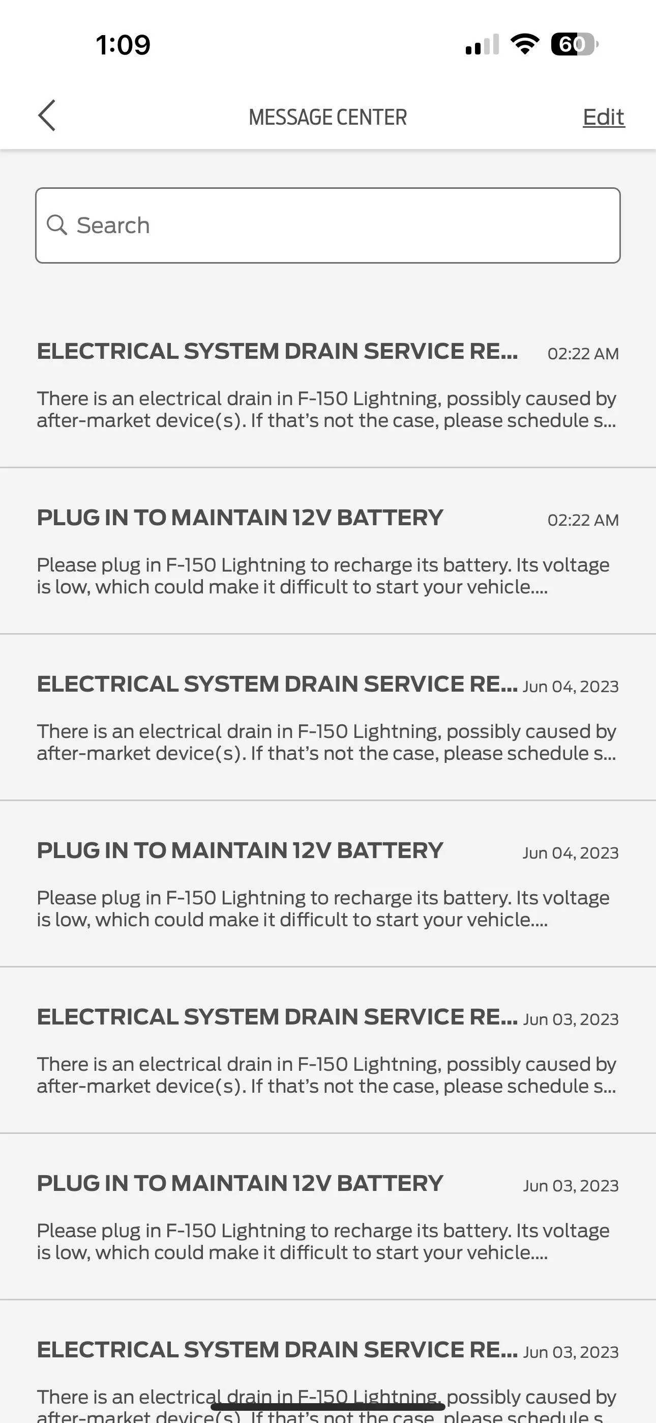

I've started getting these messages daily again. I had this happen once before and they replaced my 12 V battery. Seems like a chronic problem... I do have a couple of aftermarket add-ons, but nothing heavy load. The messages keep coming once I disconnect that stuff, anyway.
Booooooooooooo. Service appointment tomorrow morning to demand satisfaction. Sigh.

I‘m interested to lean the outcome of your next service appointment. I have the same messages, 2-3x daily - now more with the 12v battery warning on top of the electrical drain message. Hesitant to take it to the dealer for them to scratch their heads for several hours/days, especially if you had your 12V battery replaced and are still getting the issue. Wonder if there is some sort of discharge happening, how they would diagnose and test that, and if there is a bigger issue on some of the trucks?

Got it back at lunchtime today. When I texted to ask what they did, I just got:
Various modules were reprogrammed due to high network circuit present
The paperwork says:
DUE TO MULTIPLE DTC ON OTHER MODULES OTHER THAN BCM. PERFORMED UPDATED PCM, ABS, AND ALL RELATIVE MODULES TO LATEST SOFTWARE LEVEL.
Nothing else of interest, really:
PERFORMED BATTERY DRAW TEST OK WITH IN SPEC
As far as I can tell they did not replace the battery this time. We'll see what happens going forward....

Ok interesting. So they basically connected to the truck and ran some module updates. I have already been doing that from home, and still have the issue.
