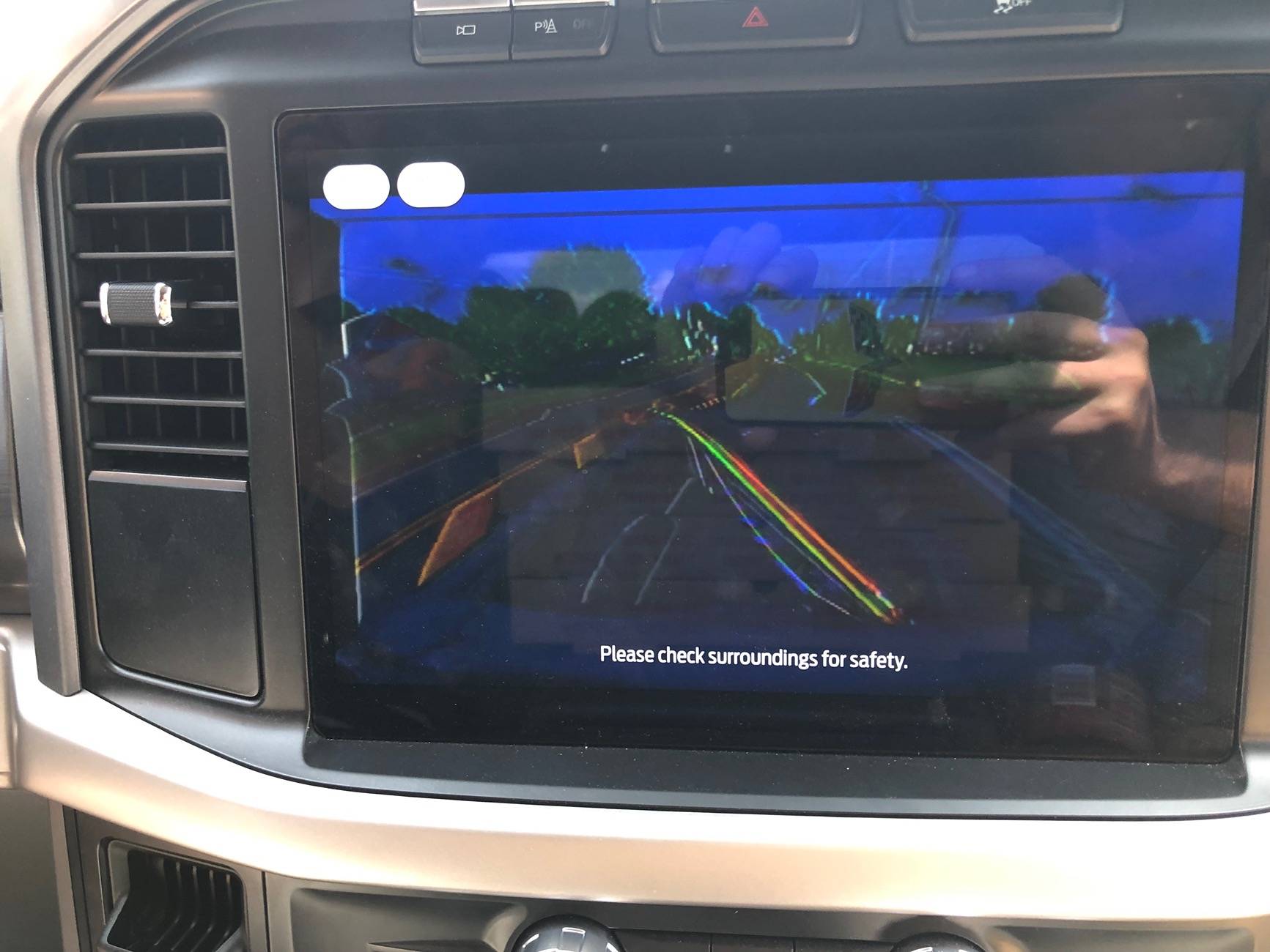

Yup. Occasionally happens to me too (had my passenger take this photo). You're welcome to "borrow" this photo if you have a Pro/XLT to show the dealer. Been meaning to go myself but haven't had the time.

Sounds like we're all having a similar problem. To an earlier question, no, it is/was not hot out when this happens. It seems to be truly intermittent. Wondering if it might be vibration related -- a connector gets slightly jostled.
