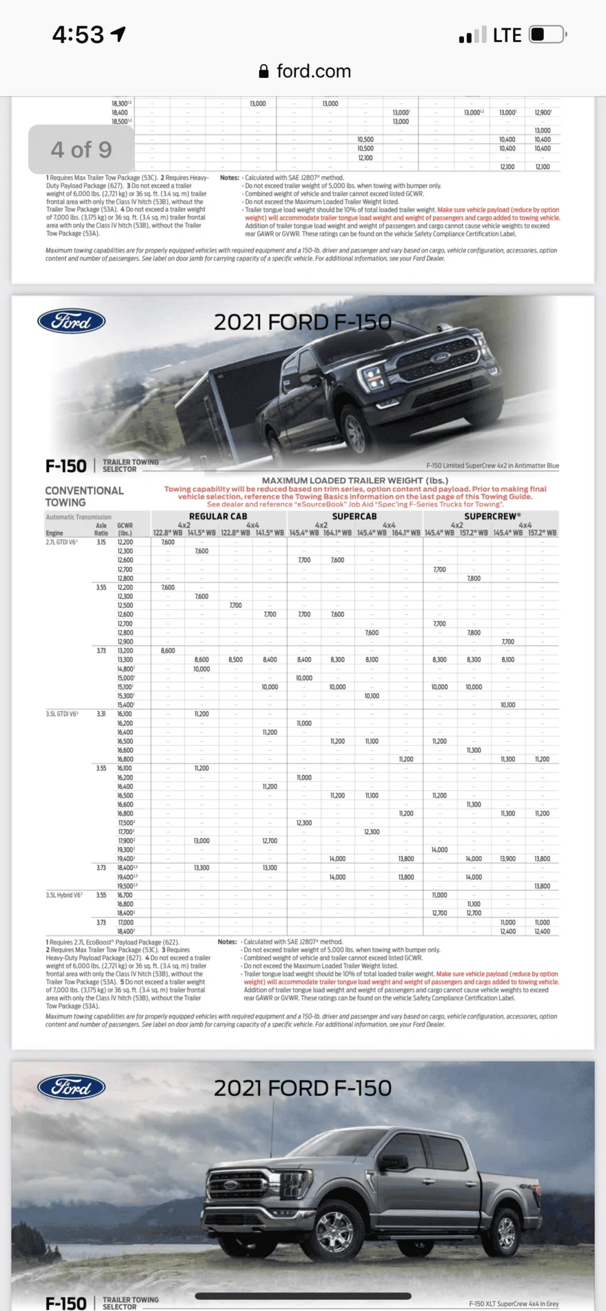

I would check the tow guide. There’s a lot of figures but it’s just a chart in the end. You find your body style, engine and gears to see what you need. It’s arranged so it’s easy to compare different gear ratios for an engine and max vs standard tow.
With a 5.0 and 3.31 locking gets you something like 9800lbs (which is the same as lower gears) without max tow and max tow only adds like 2k more. You can get away with a higher rear end because 10 speed transmission. It may cost you some fuel economy when towing but if most of your time is not towing it will help you the rest of the time.
Anyway…. My recommendation is to go through the charts in the tow guide and decide what you need from that.

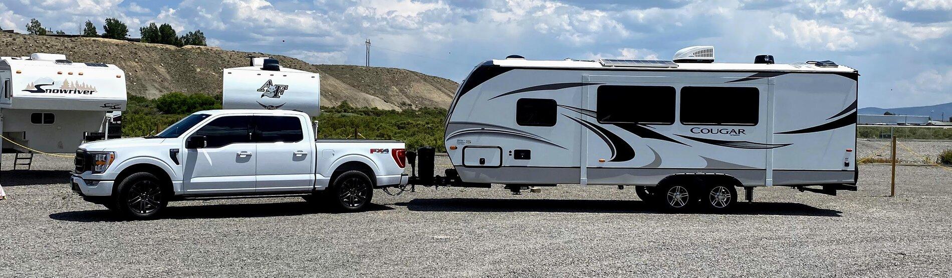

+1 for Max Tow with the 3.5L EcoBoost
+1 for forgoing the FX4 package to save payload
+1 Co-pilot Assist
KR 601A, 3.5L EB, Tow Mirrors, 4x4 (not FX), Co-pilot Assist, ProPower 2kW = 1536 payload
Keystone Cougar 29BHS (34') 7800#, 900# Tongue (per CAT Scales)

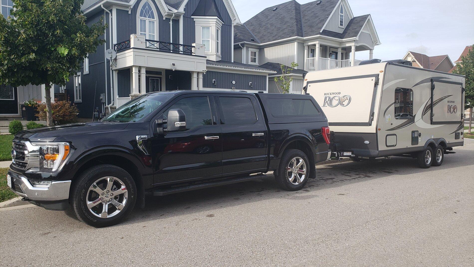

Depends on what and how much you tow and have real use for it. I didnt order the max because the regular does just fine towing my single axle cargo. I also didn't order the FX4 off road package. Just 4X4 for winter time. Also didn't order the big moon roof, since i wouldn't use it even if i had it.

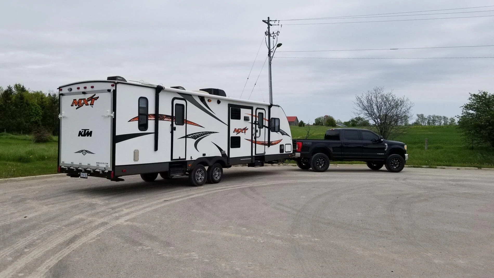

Just Got my 2nd 21 XLT with Max tow, the extra leaf and towing capacity were the deal for me. (traded a f250), added tow mirrors on the new one as well. 35 foot toy hauler pulls fine with these options, My new one is a power boost, already toughened up with that package, but got it anyway! Still miss this truck but the difference is closing in,
+1 Co-pilot Assist
KR601A, 3.5 EB, Max Tow Pkg, Tow Mirrors, 4x4, Spray Bedliner, 360 Cameras, Partitioned Lockable Storage, 1599 payload and rides as good as our 2019 STX 2wd....
Go with the Max Tow...Don't forget to order the Tow Mirrors.....

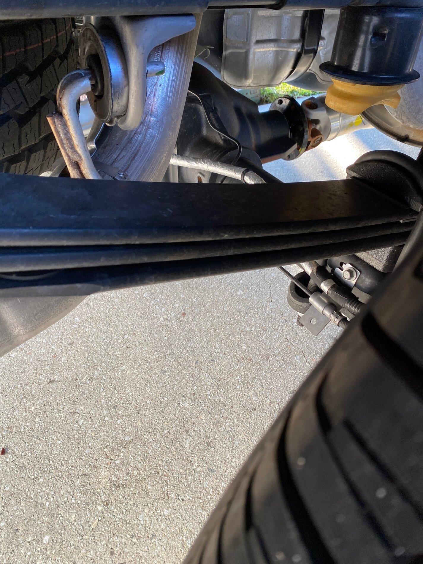

On my Power Boost it put my 3.73 locking axle at max payload and towing capacity.
+1 Co-pilot Assist
Thank you for posting your camper specs...that's exactly what I was needing to confirm. My camper is the same length, and about the same weight. I ordered a 3.5powerboost, Supercrew, 4x4, 6.5 bed, with max trailer tow...downgraded from a 250 because I missed the ride quality and the gas mileage when not towing and needed to make sure I wasn't making a huge mistake. Do you ever take it in the mountains?
