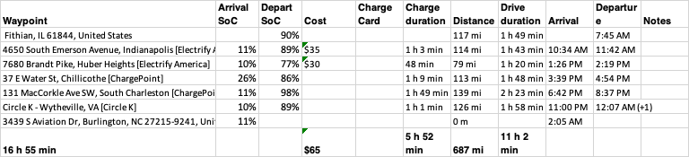

So I will bite. Setting were as follows
Ford Lighting SR
Departing Soc 90%
Reference consumption at 65 MPH 1.86
I admit Im a ABRP novice but if you have a 3 hour charging route help me out.

The SR battery clearly makes it a challenge. I was using my Mach-E ER, same size battery, but lower consumption. The biggest issue is from Georgetown to Williamsburg, where most could make it on an 80% charge, but the SR is saying you would have to charge to 89%. That's a 20 minute or so hit right there.
Changes:
1) Set departing SOC to 100%.
2) Change consumption at 65 to 2.0. ABRP is very conservative.
3) Move trip to 7/1 :). That changes from 4:51 charging to 4:05.
4) Wait until ~Feb. Tesla chargers fill in the gaps. I got it to 3:20 on 7/1 and 4:24 now.

I don't have a route for you, but I do have a few suggestions:
  • For road trips, charge to 100% on AC charging before departure.
    • The extra 10% is useful to extend that first leg of your trip, possibly skipping a charger.
    • If your point of departure isn't your normal daily charging location, start the road trip from when you depart your charger so that you have accurate projections.
  • Use a BLE OBD2 reader to measure your truck's actual reference consumption at 65 MPH, because I don't trust the 1.86 mi/kWh reference value for an SR truck.
    • The ABRP default for an ER truck is 2.24 mi/kWh, but the default for SR is 1.86 mi/kWh, but I don't think there's really should that much efficiency difference between the two. If nothing else, the extra weight and rolling resistance of the ER truck should make its reference consumption slightly lower than an SR truck.
    • I drive an ER truck and my measured reference consumption is 2.34 mi/kWh
    • Motor Trend's highway range test (also with an ER truck) suggests 2.15 mi/kWh
