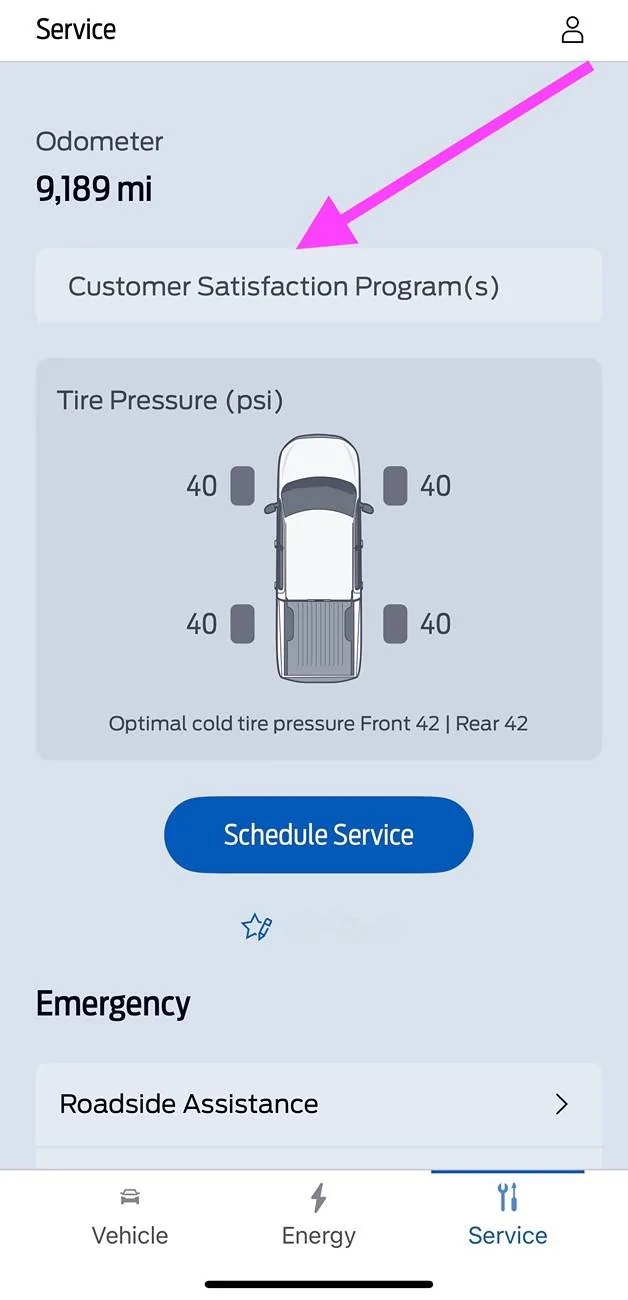

Thanks...but when I go to my Ford Pass app>Service I don't see a customer satisfaction link. Right below my mileage is a Tire Pressure Diagram.
Sounds like you were on the correct screen.
When you do get a CSP the banner displays. Press on that banner and it will give more details.
The CSP banner will not show if there are no CSP(s) for your truck.
This and the Recall links are dynamic, if you have no open issues then the link is hidden.
Double check of your FORD.COM account & vehicle status pages to verify.
