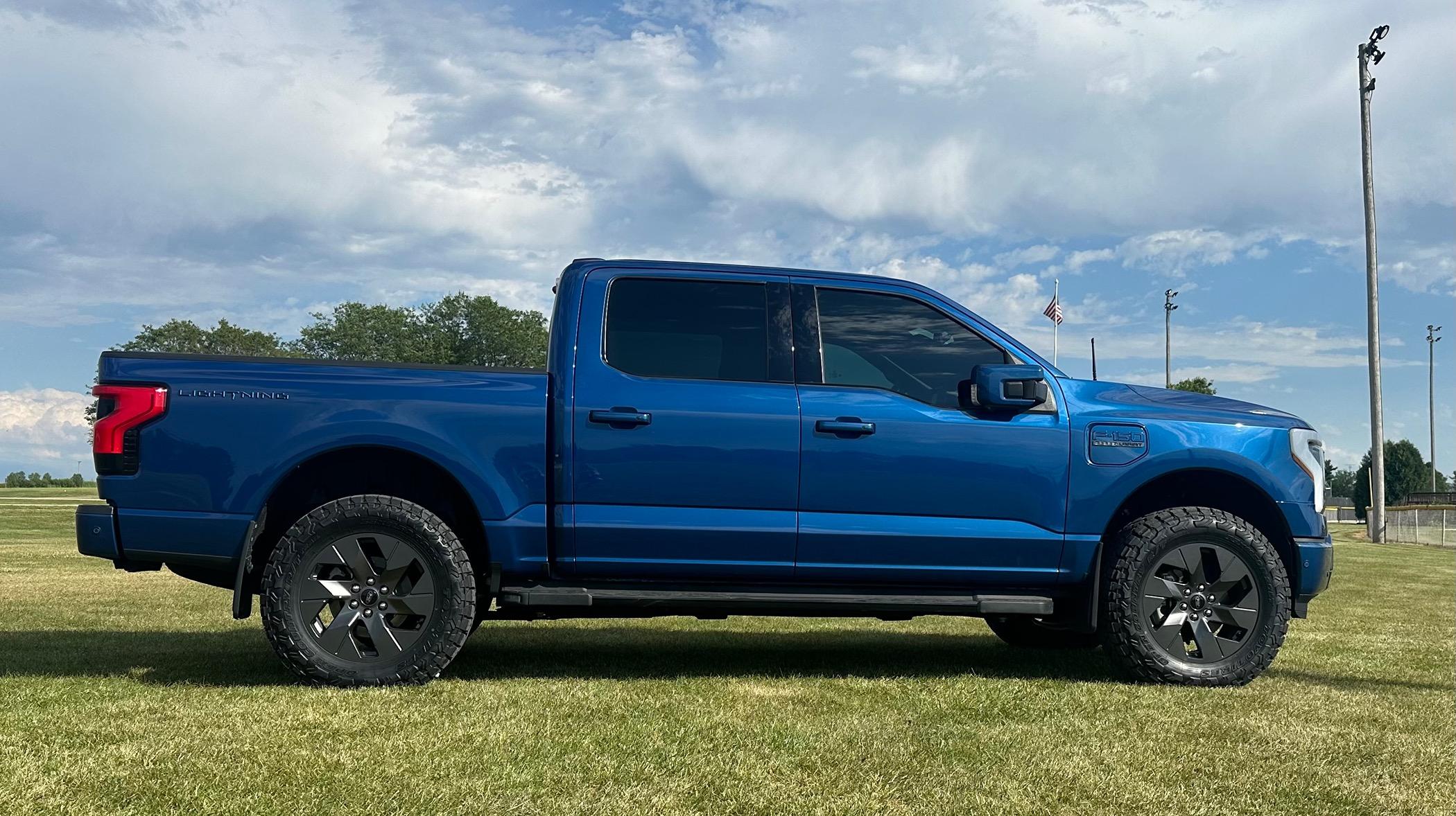

Long time reader (May 2021), truck was deliver on July 19, 2022. Took almost 2 years and 29k miles, but finally added the new tires. I did the Eibach adjustable shocks all around (+2.1” in front and +0.33” in back) in February and the Toyo RT Trail tires last week. After some testing and discussion I went with the 35x11.5r20 and they just fit with no rubbing or spacers. Thank you Discount Tire for your help! Love the look!! Range has dropped the normal 15-20%. The side photo is on a slight slop toward the front making the rear look higher.
Looking good! Thanks for sharing!
