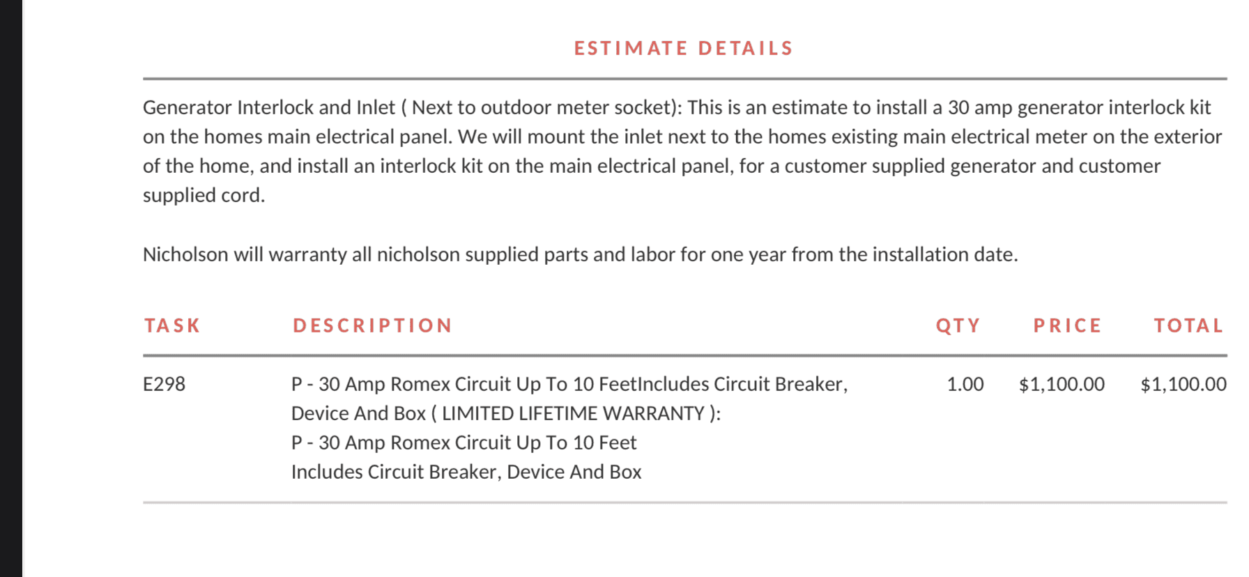

Hey folks,
I got a quote from a local electrician to install a hookup for a portable generator. Can I just plug the Lightning into the outlet? Is there a special cable I need to get?
Thanks in advance.

No, read through many of the other threads along this theme

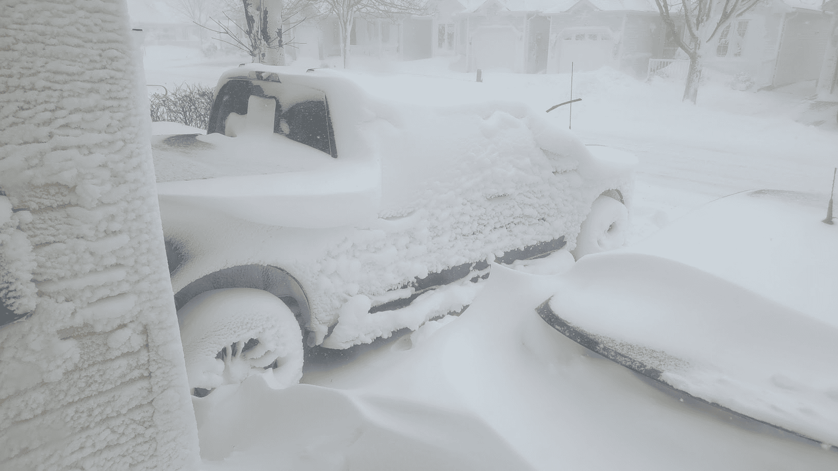

Lost power for 17 hours the truck used maybe 6%. We just had basically 3 circuits on.
For the furnace, water heater, all the internet equipment plus Tv amps, coffee maker and an induction cooker..
