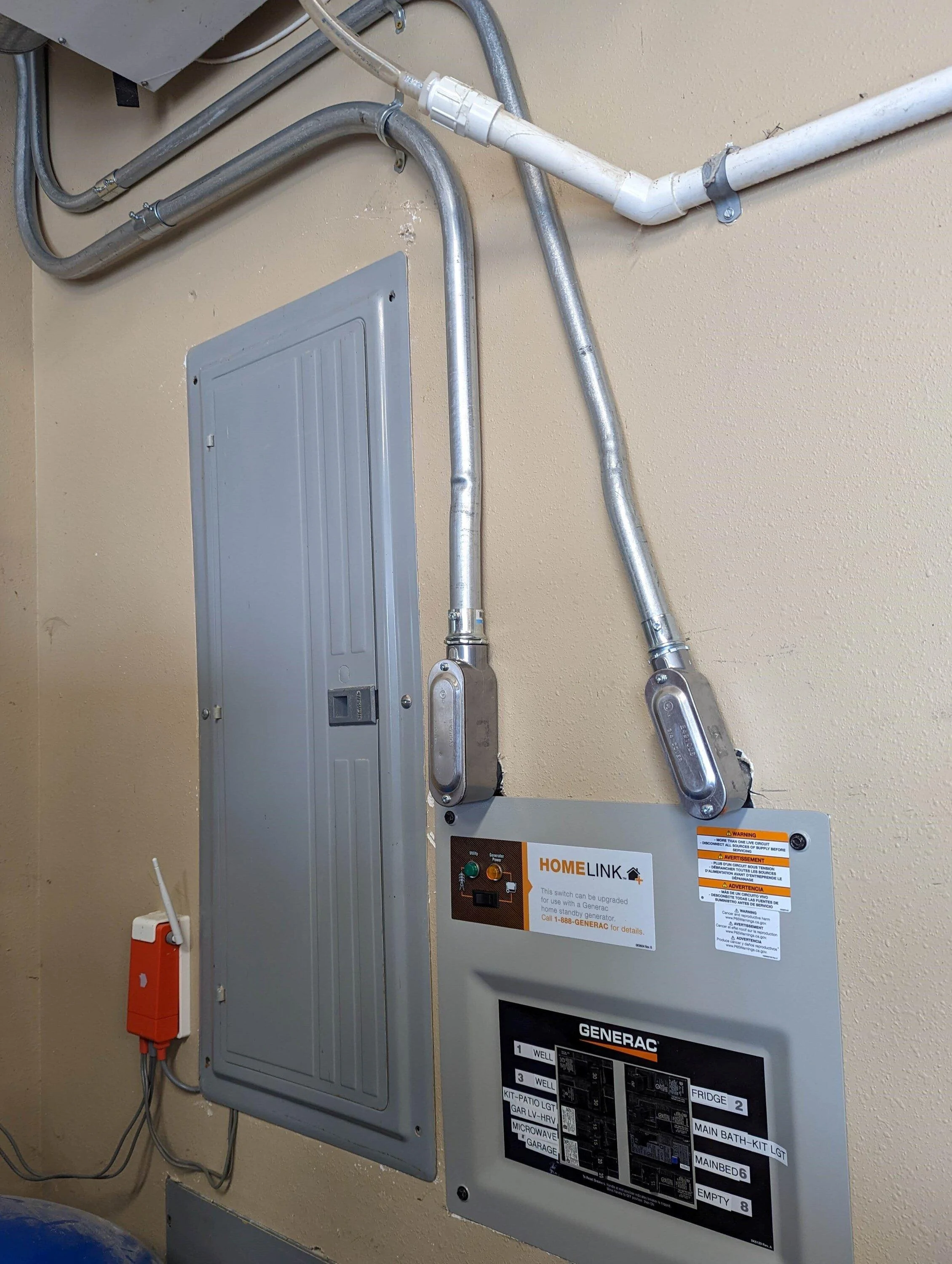

I installed the 30A Generac Manual Transfer switch for number of reasons:
- It uses the same Siemens breakers I already have, and supports their tandem breakers.
- Every circuit you move to the transfer switch panel frees circuits on your main panel (for me it allowed installation of the 100A breaker for the FCSP in my main panel)
- The kit includes a really nice input box. There are three part#'s, 6852 MTS only, 6853 MTS w/plastic input box, 6854 MTS w/aluminum input box.
- The MTS is pre-wired with labeled wires, and 1" flex conduit for your main panel run (if needed). I installed mine in the bay next to the main and used a nipple instead.
- The MTS will take a 30A input, but supports far more circuits than that (espeeislly when using tandem breakers), so you will have a choice of what critical loads you want to use.
Considerations:
- The MTS requires a dual pole 50A breaker (feed) from your main panel. This limits the amperage of what you can use during normal operation, so even though you can, don't move too many circuits over.
- If you use tandem circuits, you may need to upsize the conduit/nipple to the main panel for the additional wire.
- In addition to purchasing the 50A breaker that fits your panel (same or related brand), you need to purchase the wire for the 30A gen/truck input (input box to MTS).
Thinking ahead:

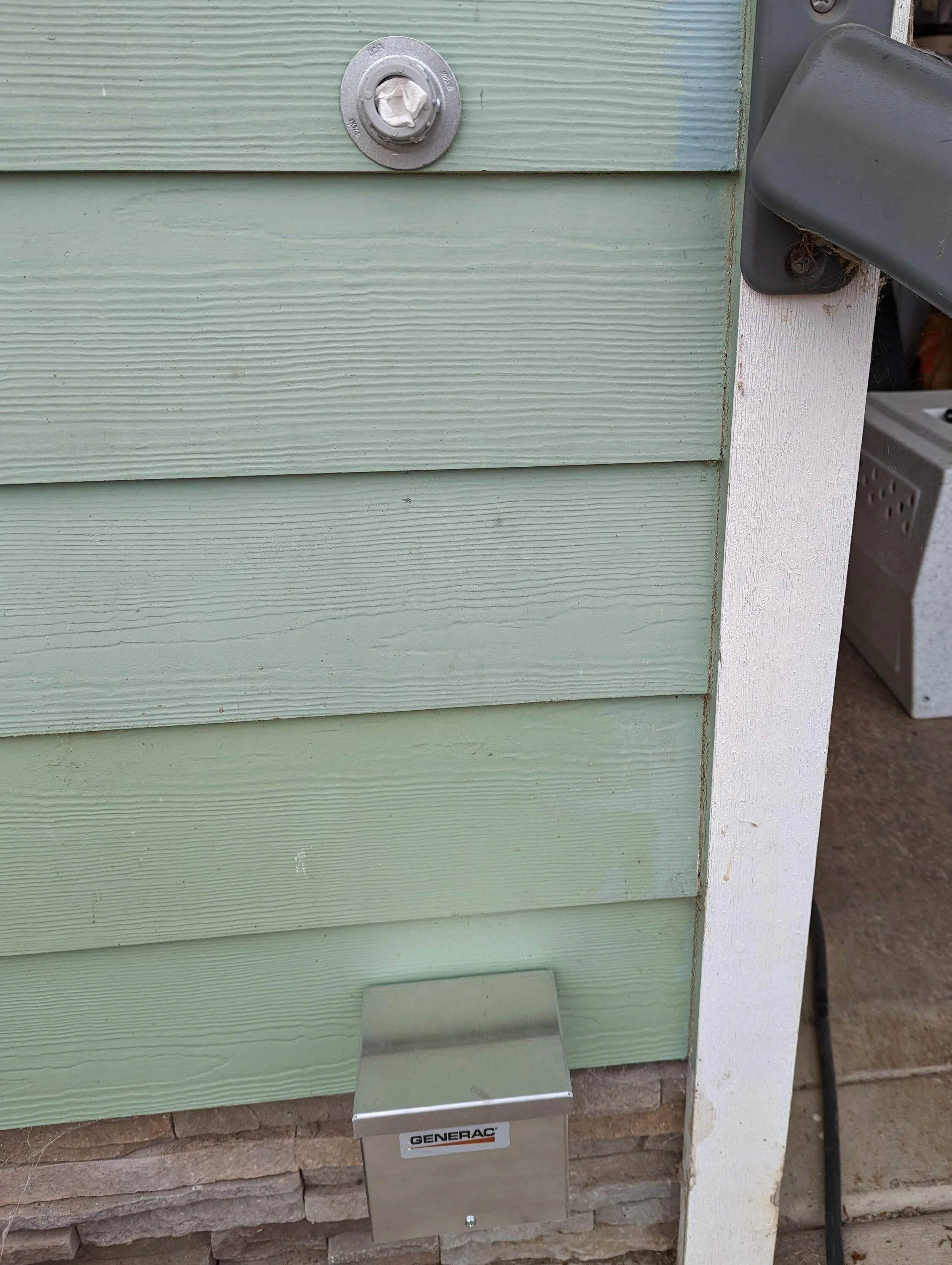

As I was running the FCSP conduit/wires from my main panel to the outside wall, I ran another conduit alongside for the input, and installed the input box below the FCSP location. This will allow me to reuse the conduit and 8AWG wire for the Ford/Sunrun HIS if I ever decide to do that (or something similar). The 1" FCSP and 3/4" Input conduit run to a junction box for the FCSP penetration. Then I continued the 3/4" below to thee gen/truck input penetration.

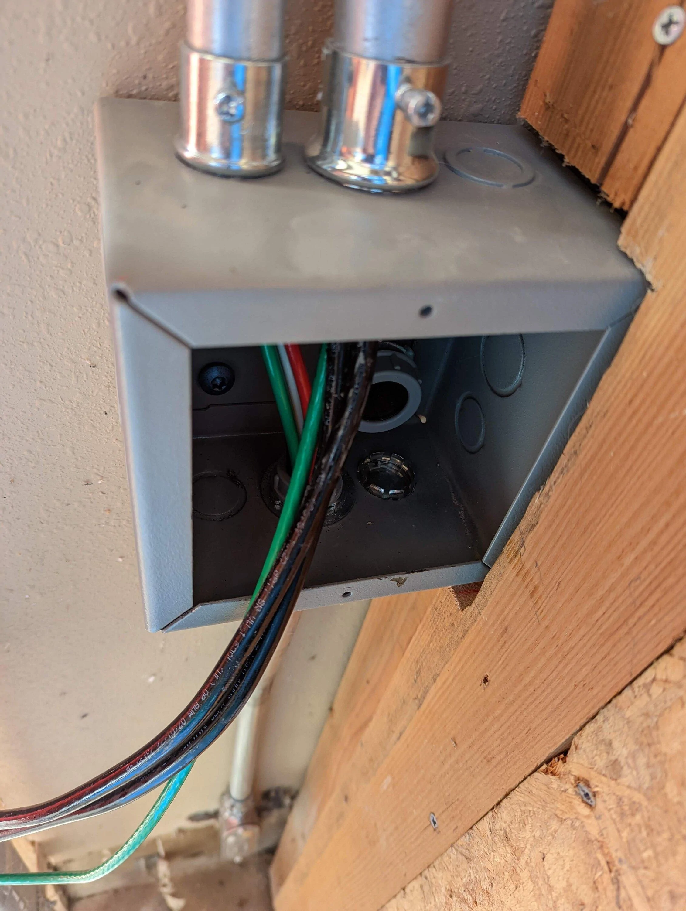

Here are a few pics of my MTS install. The junction box is too small per code, but all I could fit.
