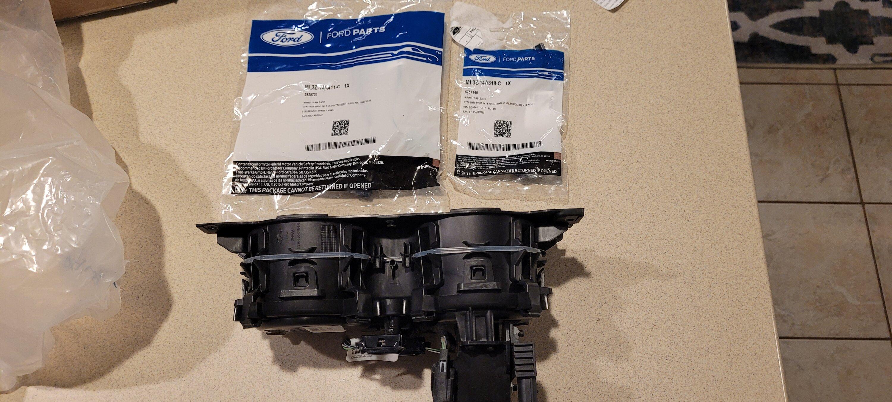

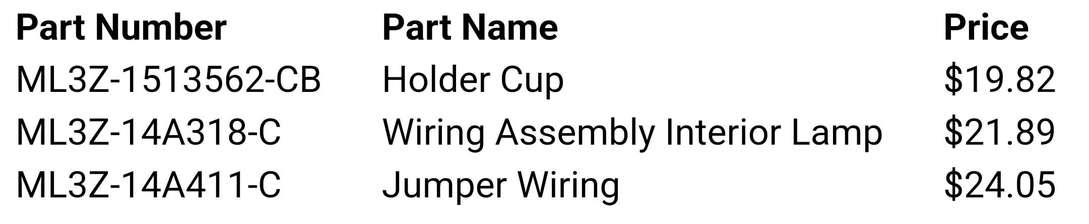

Do you happen to know what the part numbers we'd need are? Maybe I can order them and pick them up when I eventually pick up my truck.
These are the part numbers I ordered to retrofit the missing cupholder, glove box light and cubby light that I currently have on my 2021 ICE Lariat, because we all know there is no 2021 Lightning, to my 2022 Lariat Lightning when it arrives.
You will end up needing to buy or make a writing harness to use these parts.

Once you get these parts and one or two of us get to open our truck to see what wiring is hiding under the console you can easily send @JHForman812 a PM and he does some resourcing and night time magic to help with that last piece - the wiring harness.
