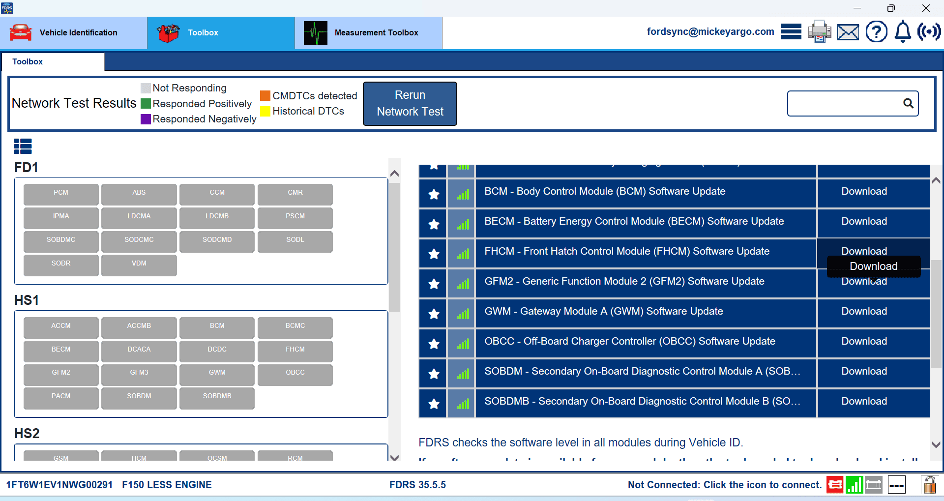

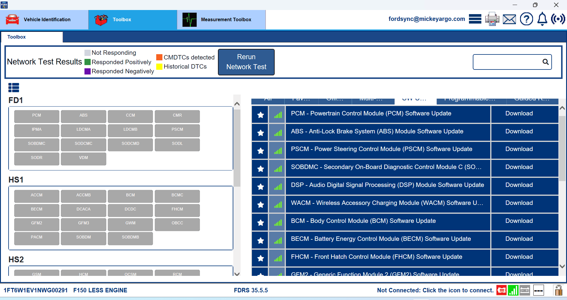

Sorry I copied it from the window sticker PDF and left off the last digit.
1FT6W1EV1NWG00291

You have a long list of updates...could not fit them on 1 screen.

Thank you very much. Will see if dealer will perform these when they replace my battery module.

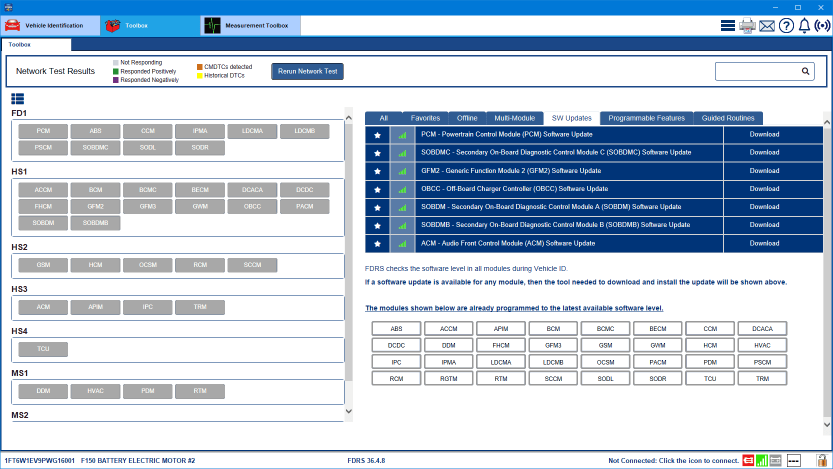

Would someone mind when they have time, letting me know what updates are available for my 23 XLT? It'll be going in soon. Thanks! 1FT6W1EV9PWG16001
5 May '23 build date.
Here's the list of available updates:
Ford F-150 Lightning Lightning FDRS Update 1FT6W1EV9PWG16001-2-Aug-23
I think that ACM update restores AM radio. (EDIT: nope it justs keeps presets from disappearing when other updates are done I guess - according to the notes).

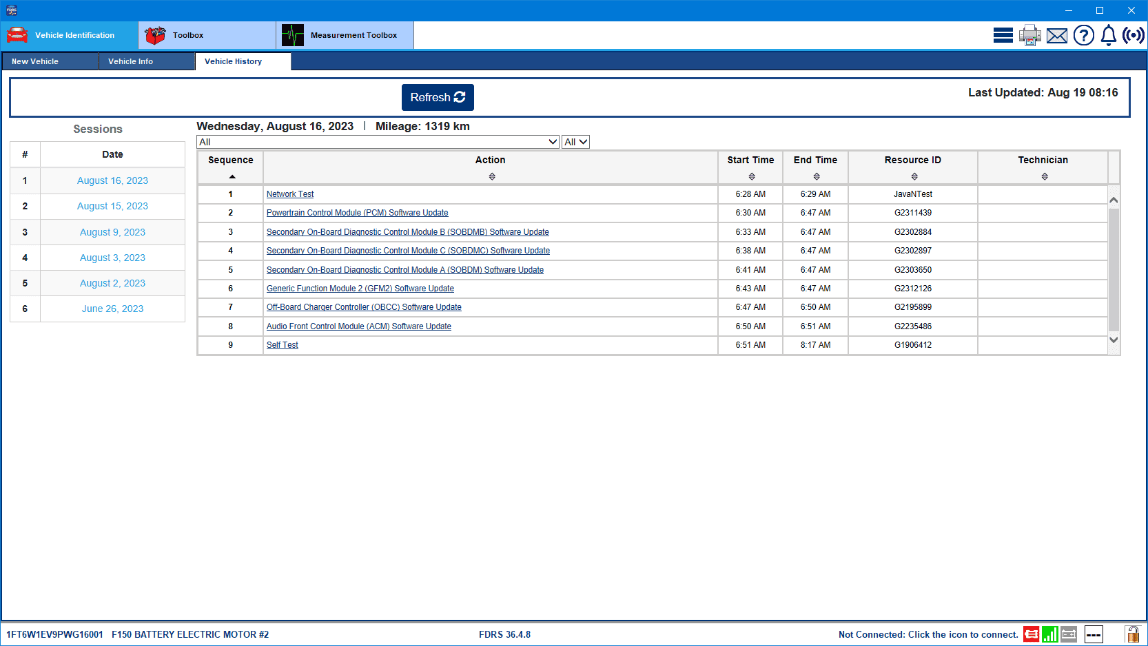

Thank you for that! Does that mean they did all the updates that were showing? I do not seem to have the battery percentage, not sure if that should have appeared.
I didn't see an IPC update in your list from before.
And the only day in this service session log history where programming took place doesn't show any IPC update:
Ford F-150 Lightning Lightning FDRS Update 1FT6W1EV9PWG16001-19-Aug-23
Those other days in the list all were diagnostics relating to DC fast charging or somebody just checking your "connected vehicle" page in PTS looking at the DTCs, or looking up things in the online repair procedures in PTS.
But no IPC update.
