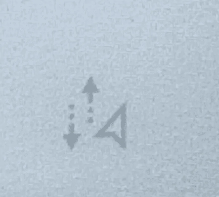

every since updating the modules and getting into the 4.0s I’ve had this icon. Know what this means?
Ford F-150 Lightning Sync Update / FDRS Help 1685224807700

Turns out my vehicle is confirmed to no longer be in fleet status and my FDRS lisc expired. At least I was able to get into the 4.0 sw range and rev 610. That at least got me PAAK. Not sure what else to do now.
