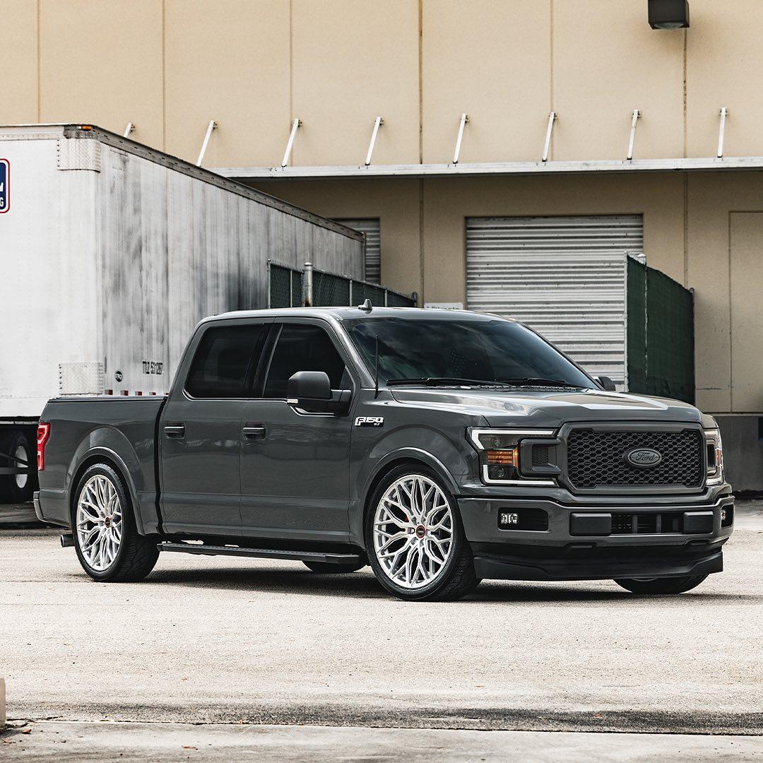

Chopped! That could be slick. Would like something along the lines of these two.

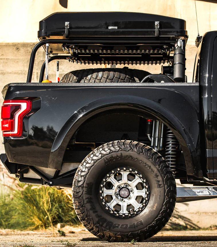

I'd never lift one in the most common definition of a lift.
The long travel front IFS kits that make a raptor even wider will bolt/weld right in just like on a raptor from what I am seeing. These don't really sit higher than a raptor by more than even a inch. They just drastically increase how many inches of suspension travel. Some will stroke 18" with the 4x4 CV axles. They have much more robust fabricated spindles than the OEM ones with better geometry.
What I'd be looking for in the rear is a similar rip it out and replace it all kit.
When the baja market starts modifiying these. Everything will be taken apart off the trailing arm, the front pivot on the frame cut off. Further forward another pivot welded into the frame with a boss thru tube for strength. and likely to the outside of the frame rail for range of motion as much as incresing track width.
A Coilover and a bypass shock will mount to the longer wider plate boxed trailing arm and bolt to a cage in the bed. Basically halfway between a class 1 buggy and where it started out. Probably 20-24" of travel.
I'm getting about 20" of rear travel with upgraded leaf springs and a bypass rack on the first gen Raptor

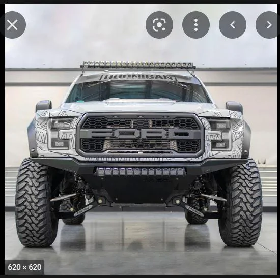

Because the front upper arm, lower arm and shock tower locations are std F150 it means kits like this front end kit will install the same as they did on all 3 raptor generations and it wont be any problem getting fiberglass fenders from ADV either.
