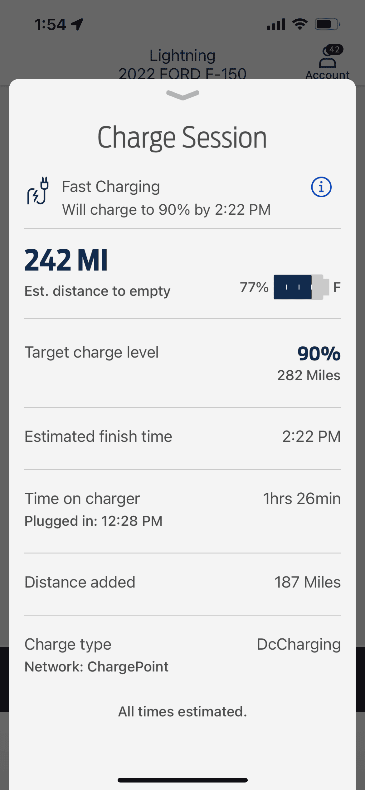

I see they moved it to a Chevy dealership. I’m guessing so it can charge a little faster. They were on a AC basic charger at the dealership and now it’s DC charging. If they didn’t have to charge up the 12 volt battery to get it to start do you think that rules it out? Or would it charge it up while it was on the AC charger. And if the AC charger did charge it up then it should have charged it up at my last charging stop. I’m still thinking something other than the 12 volt battery. I’ll ask the service advisor if they had to charge the 12 volt to get it to start.

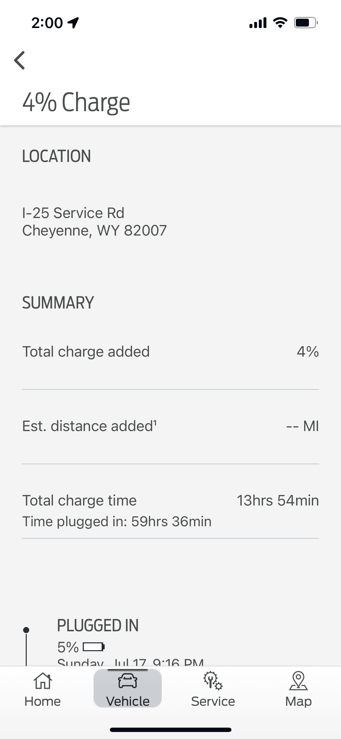

This is interesting. It thought it was plugged in the whole time from when it died on the side of the road till probably when they started charging it again.
When they plugged it in to charge the HVB, the truck would automatically transfer some of that energy from the HVB to charge the LVB as well if low. That's how the truck maintains the LVB... It just transfers energy from the HVB down to the LVB as needed.
There is no alternator to maintain it as you drive like a regular truck.
This process I just described is how it "should" work. This process is where a lot of the Mach Es ran in to trouble. Hopefully your truck just needed a good charge, but it really could be anything involving the HVB, LVB, all the hardware in between, or less likely even the software controlling the way they share energy.
