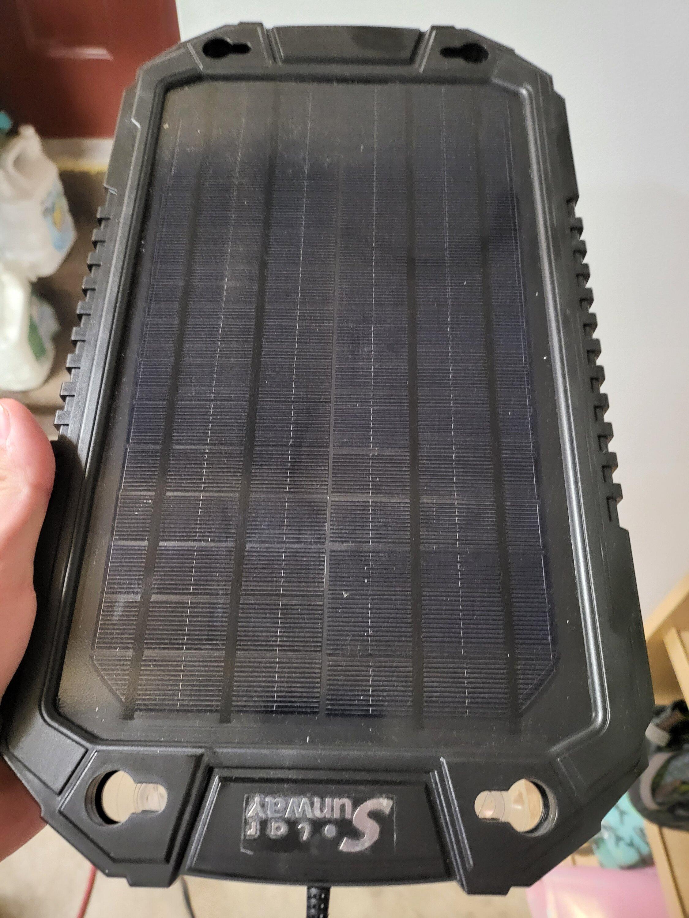

Just get one of these portable solar battery tenders and mount it to your dash or roof. You'll never have to worry about it doing dead again :)
Comes with strog suction cups, but I'd go with color-matched duct tape to make it look professional.
