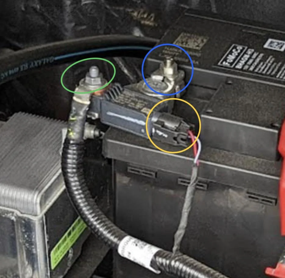

Is yours a 2023? I have the same issue - I'm taking the battery terminal off every 2 days.
Yikes! Are you removing the green circled in this pic or do you have to remove the blue?
Also what does the yellow plug do?Maybe we can just unplug that?
Thanks!

I remove the + terminal (under the red cap) on the right of your picture. (which is cut off).
Thanks!
Green nut works for me. The device the yellow is plugged into is part of the BMS and lets the computer know about various things including current draw and battery voltage.
I do not believe it is ever recommend to disconnect the positive cable (red) before disconnecting the negative (black).
Edit: side note, always connect a charger to the nut circled in green or to a chassis ground so that the BMS can detect it. Connecting directly to the battery terminal will still charge the battery but the truck won't know you did it and might complain.
Agreed. It is safer and recommended. But you can use an insulated wrench and disconnect the positive terminal without removing the negative. The key is that if you are removing the positive terminal without touching the negative you need to make sure your wrench doesn't touch the chassis which can create a short. Either use an insulated wrench or pull the negative terminal.
