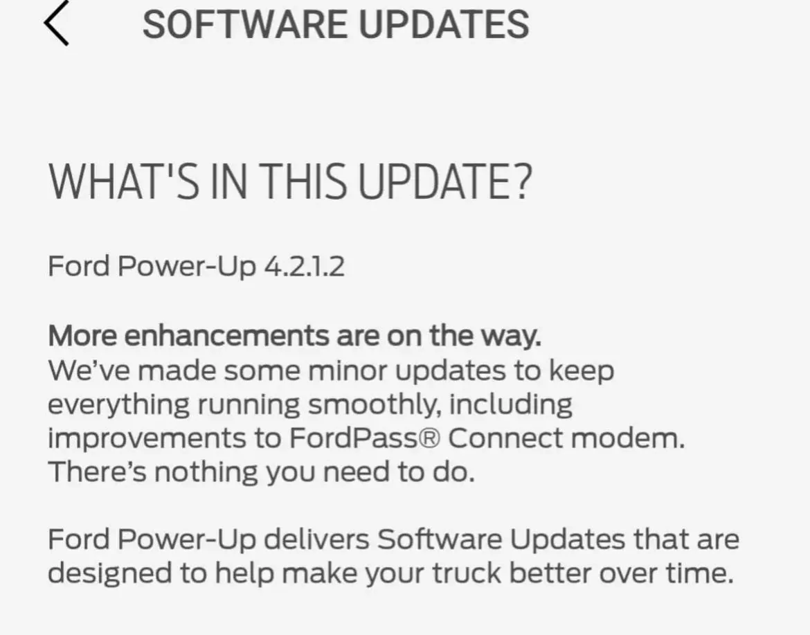

I see there is a 4.2.2 that specifically mentions modem fix. I hope that comes soon. I just got 4.2.1 the other day.
211
15,617
17,447
Where are you seeing this information?
211
15,617
17,447
256fail
Jun 14, 2022
176
160
Alabama
23 F150 311A XLT
Pilot
Oh ok good if you don’t mind me asking where did you see that info on 4.2.2
folks on the Facebook Lightning forum posted a pic. 4.2.1.2 update details that some have received the last day or so.
