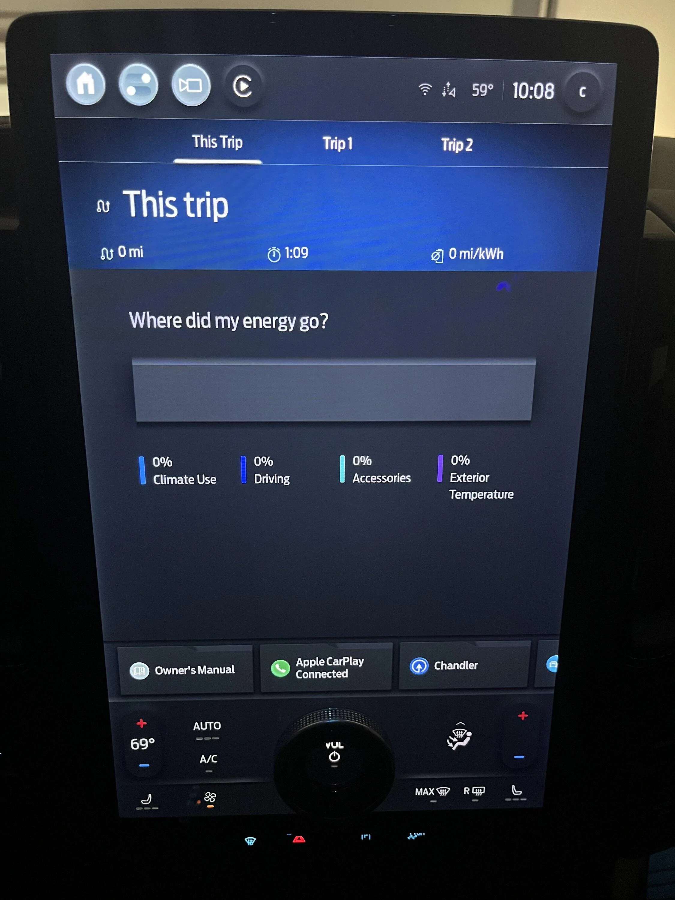

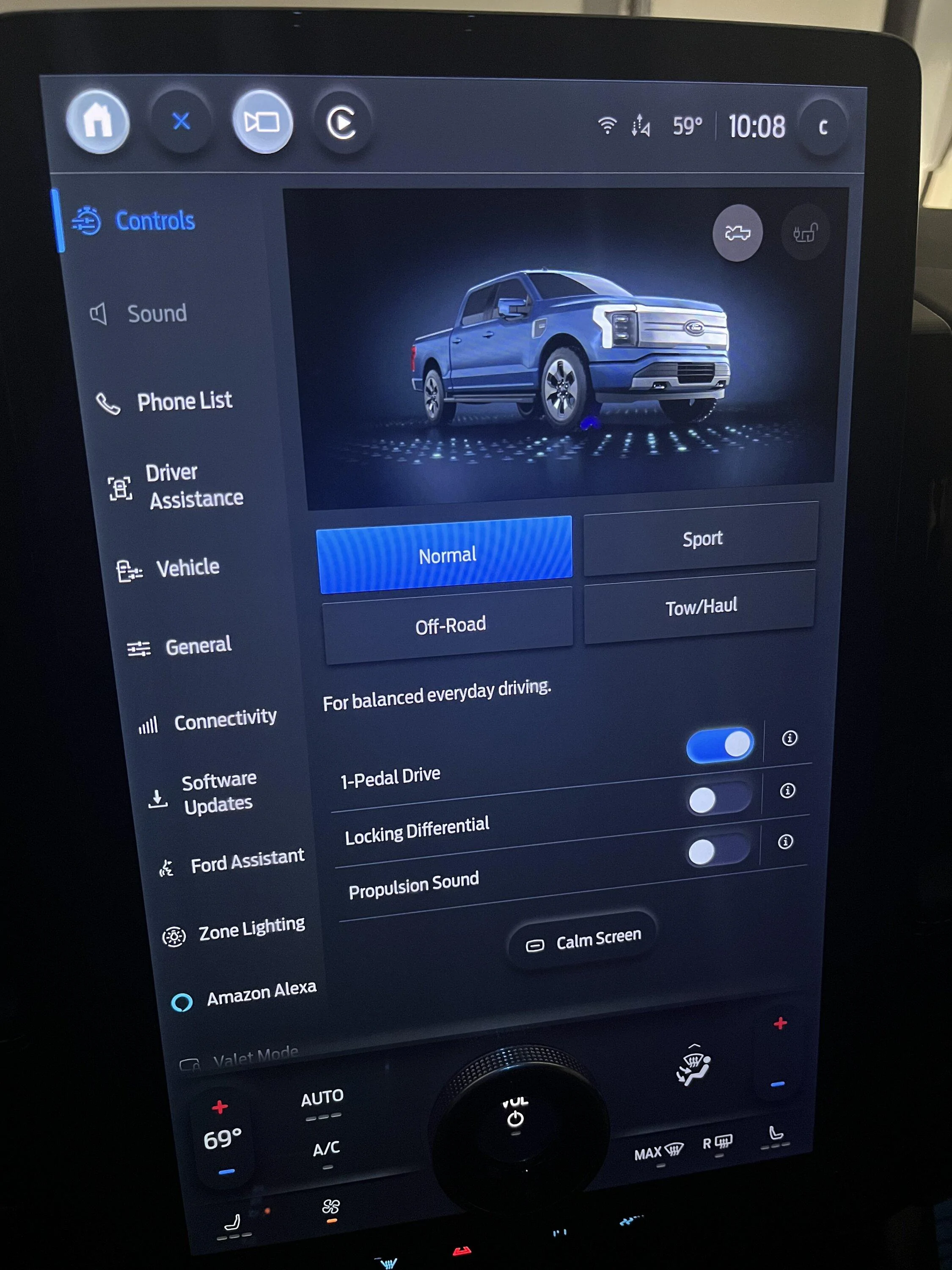

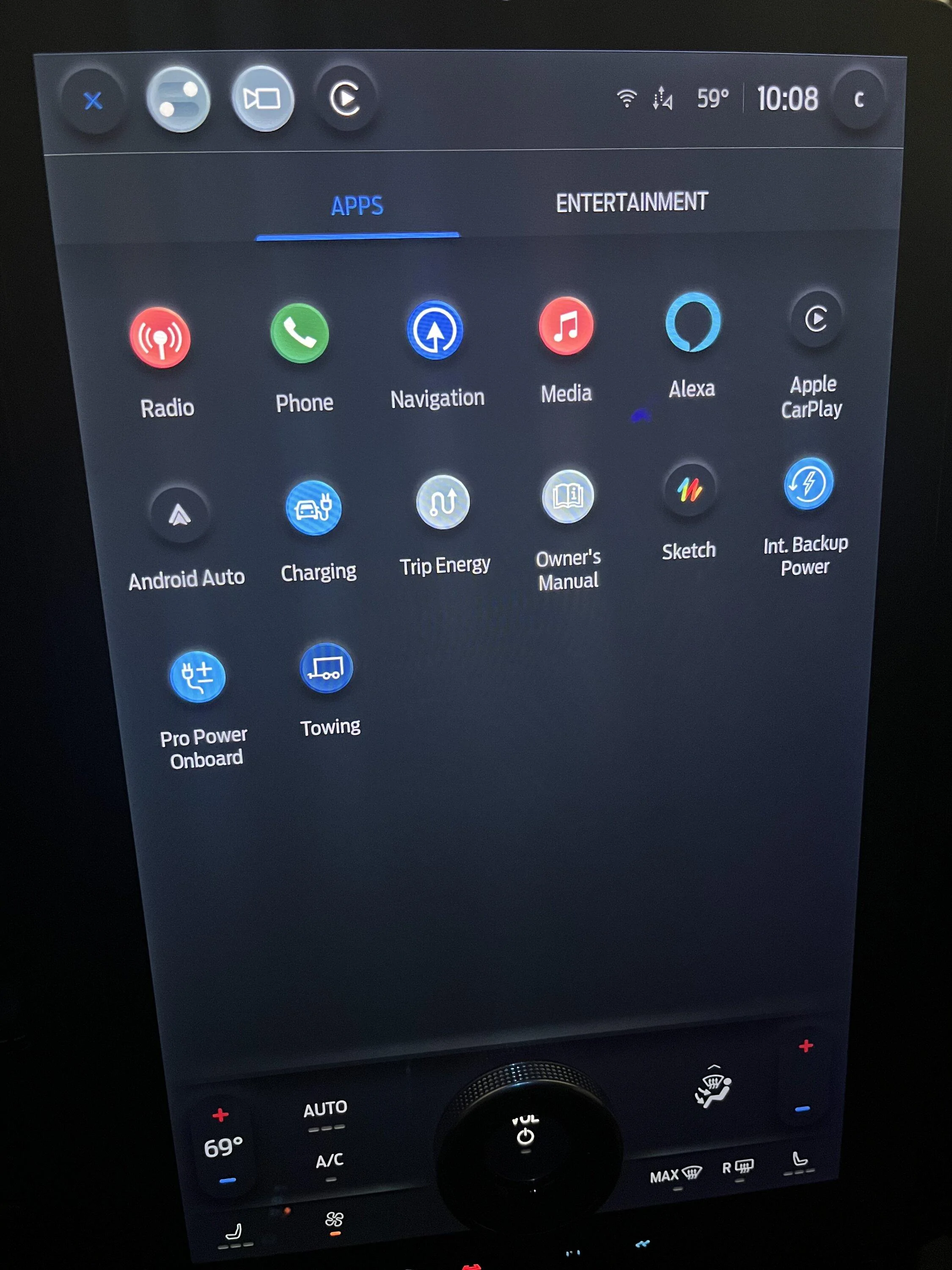

I should note that when I took it in they also installed that 4A update on mine. The new UI is definitely an improvement but unfortunately it did not solve the modem issue.
