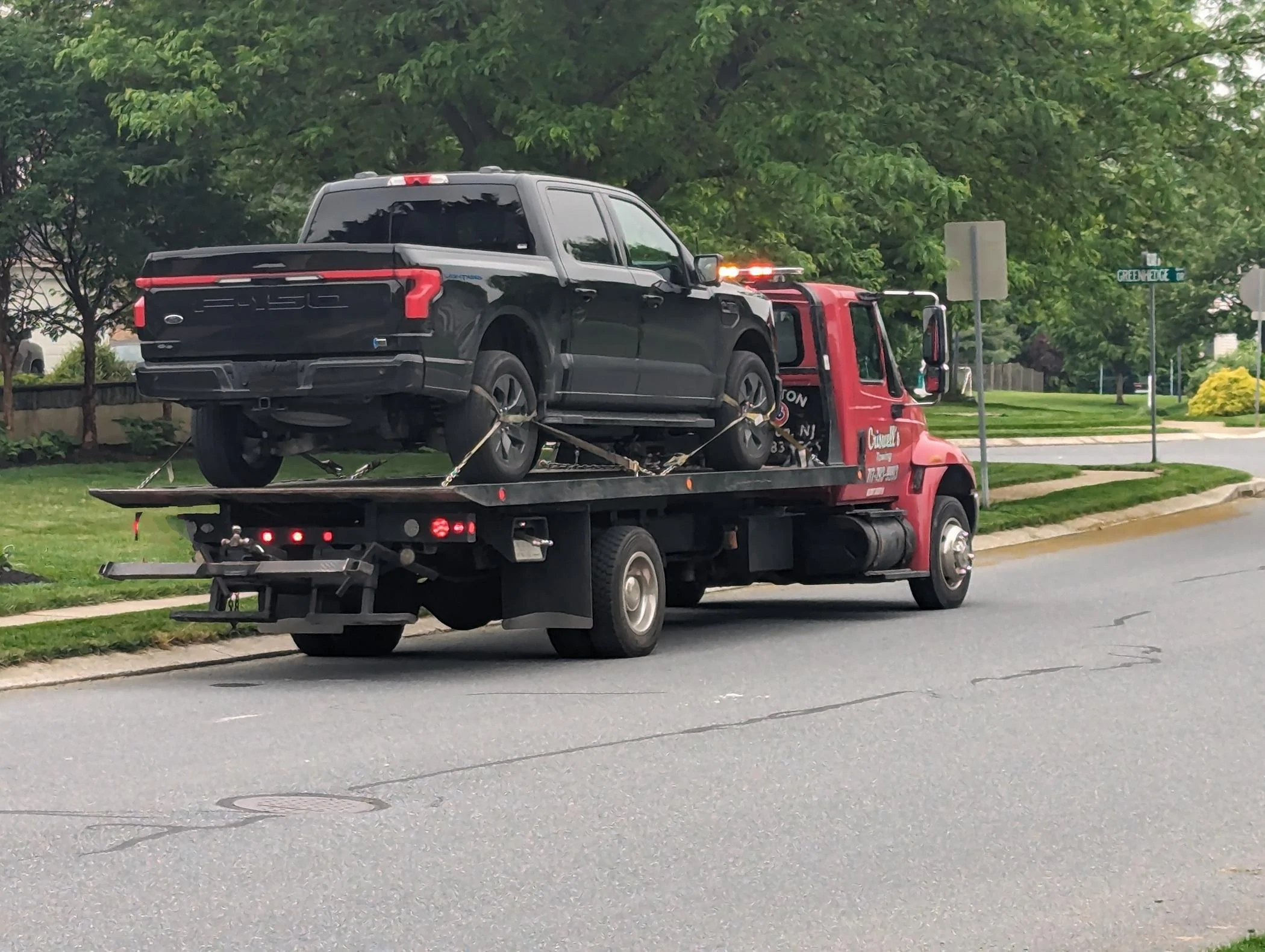

This is the second time this has happened in 2 weeks. I park the truck in my garage and when I go to drive it a few hours later I get the "Stop safely now" message and it will only enter "accessory mode". No alerts on my phone or explanation in the truck. Any help would be appreciated..
Just went through this myself. Jumping wouldn't work. Had it towed to dealer, 12v battery had to be replaced. I can't understand why if the 12v battery was bad or low, that jumping wouldn't work, but it just wouldn't.
