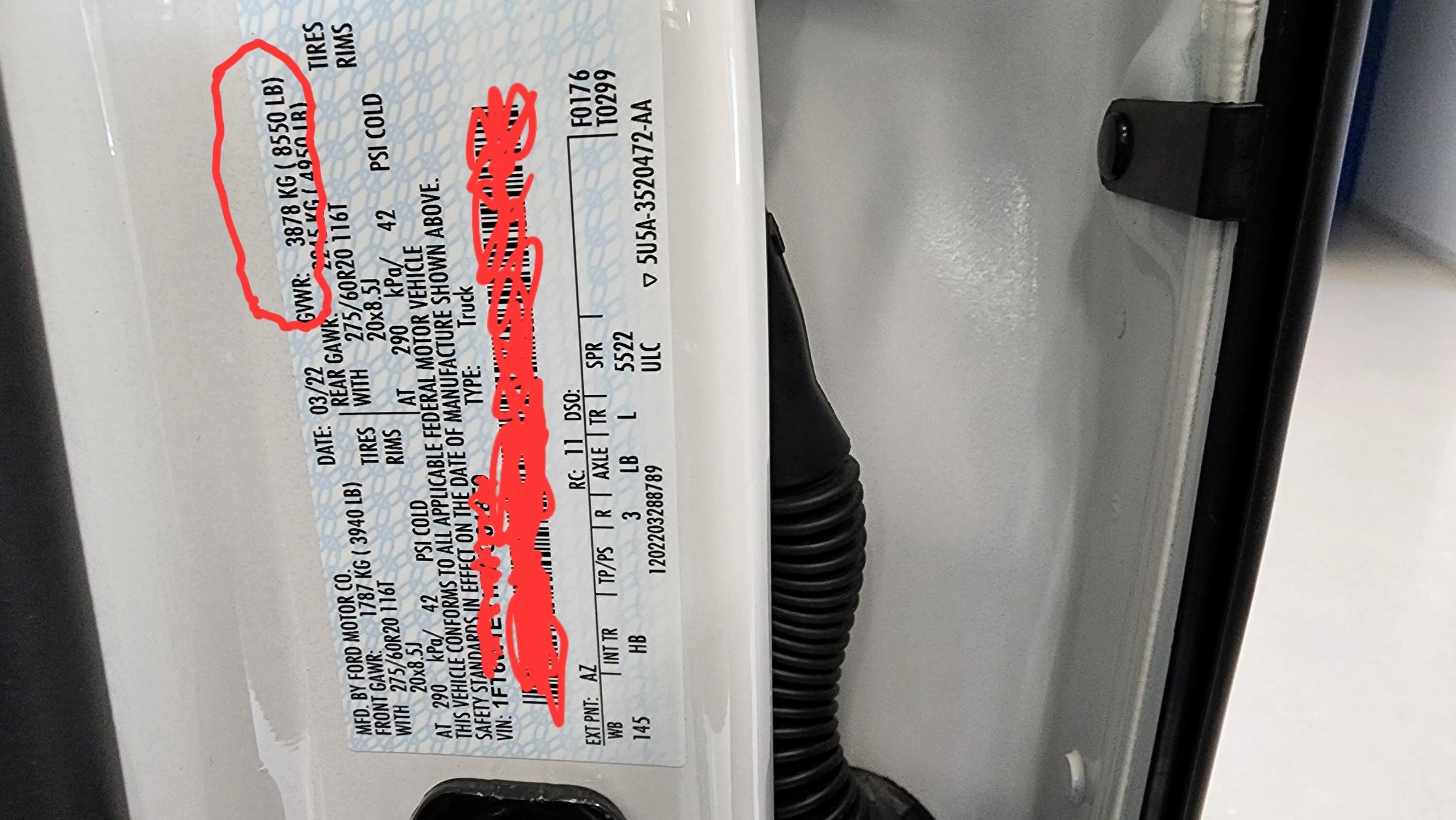

Putnam Ford has a white Lightning demo Lariet with extended battery and "All-Season" tires. The sticker inside the door shows a GVWR OF 8,550 lbs.
Ford F-150 Lightning Mass MOR-EV-TRUCKS Rebate Putnam demo
hag911
Massachusetts
2015 Fusion Hybrid, 2021 Mustang Mach e First Edit
As of May 22nd only vehicles purchased or leased in Massachusetts are eligible for the MOR-EV program. So since this one is in Connecticut it won't qualify.
