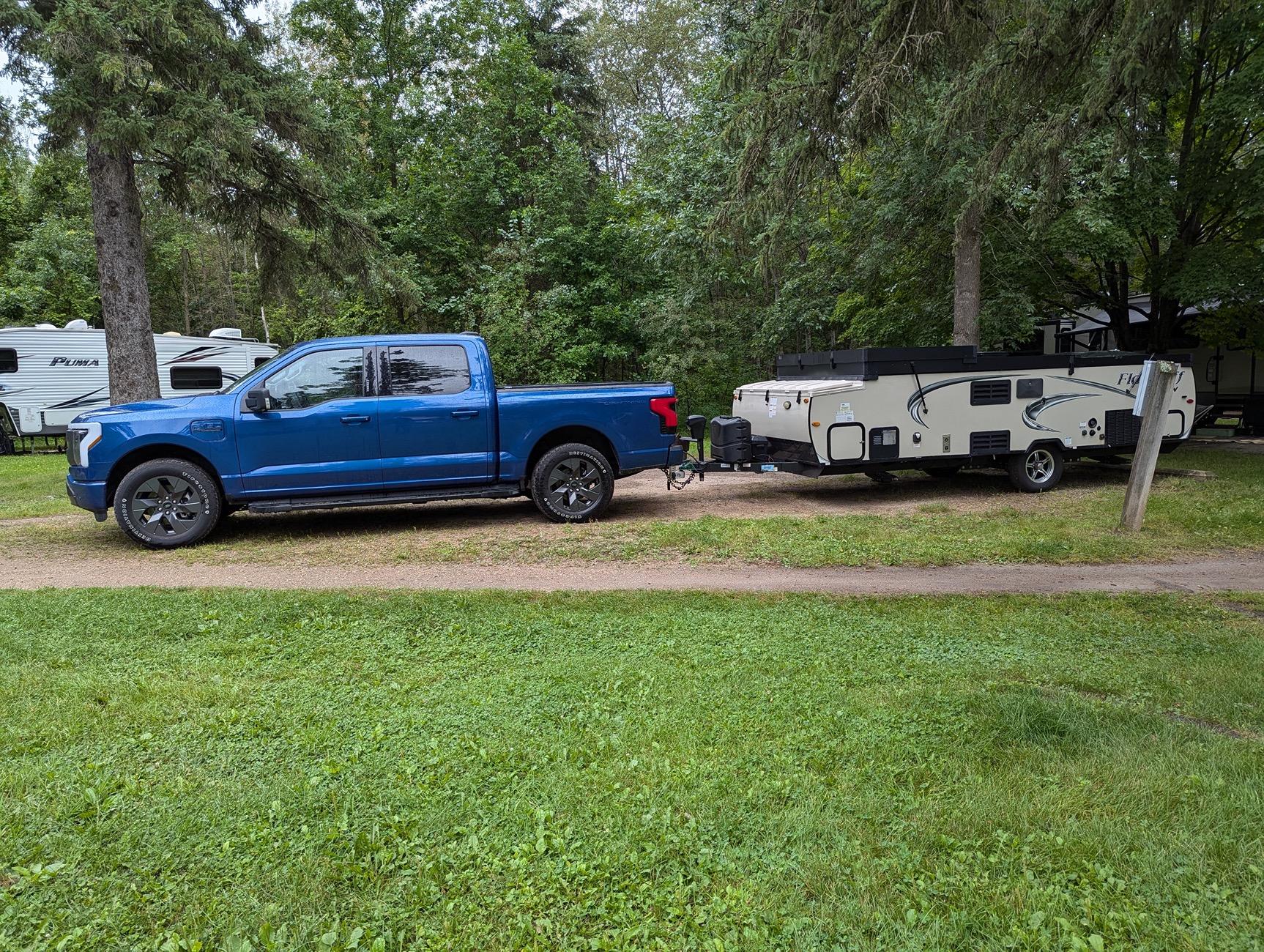

I wanted to say THANKS for sharing this. Your use is very similar to mine, and I can see the exact same thing happening to me.
I’ve pulled my camper over 7,000 miles in the 9 months I’ve had the truck, and I’ve gotten too comfortable pushing it down into the single digits. The added drag from the trailer makes efficiency much more dependent on wind conditions, so I probably shouldn’t keep thinking “it’ll be fine.” I returned last night at 6% from a 200-mile trip that needed a quick top-up at a Supercharger to make it home. I took 5% more than I did last week, and I’m glad I did.
Just for context, what size camper do you pull? I average 1.4 mi/kWh at 60-65 MPH with my Flagstaff A-frame.

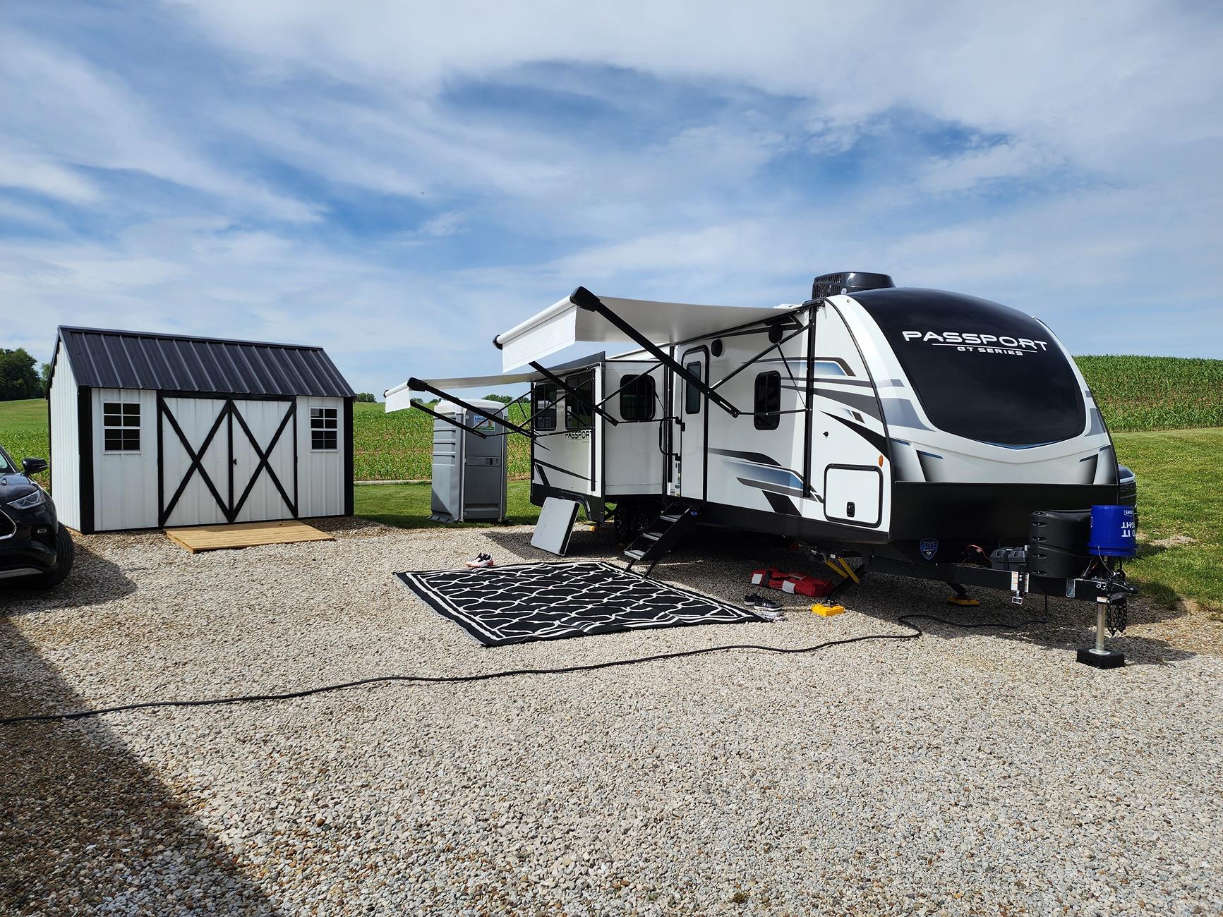

I pull a Keystone Passport GT 2870, approximately 7,500 lbs loaded (for us). I usually average .9 -1.1 m/kw but this was an unusually hot day. I'll have to keep a closer eye on the battery temps in the future.
