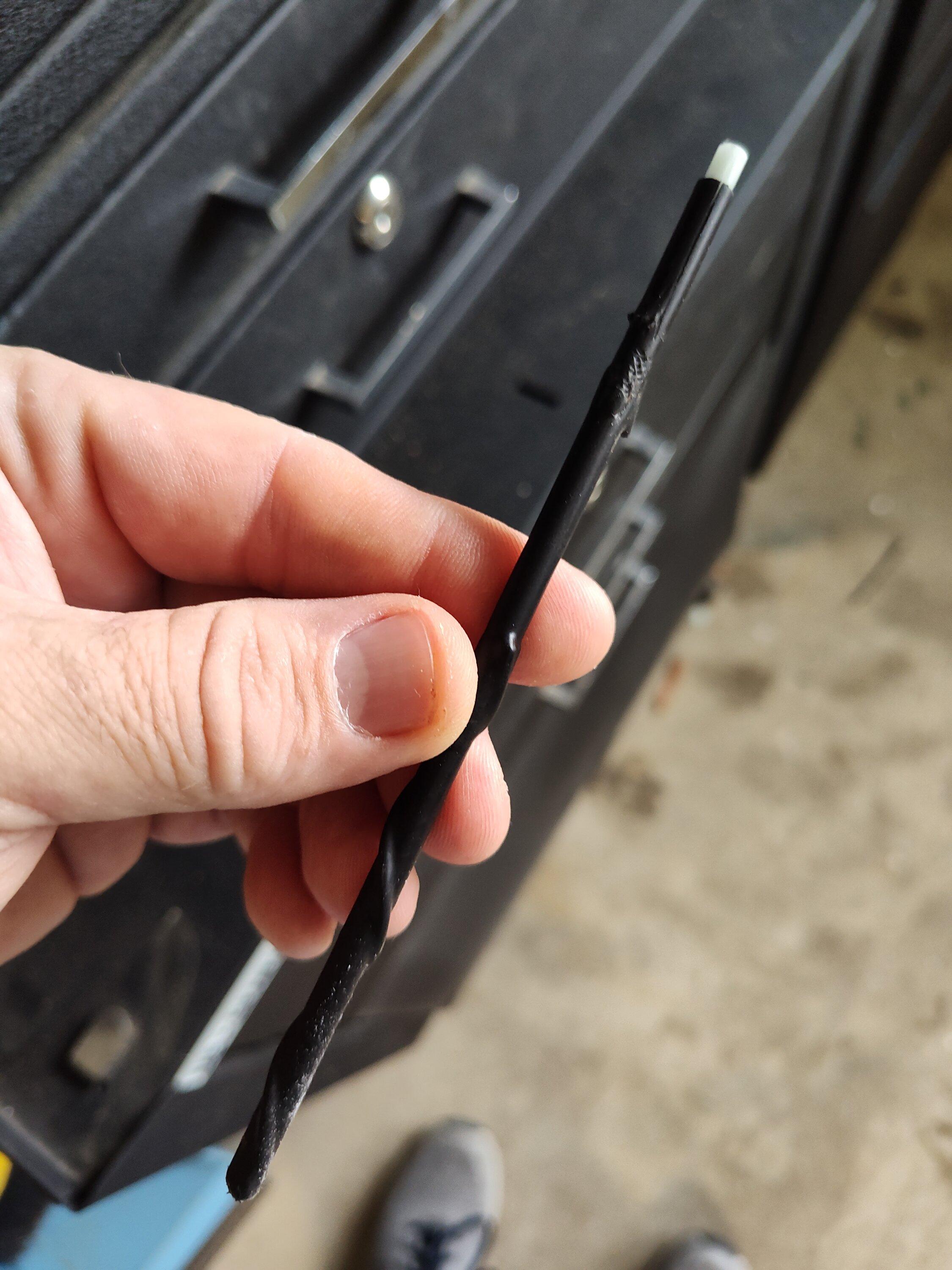

I just cut 7" off of mine so it would clear the garage door. Its made of fiberglass with a wire coiling around and a removable cap on top. Used a lighter to soften the cap and popped it off, cut to length and replaced the cap sealed with the lighter.

That's what I removed

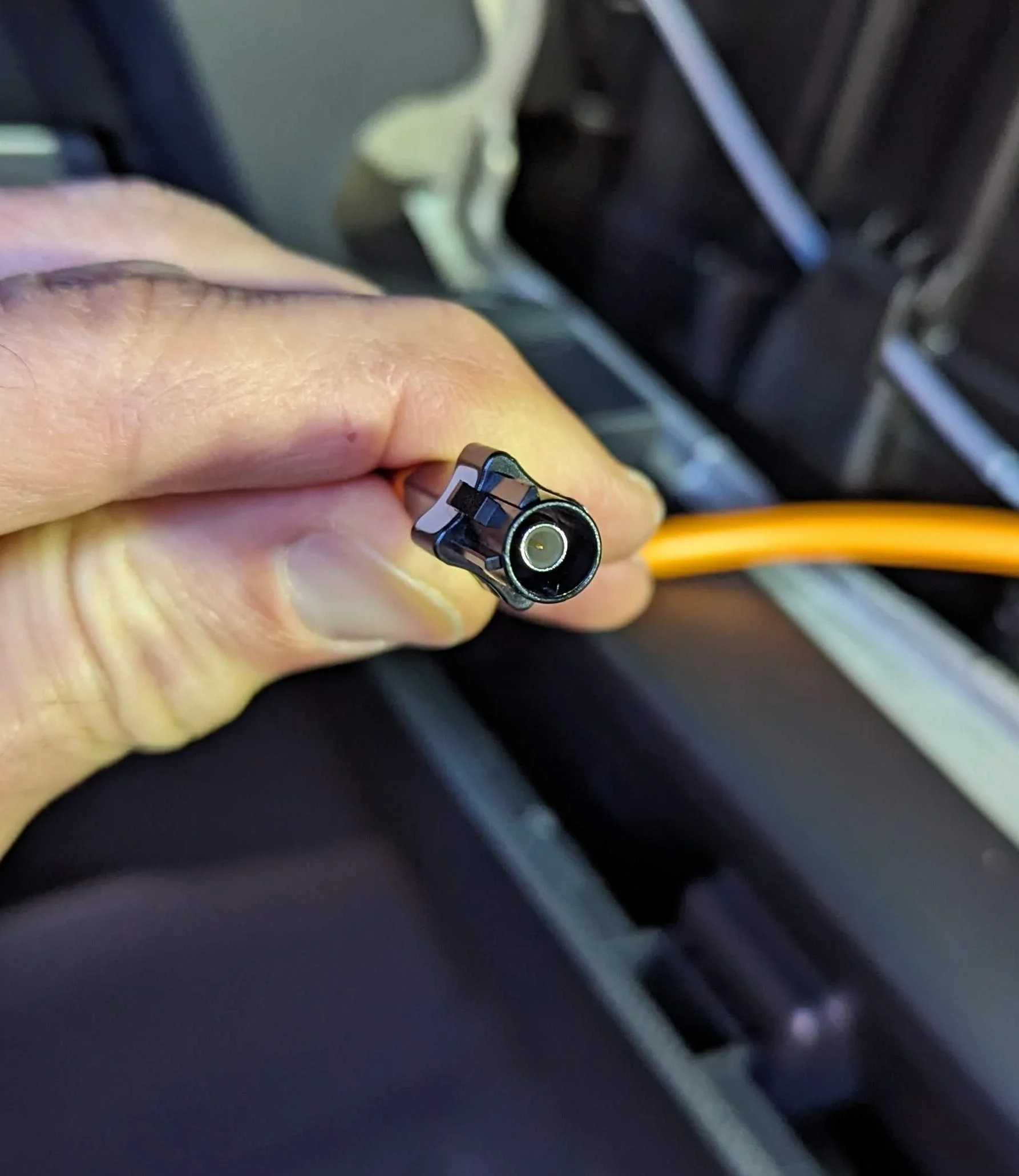

Ford F-150 Lightning Mount AM/FM radio antenna in the truck body? PXL_20231122_224504318
Anyone has an idea of the type of connector that is? Some sort of coax but quite small, the plastic housing diameter is 0.300 inches...
