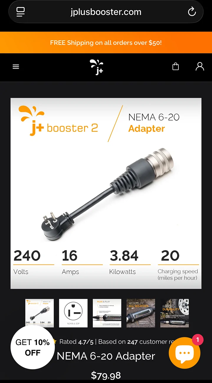

I also got the J+ booster 2 and bought the 6-20 adapter. Used it for a month or so until the power company had my wall unit installed and now it is my mobile backup charger that I keep in the truck. It's a really solid unit and was recommended by Tom from State of Charge, so that was good enough for me.

The J+ is ETL listed. It’s a solid choice.

The J+ Booster EVSE is nice, pretty expensive, portable, and supports NEMA 6-20.
Ford F-150 Lightning NEMA 6-20 (220V 20 amp) charging solution? 1764614481483-cn
