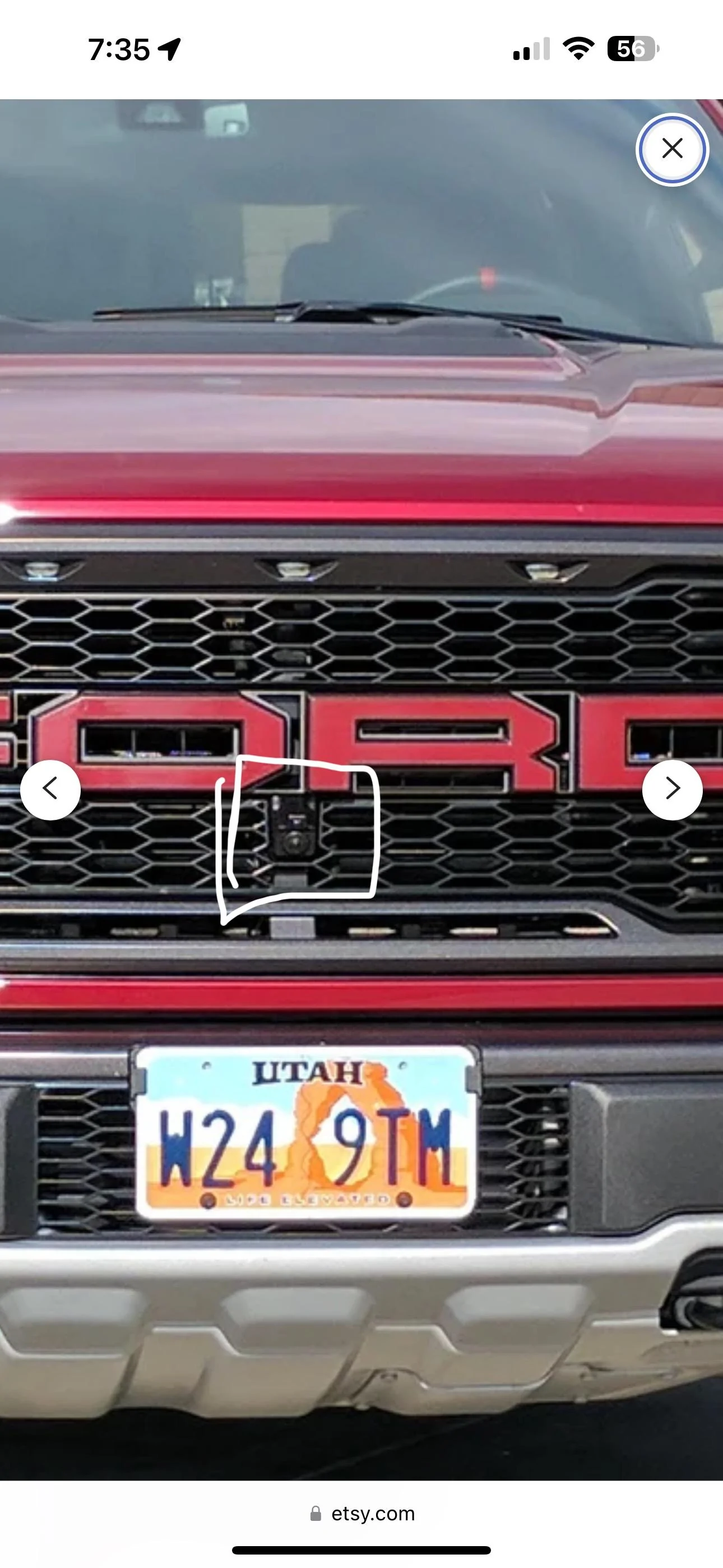

Ugh, so it does have the Raptor-style letters. The seller sent me a pic but I am hesitant to post because of trademark issues (although the seller is in China so might be hard for Ford to do anything about)... The fact that there is no front camera provision is killing me though... I would totally order this in a heartbeat if it had a cutout... Heck, I still might and get out the Dremel. :p
Ordered one. Found a hopefully elegant solution to the camera issue. Gonna take some slight modifications but sourced all the little bits and pieces from a Raptor to make it work. I can post the process once everything arrives.

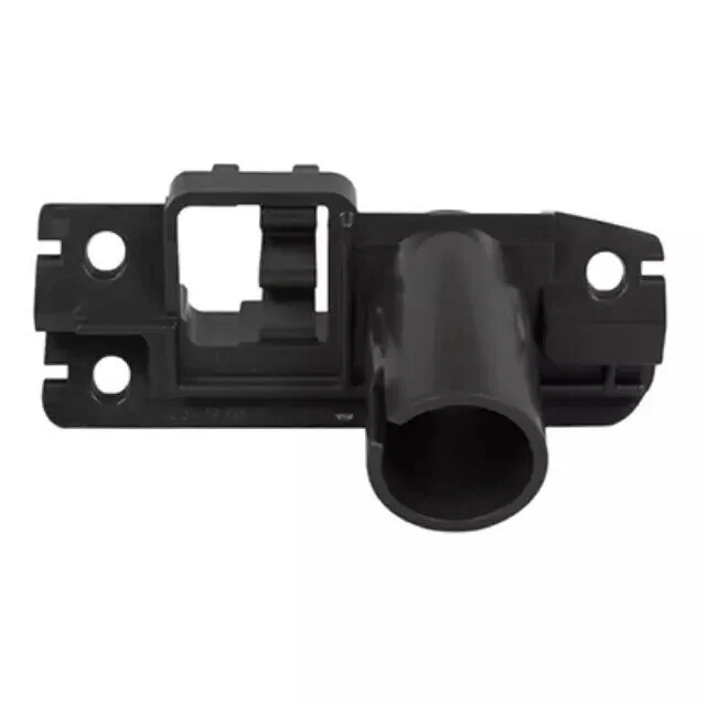

I'm interested to see what your parts list looks like. I think I can make it work with just this bracket, which I believe is already integral to the emblem... good luck!

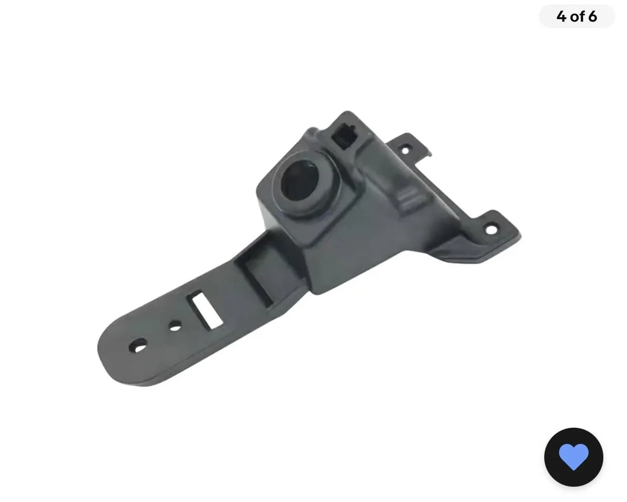

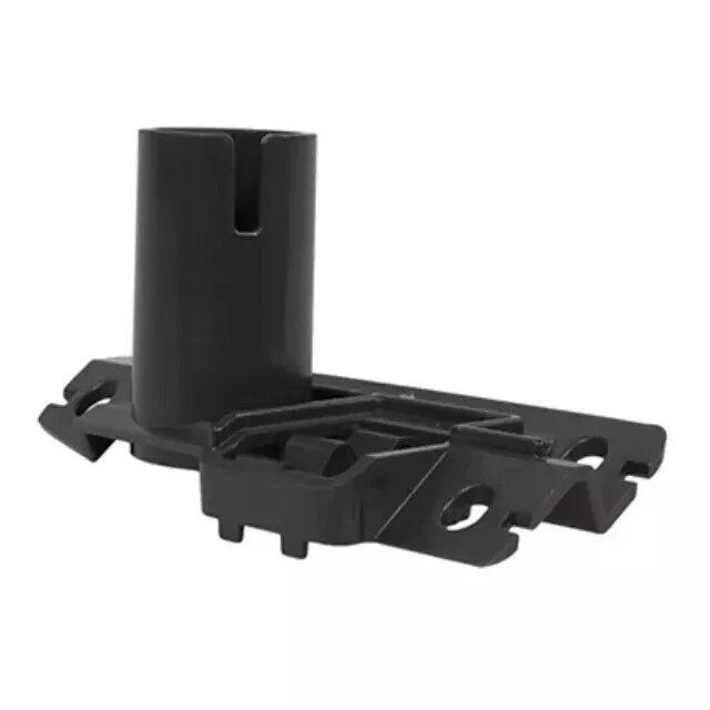

That is the exact bracket that the components are mounted to behind the emblem.
My attempt will be using the Raptor mounting system as mounting the bracket we have will be hard with the sprayer location. The Raptor has a simple housing that holds the camera with a fixed sprayer that sits directly about the camera

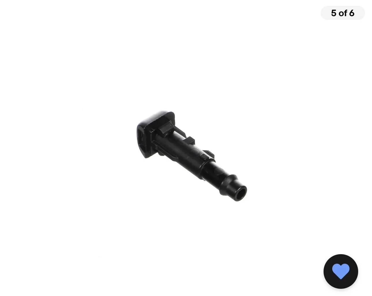

Nice solution, I will be following to see if that works better, the finish might work better than trying to integrate the popout sprayer, Do you mind sharing the part number for the sprayer head replacement so I don't have to go digging please? I did see that bracket in my search as well but hadn't considered swapping the sprayer head as well... thanks!

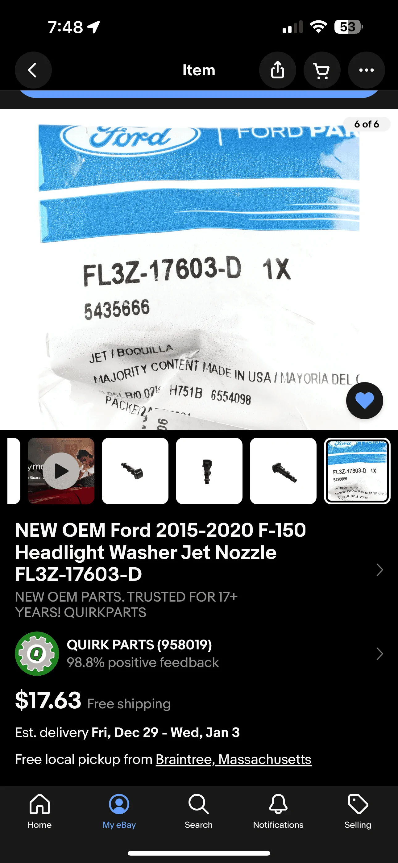

I’m 99% sure this is the exact part and will know when everything arrives but it took a lot more work than I thought to track these darn Things. One thing I do know will be an issue is that our camera uses a 90* plug and this bracket is made for a 45* plug so some Dremel work will be required but should be pretty simple
