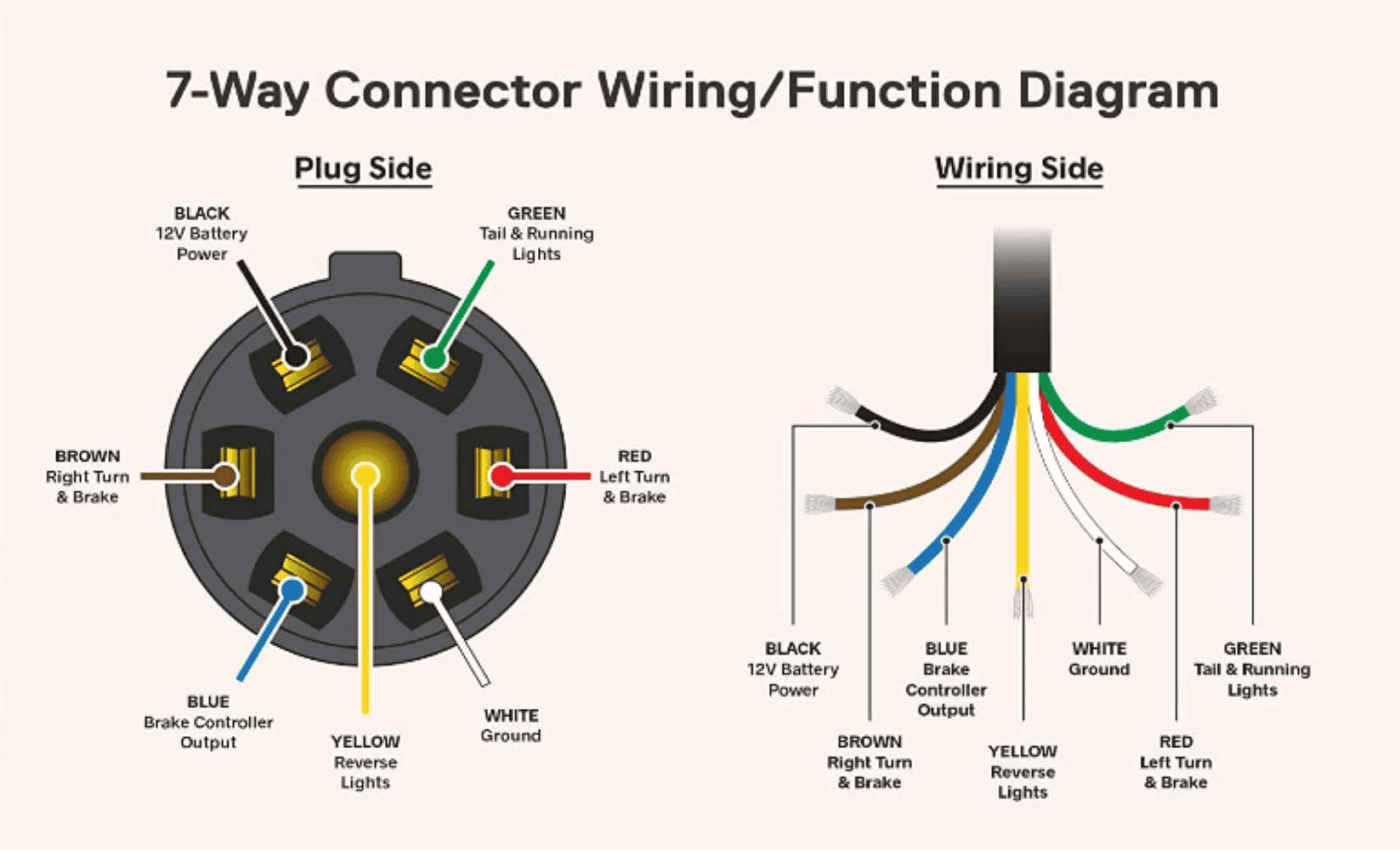

No sorry it's not a turn signal. It's reverse only or you can get it with a brake option
I know, that's what I'm asking about. What I'm trying to ask is, if you put a turn signal on, does the DD light:
A) Do nothing because somehow it's only getting a brake signal?
B) Blink with one of the signals since it's tied to one of the two brake lights?

No it doesn't do anything, these are not turn signals. It's a reverse kit (with an optional brake function). It has nothing to do with the turn signals actually. Sorry for the confusion.

OK good. But I'm curious how they've managed to do that? There is no brake-only in the trailer light harness. And splicing into the left or right tail light is the same issue I think since brake and turn signals are combined.
Sure there is. 7-pin trailers have reverse, brake, left turn, right turn.

Sure there is. 7-pin trailers have reverse, brake, left turn, right turn, running
That brake pin is for the trailer brake controller's output. The voltage will vary from 0-12 volts with the trailer brake controller's desired braking force. But I guess if DD is using a voltage boost converter or something to make use of less-than-12v, it would work as desired. Creative.
