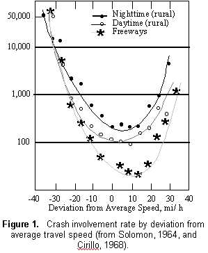

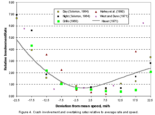

To theorize that the safest speed is the speed everyone else is driving because otherwise, you'll cause an accident is just plain silly. There are many other factors that go into determining safe driving speeds regardless of what the herd behavior is. If curves are built for 65 mph, driving them at 75 mph on slick roads because everyone else is doing it makes it magically safe(r)?!
It does. But it only sounds magical because you may not have worked with the herd before. Herd mentality is way underrated. The posted speed limits, the road conditions, the capability of each individual and each car, ……. all of those factors has an impact on the herd behavior. There is a reason herd mentality has ensured survival of many species for thousands of years. Don’t knock it down until you have tried it ;).
Human Factor Engineering goes hand in hand with designing for safety. If you see folks consistently drive 10 mph over speed limit, you factor that in, in your design. It is always a back and forth between how the herd respond to a design and adjust accordingly.
Don’t forget, you are a part of the herd so on a one lane road with a posted speed limit of 40 mph, if everyone else wants to go 50 and you decide it is not safe and go 40, the herd will end up doing 40. Of course that may cause some folks lose their mind and engage in dangerous passing that increase the chance of fatality all because you tried to stay “safe” but that is an entirely different can of worms. What I am saying is any system that involves a lot of humans making decisions, is a complex system and you can’t reduce it to a speed limit sign.
I am not going to beat this to death. I do agree with you that we should just let natural selection do it’s thing but here are a few pieces of information from Federal Highway Administration indicating, they don’t think it is that silly:
Your particular citation doesn't mean a whole bunch without providing information, such as how much the average speed differed from the posted speed. There are also no error bars on the data on the graphs. If the average speed deviated little from the posted speech, the "data" you post would essentially show that it's safest to drive the posted speed. The first graph is data from 55 years ago, three generations previous to the current. Many of the drivers who provided that data are probably deceased or at least not driving very much today.
