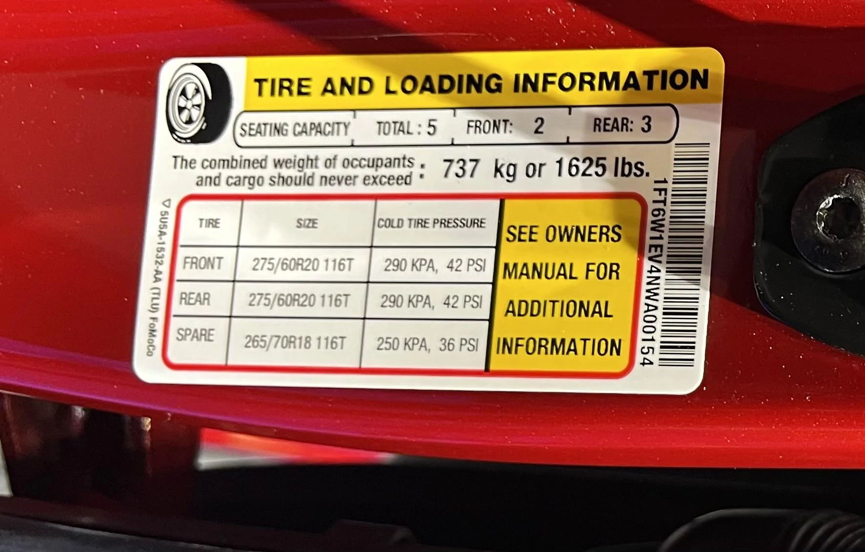

I just took this picture at the NY Auto Show. Lariat ER.
I think that's the same as the one in the video in the post above. I wonder what explains the 1425 to 1625 lb discrepancy since they're both Lariat ERs? Maybe it's a preproduction thing.

Good call, I paused the video and it is definitely the same VIN number. I can’t think of any options on a Lariat ER that would explain a 200lb difference in payload, maybe the Max Tow Package. The vehicle at the show had the spray in bedliner.

The Lariat Lightning in the video with a 1625 pound payload has a GVWR sticker with 8550 pounds.
The other Lariat Lightning ER has a GVWR of 8400 pounds and a payload of 1452 pounds.
I'm not sure what triggers the difference in GVWR. I thought only the Platinum had the highest GVWR but this pre-production Lariat also has the higher GVWR. Perhaps Max Tow adds some GVWR capacity?
