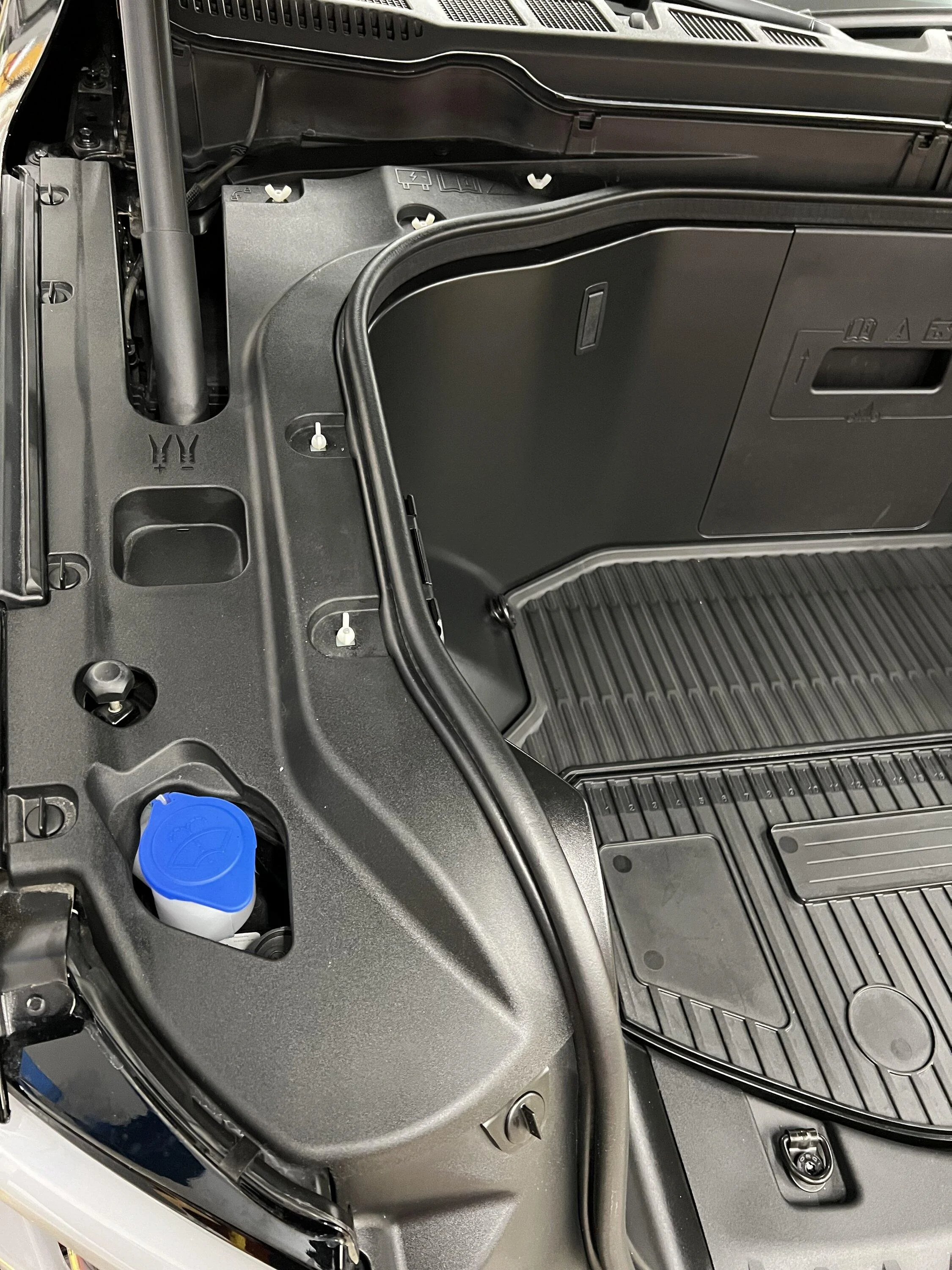

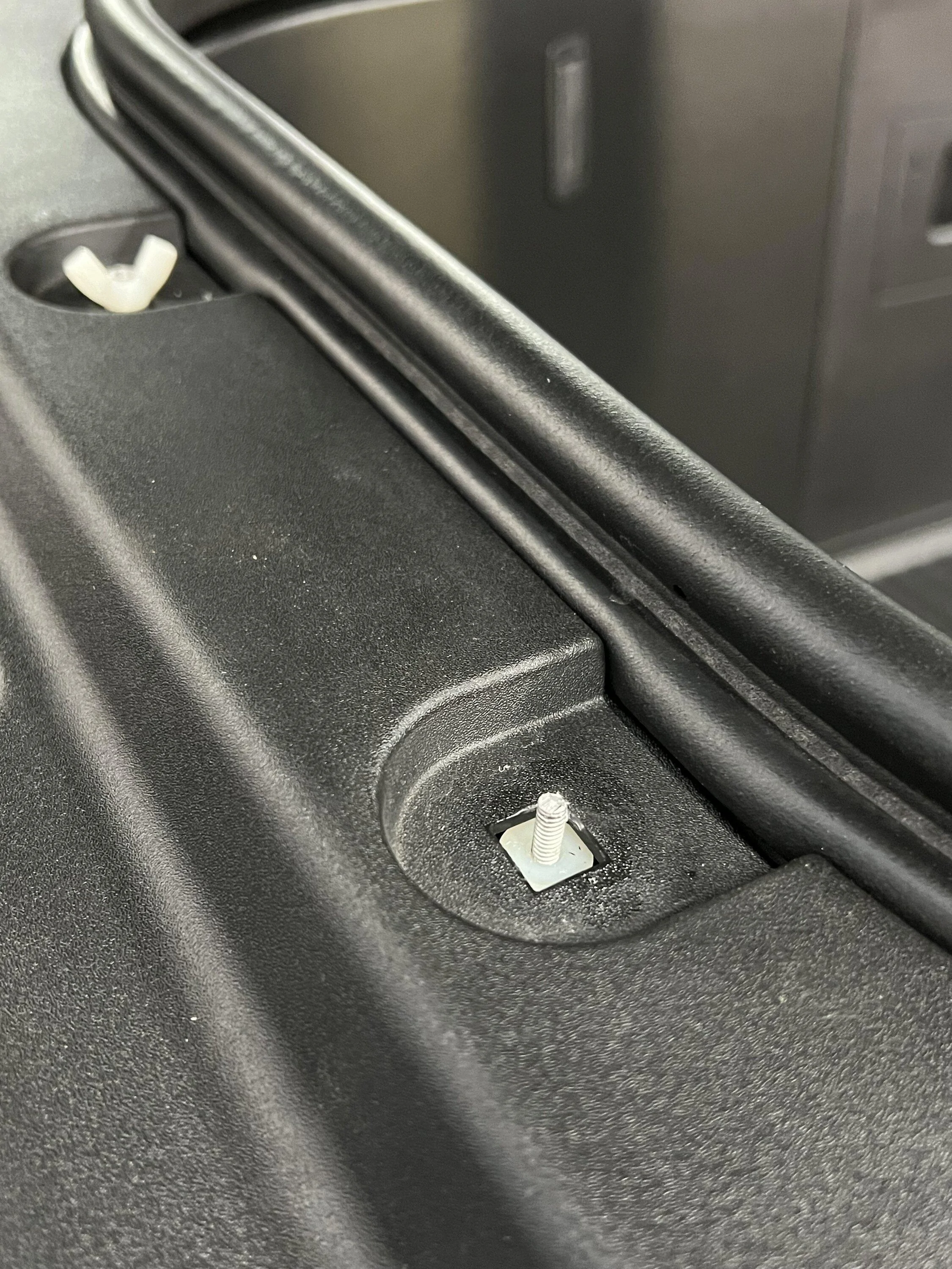

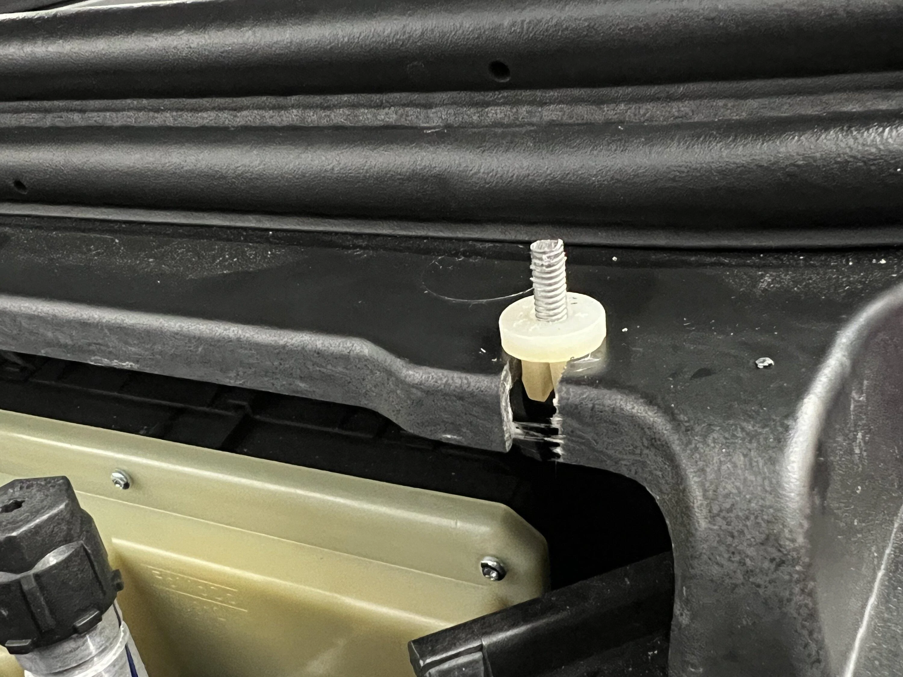

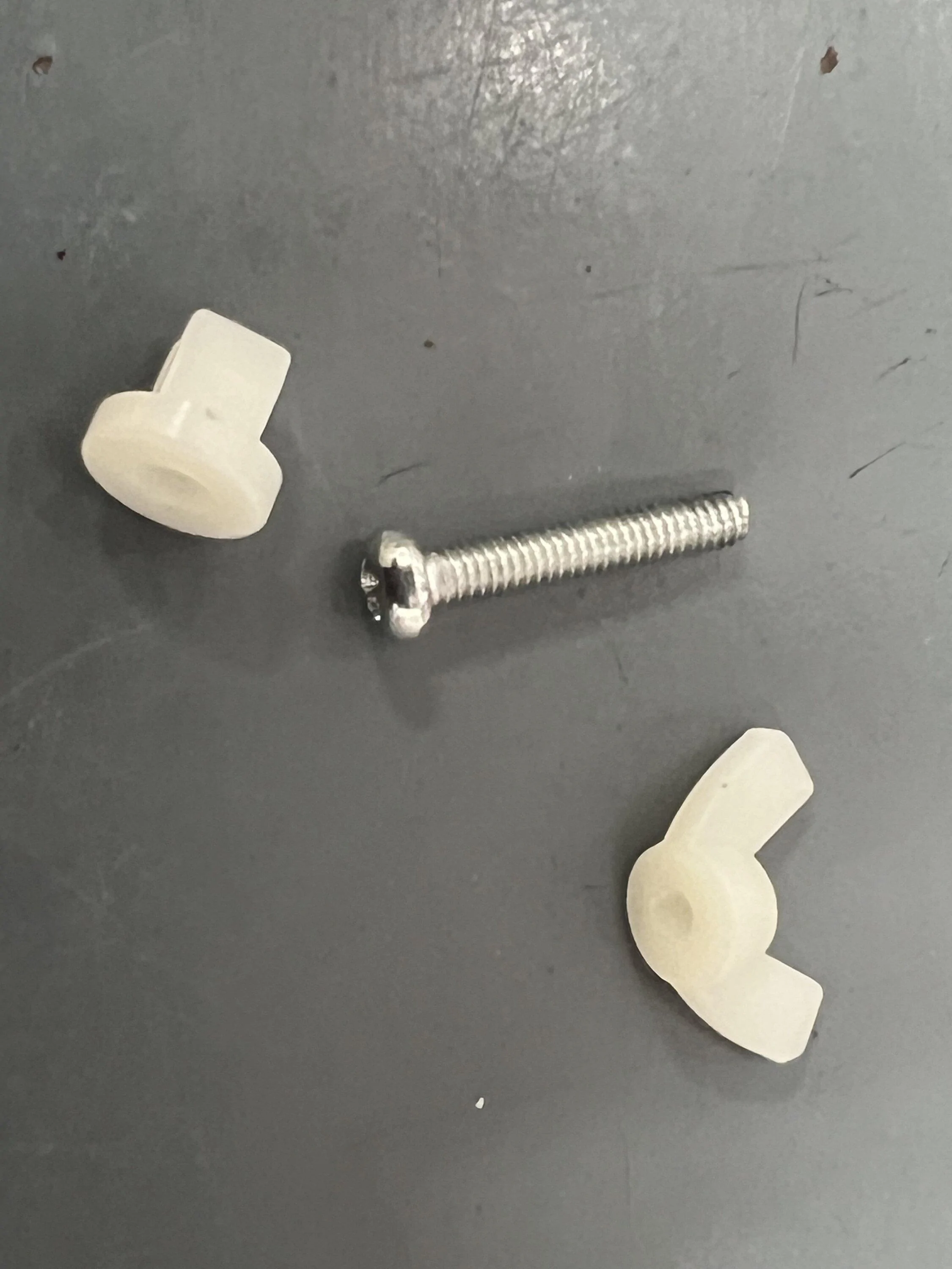

I purchased the nylon wing nuts and press-in anchors at ACE Hardware. I installed the anchors into the slots where the original fasteners were and took #8-32 screws and cut the heads off of them and screwed the threaded rod into the anchors. Then installed the trim panels and secured with the wing nuts. I didn't replace the original fasteners in the front of the panel because they work ok. Must be they are inserted into a different size square hole. Black wing nuts would look better but I couldn't find any easily.
Awsome!! Thanks for the details. Great solution!

The metal screws really clash with the white plastic. Definitely needs a custom paint job.

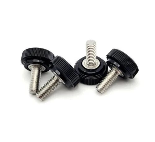

I know, not the prettiest looking mod. Now I'm thinking about purchasing these thumb nuts. They would look much better. However, I'm worried about hood clearance. I won't know until I purchase them and try them.
Great idea! The nylon nut inserts look like the ones that were used in bumpers for license plate attachment.
