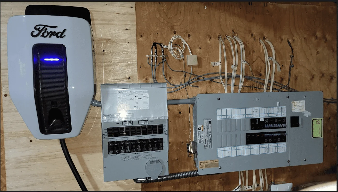

I have my truck setup to use my installed 10 circuit 240 volt transfer switches. All works perfectly. I just wish Ford would do an OTA update that would allow the pro power to run with the truck turned off. AKA camping mode.
Here is my “Unintelligent” backup power installation
I just went simple if power goes out I plug in the truck. Low cost setup.
Ford F-150 Lightning Power out. All good. No noise! Pro Power Onboard to the rescue 1665856187741-png-png-png-png
Works no problem with the trucks GFI This setup cost me about $1,100.00. I just need to plug truck in and turn it on Pro power. ;) This transfer switch has 10 ciruits that are separate in that I can pick and choose which ciruit I want to run off the truck. 1 240 volt 30amp for the air conditioner(only if needed), 1 120 volt bridgred for kitchen plugs the rest for fridges, sump pump, internet modem WiFi, some computers, and bedroom TV +.
FYI I turn down the Ford Pro charge station to setting #5=48 amps. wired direct to panel with 60amp breaker.

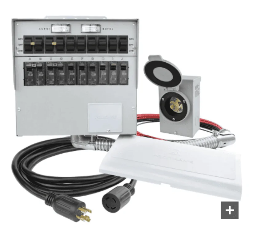

Reliance Controls 30 Amp 7500W 10-Circuit Indoor Transfer Switch Kit
Model # 310CRK|Store SKU # 1001061741 Canadian Home Depot US unit maybe different.
I took the generator connector plug out of the remote outside box, and installed it in the optional position in the transfer switch panel. Since the Lightning has no gas fumes I kept the system all in the garage. The reason it works with the truck's GFI is the ground from the truck is not connected to the transfer panel. Some people have technical issues with that. But if there is a grounding issue the house GFI will detect it and shut of power.
