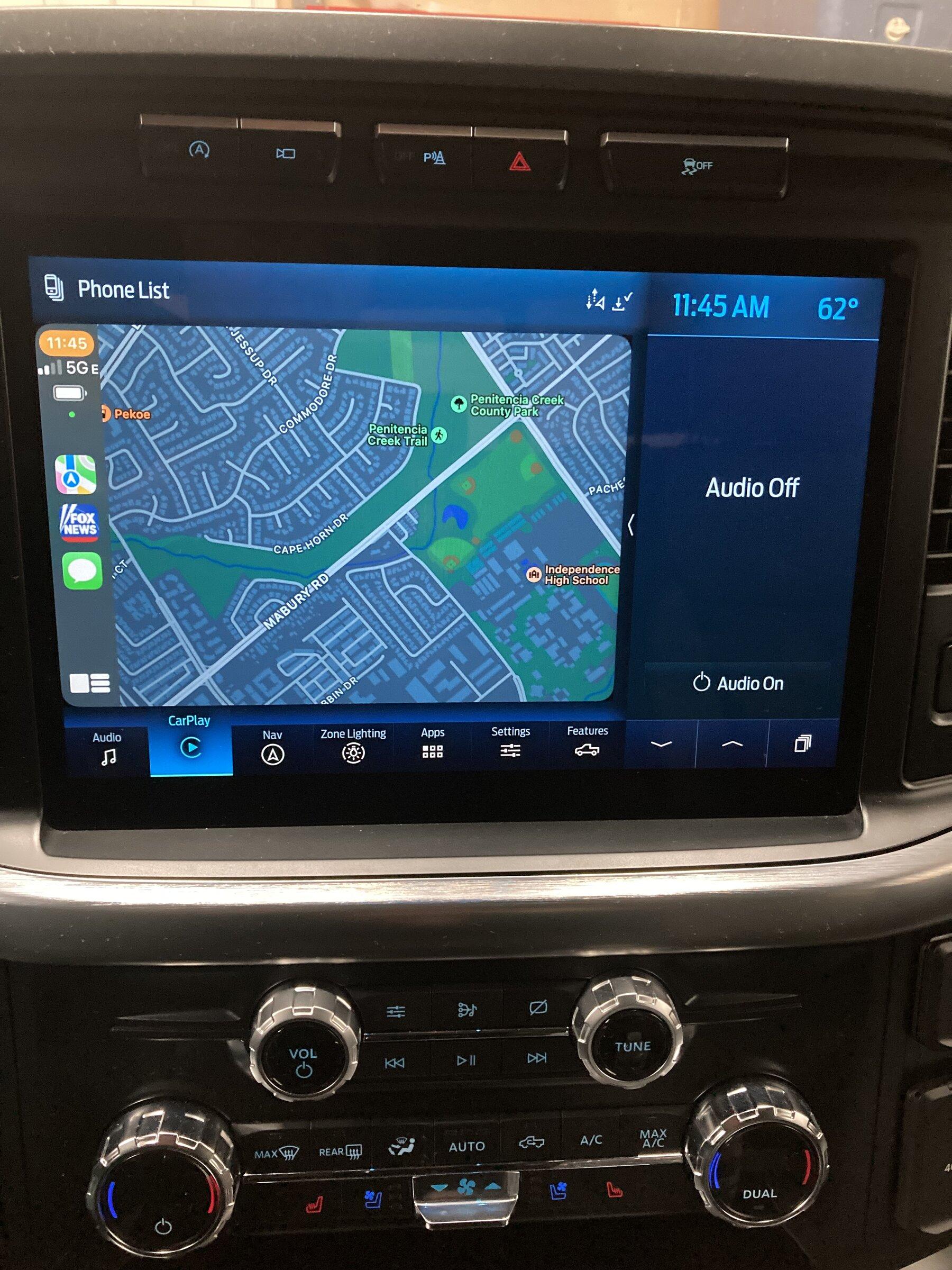

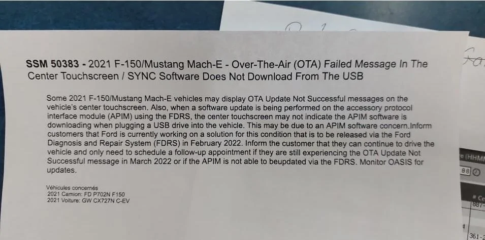

Service manager and I have been trying to resolve this with the engineers. I suspect it will stay ghosted out till its done loading and installing. Otherwise the apim is stuck.
Reason I say about the downloading vs ghosted is I just did my wife's '19 Stang but with that, you use a flash drive to update maps and such. While it was installing, those same screens were ghosted out. All came back once the screen reported all installed, etc...

Got this from the ford early access as I asked what was going on because I can’t turn on auto updates anymore etc. same issue a ton of people are having. For the failed or stuck 1.7.1 OTA update. I emailed back and asked if this will be a OTA update. I haven’t heard back yet on that part.
We are working to resolve the issues you have identified. You can go the dealer but the only solution they can offer at the moment would be to replace your module. We are working on a software fix so that your module does not need to be replaced. The software calibration you mentioned is unrelated to the issues you have noted post the software update. Please stay patient with us as we continue to work towards a resolution to this issue. You can look forward to a communication from our team very soon on next steps.
