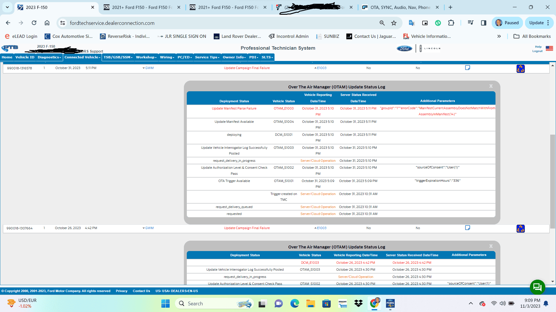

I responded to your message, but for the sake of the info being out there, I'll respond here, too, but with your VIN kept private.
It is not clear why it failed the first time, but the second time it failed due to a manifest mismatch. This means the files being sent to your truck do not match with the update files it is supposed to get, so the truck rejected the update. There is nothing you did wrong and there is nothing you could have done differently. The problem on Ford's side. Eventually, you'll get the right packet sent to you.
Ford F-150 Lightning Power-Up OTA 6.2.0 -  Small Adjustments 1699060213485
Thanks.. replied to the PM but really appreciate knowing why it failed... now I have to put on my patience hat...

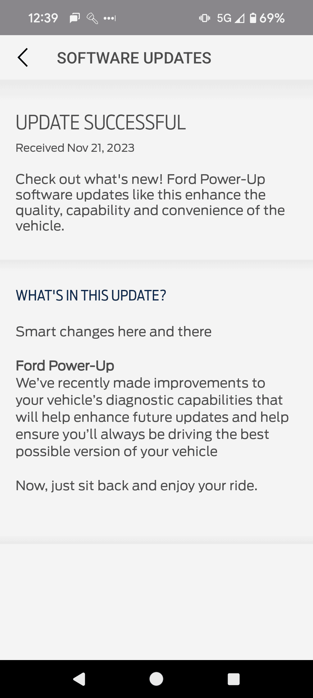

This same update was reported by three different 2021 Mach E's earlier today. It's a GWM update, but it is unclear what the purpose of the update is.
3,773
4,854
Got it this morning too. Same lame description and no PU number in the notification or in the truck.
Edit - For reference and tracking as this and or other updates start to flow again, I had received 6.1, 6.2 and 6.3 all on a '22 Lariat ER with Max Tow.
It will be interesting to note who gets this and when. Maybe everyone before the other updates start rolling again?
