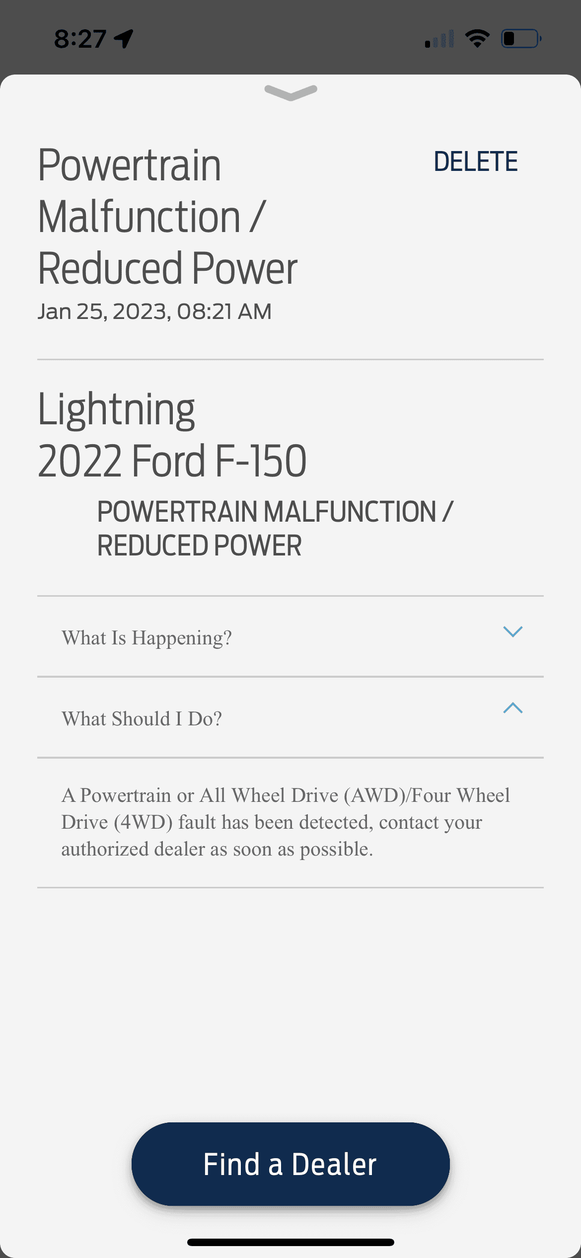

So my car has been at the dealer all day and I got a call that the car is ready. they said they ran some key software updates and that the car runs fine now. Hard to trust that this was the issue. Maybe there is some sort of sensor that is super sensitive that caused the car to go into crawl mode at 4% power. Picking car up tomorrow. Had a loaner for the day.

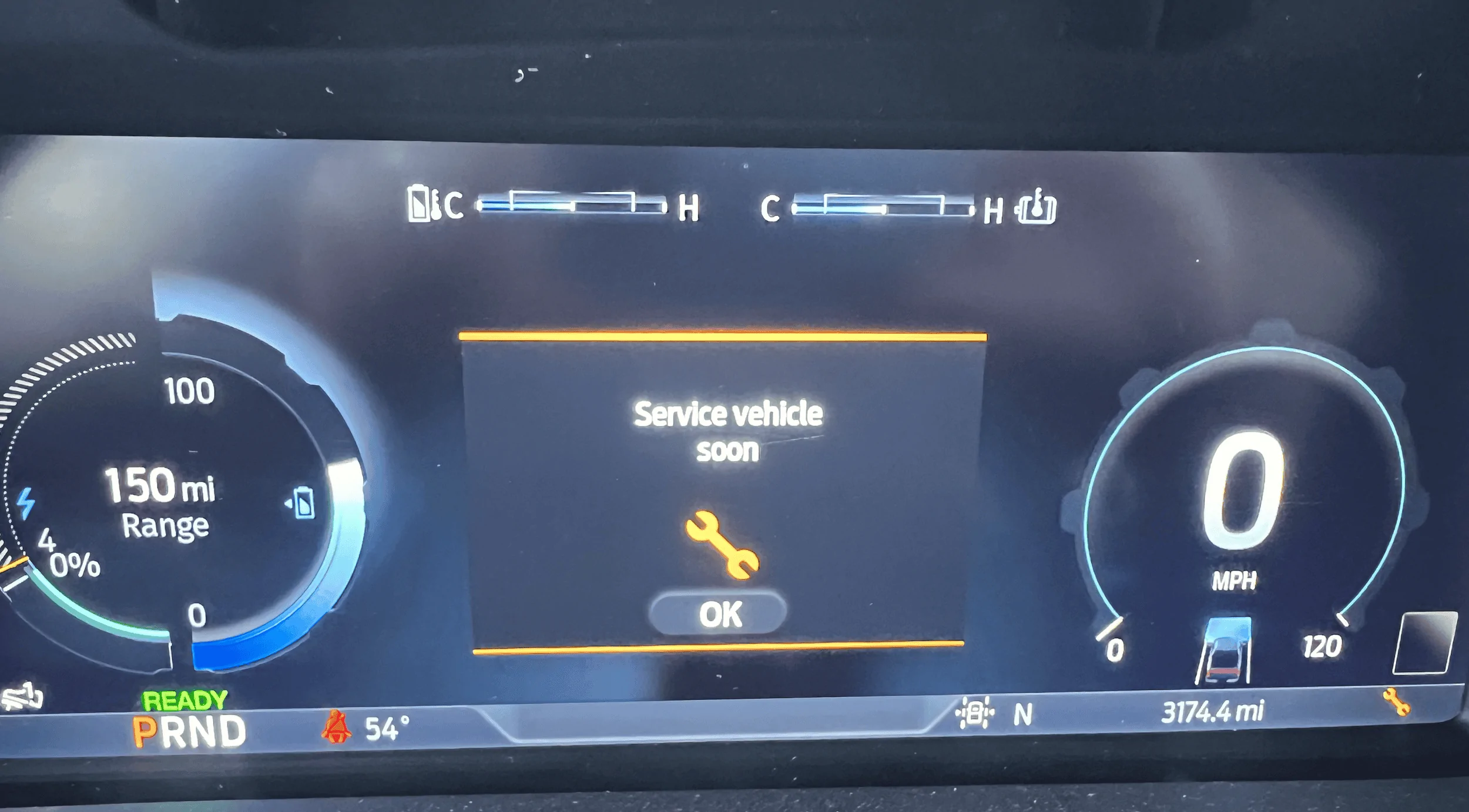

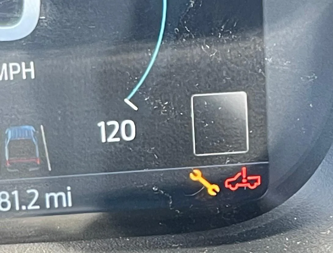

My dealer told me that too, but the warning light came back on a few days later :(. Hoping you don't see that warning again...

So. I now have the car back. Tech said that certain modules were not communicating with others and the software update fixed those issues. Then just now I got a call back from Ford dealer saying be careful driving the car and that Ford Corporate called them and said that code that was sent out means there is a bad battery cell and that it will go back into crawl mode again. Waiting on part and advised to not drive it far and stay local.

Not yet, but the warning light has been off now for a few days and no service message pops up. I'm still going to have them look into this when I bring my truck in to have my second key programmed, likely next week.

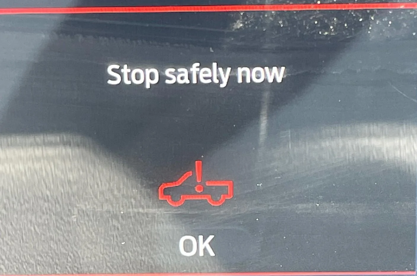

Well after having the car back for the weekend. The Powertrain malfunction light and reduced power to 4% is back. Also got a high voltage battery warning this time. Crawled back to the dealer at around 8 mph and they did diagnostics on the battery today and confirmed it is a bad battery cell. They ordered a battery array to fix the problem but it's on backorder and they have no idea when they will get the part in. I do have a loaner (crappy ford edge) but I also informed the dealer that the clock is ticking. They have had my car for a total of 6 days since I bought it in mid September and on day 30 of them having the car, it is considered a lemon. Dealer said they are very aware of that and so is Ford. Now it's just a waiting game. I truly don't know if I will trust the truck again even if it is fixed at this point. Such sad news for what until last week was an amazing truck.
