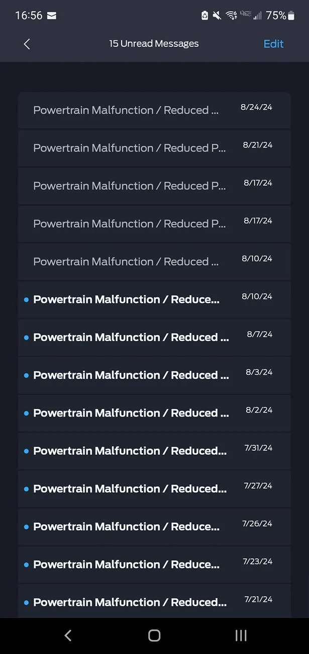

So just a follow up. After my truck sitting at the dealership for days for this error initially, I began getting the same warning daily and will no longer go away. Dealership says being it back in and expect it to be here for multiple days.
I cannot afford to use additional PTO at work due this issue that no one really wants to take responsibility for. The dealership is not offering a loaner and Ford is doing nothing to help. It's so frustrating this is happening 3 months after purchase and their solution is..."sir, please disregard this error" while my truck sits on the lot and I'm unable to have reliable transportation.
I don't know how these trucks got rated anything other than poor. Very frustrating!
