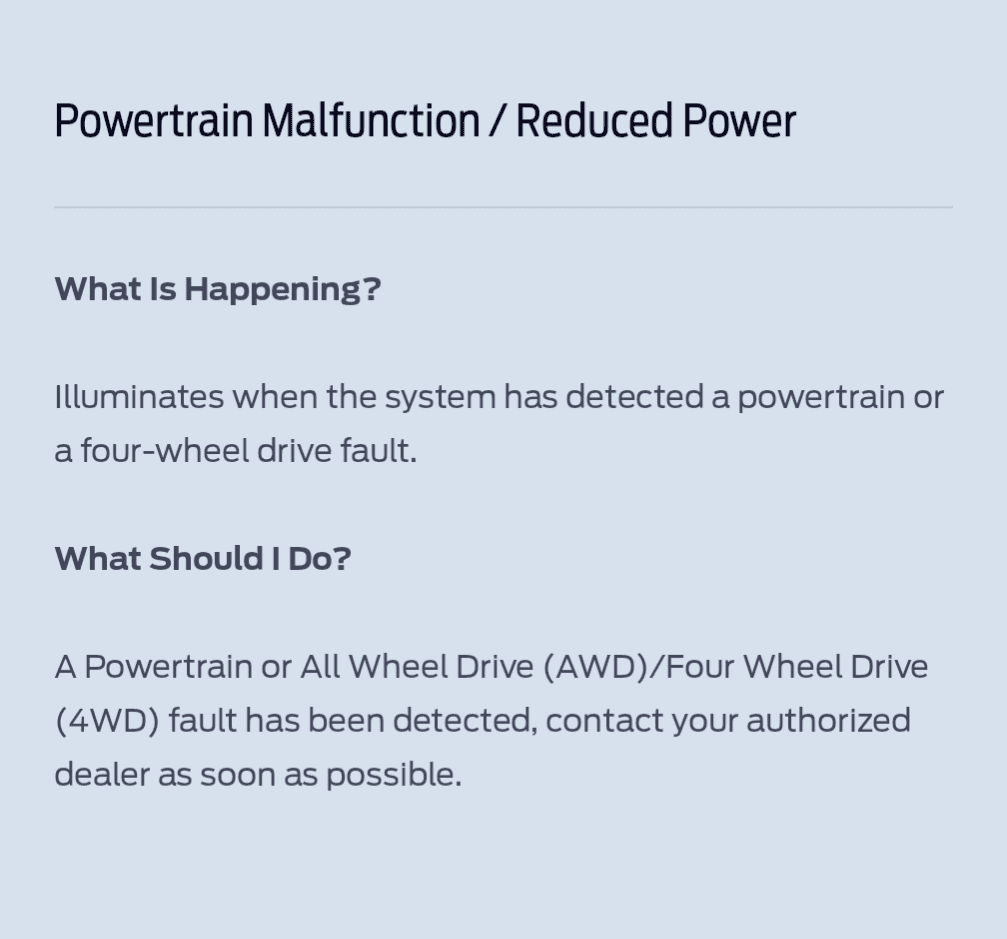

Powertrain Malfunction/ Reduced Power

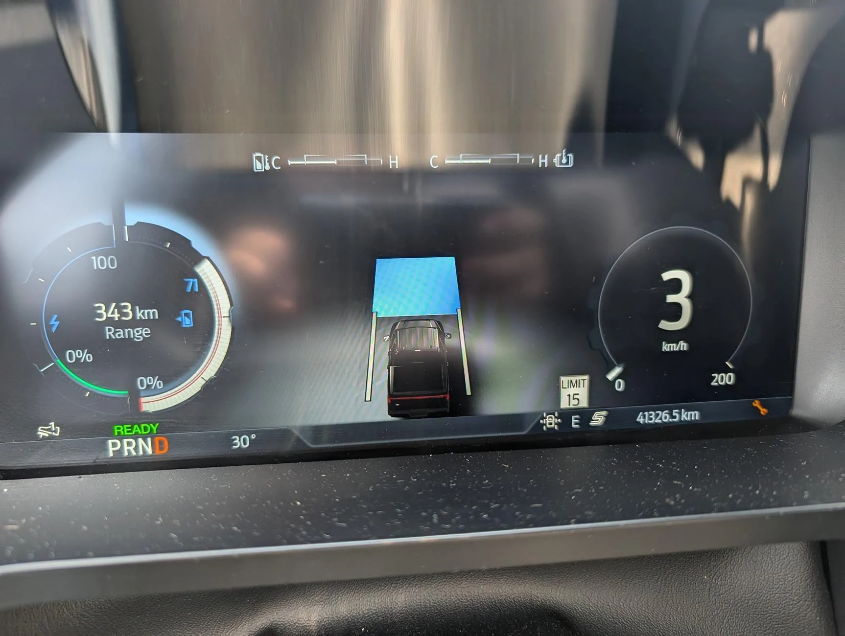

I am having the same issue, but in my case I also lost power (turtle mode).
First time they kept my truck for 22 days and said it was a software issue. Two days ago I had the same issue, dropped the truck into another dealer, and now they are saying it is a fault acelerador pedal.
Both dealers does not give me confidence which means I cannot trust this truck anymore.
It is your battery array that is the problem. It happened to my vehicle three times before it finally quit driving. The first three times I removed the battery terminal and it reset, then it became a weekly reoccurrence and then became a daily occurrence and it completely stopped driving.
