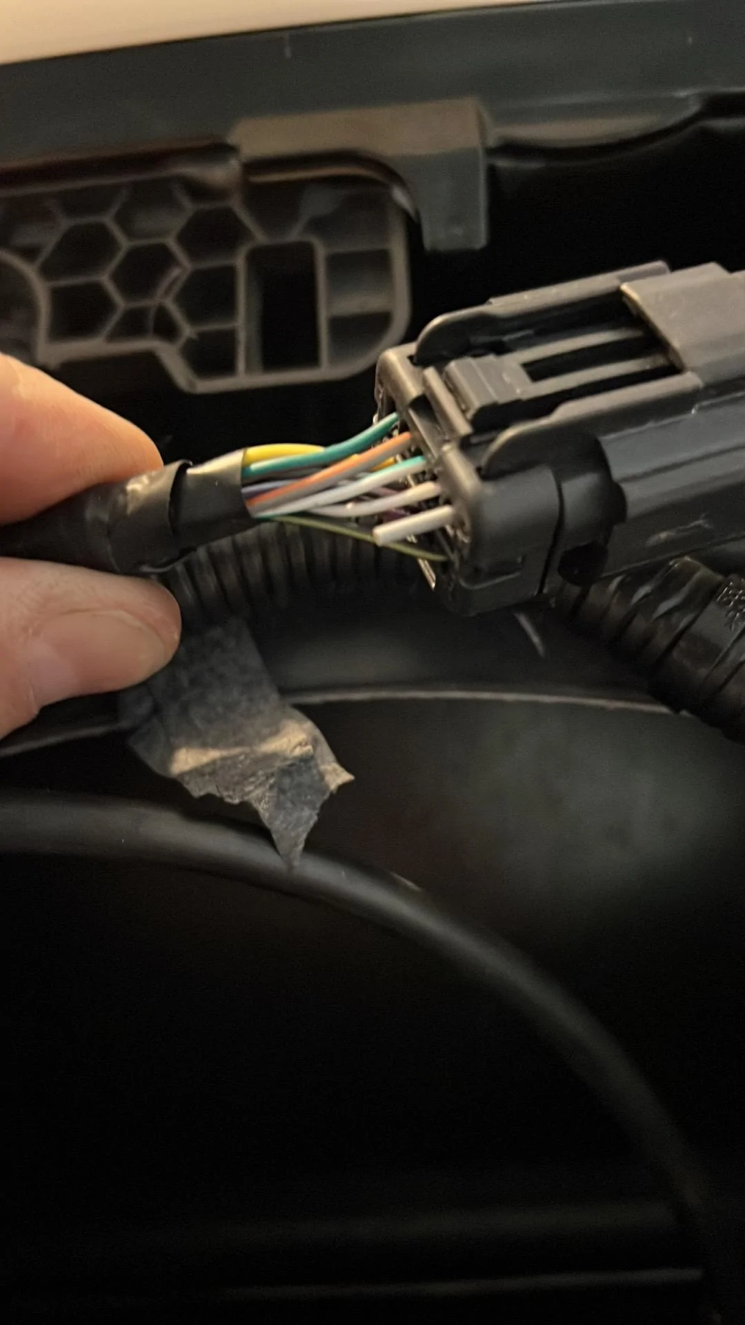

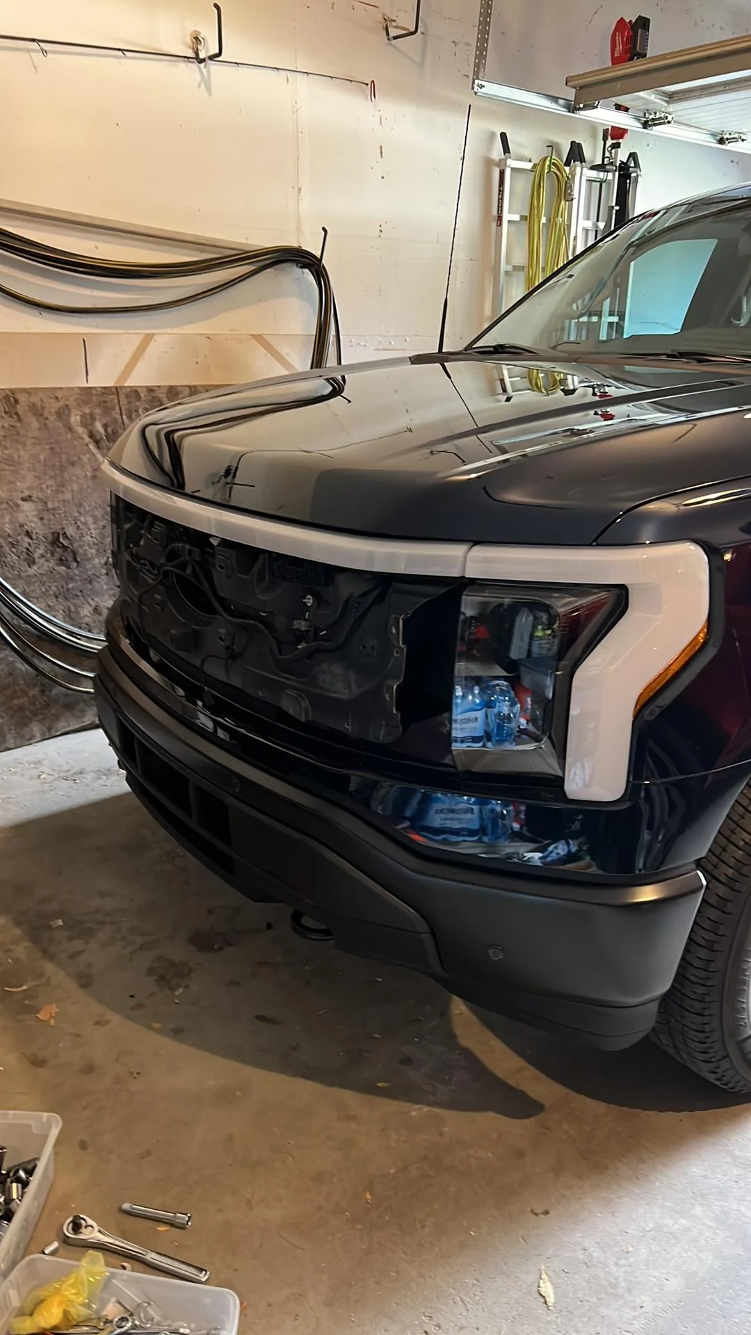

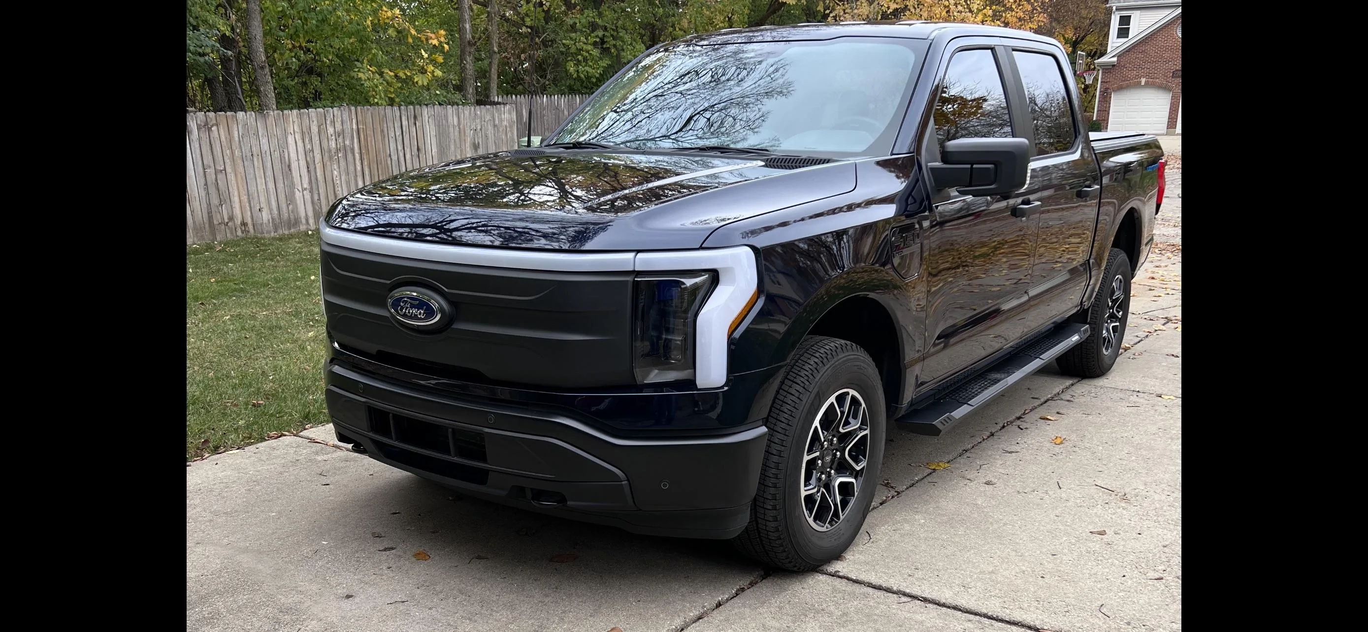

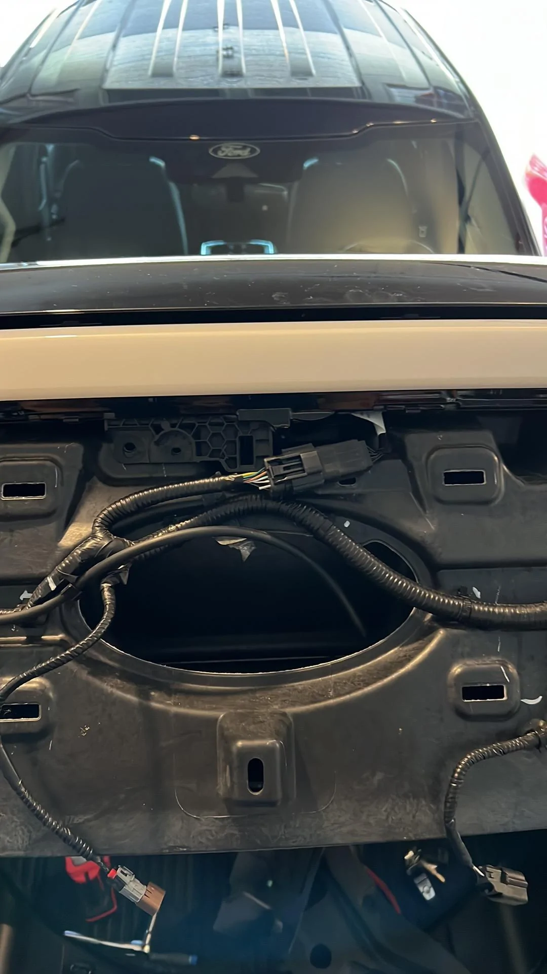

hey all, so I installed the led bar on the pro and here’s what I know so far. The pro grill blank can be simply cut out and grill reused. The light itself has nine wires and communicates with the headlights to turn on/off. There is a wiring harness in place with a blank cap over it ready to go, plug and play no additional wiring needed. I have an appointment at the dealer in a few days to program the function, will update

Hello all! I was assisting Chimed23 in figuring out the programming needed to make the light bar turn on. It is NOT a simple "12v and ground" ordeal, rather the LDCM's supply 32v and 36v to the light bar depending on circumstances. I have already calculated the As-Built data the needs to change in order to make it work (simply plugging it in does not turn it on). Chimed23 has an appt with a dealer next week with instructions I provided to him to give to the tech in order to turn it on. If it is successful, I will reply here with the instructions for programming.

So forscan should have a beta version that isnt released yet that works with the BEV ford's, however, I am unsure if Forscan can communicate with the LDCM private can network. Chimed23 is going to the dealer for them to utilize their FDRS to modify the as-built
Is the power requirements for the lightbar unique?
Would tapping into one of the matching lights surrounding the headlight be a viable workaround (albeit with a bunch of wire)?
Unfortunately not, the LDCM's act as a ballast and drive a higher voltage and can alter that voltage to affect output

Correct, that’s the plan, modify the as built. I confirmed with elec tech that if the system allows they will do it since it’s a factory part and wiring is already in place.
