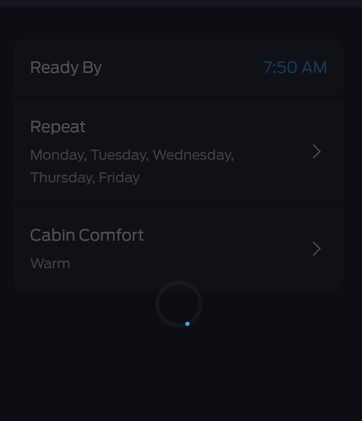

Afternoon everyone, I noticed in the recent Ford pass update that they added the "Prepare cabin off plug" feature back into the departure times screen on the app. However when I try to turn it on, the screen buffers for a sec and then immediately turns itself back off.
I tried hard restarting the app, clearing the departure times in my truck and trying again and it still acts the same. I called customer service about it and they didn't really have a solution for me so I'm wondering if there's any tips and tricks to get it to work? Attached is a screenrecord of the issue.

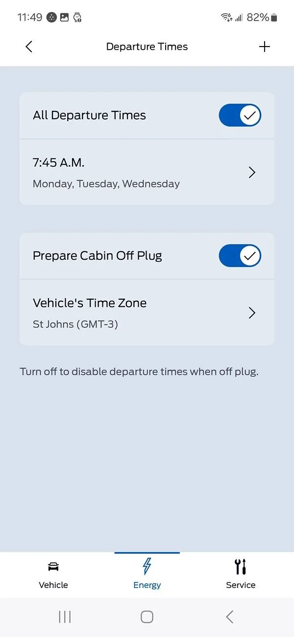

First of all thanks for approval to the fourm. I found this form by googling this exact issue as i was having the problem with my 1 week old 2024 Lightning Pro. I called Ford and spoke at length to them with no resolution. Like others I also use Android and because of this post decided to test the Android theory. I can confirm this is an Android issue. I used the wife's iPhone to turn the option on successfully. Interesting side bar, once it was turned on once with the iPhone I was then able to turn off and back on again with my Android. Thanks again for this awesome form.
Hi from Newfoundland to you all.
JB
Ford F-150 Lightning Problems with Departure Times Screenshot_20240929_114905_FordPass

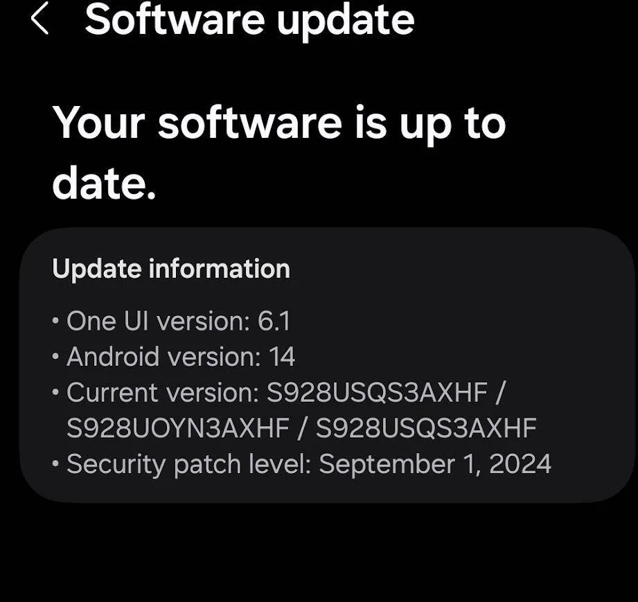

Which device, andriod version are you running?
My Samsung Galaxy S24u works well:

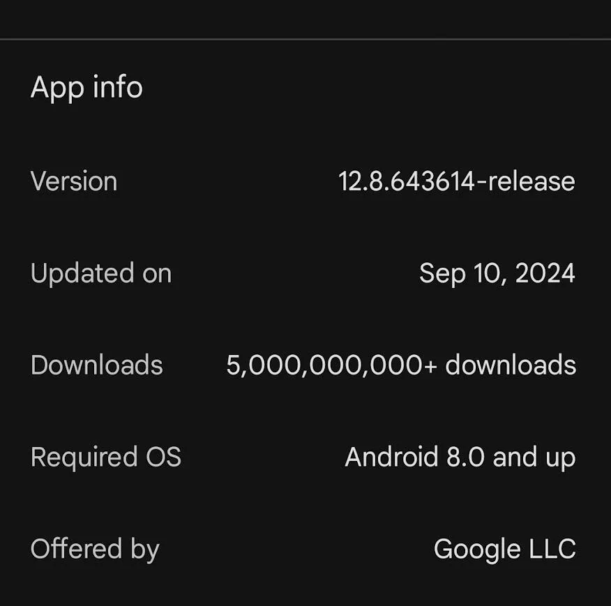

Running Fordpass 5.5.0
Android Auto 12.8.643614 (not sure this part matters)

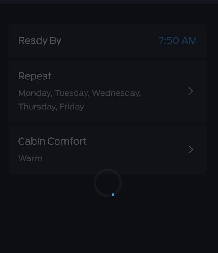

After creating the new scheme conditions & time frames, it took the app about 30 seconds to talk to the server and store the rules.
Ford F-150 Lightning Problems with Departure Times 1727620674980-tu
Ford F-150 Lightning Problems with Departure Times 1727620762584-2v

Hey,
I'm using a Samsung S21 running Android 14 , Fordpass 5.5.0 (same versions as you). Perhaps the issue is more related to the hardware rather than software. For me it's not a big deal since I have it turned on now and don't intend to mess with it now that it's working. Cheers.
