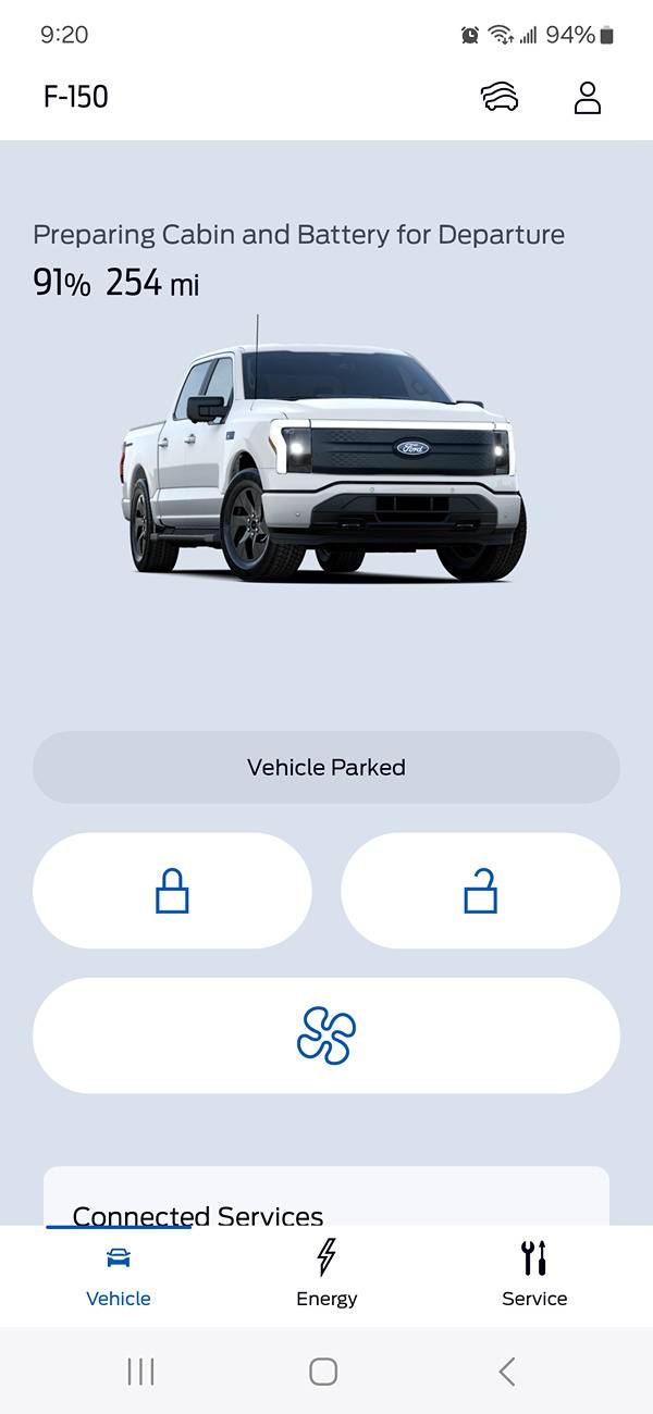

Ford F-150 Lightning Departure Times Just Will Not Work-AGAIN Screenshot_20250125_092018_FordPass

I've noticed the DT's being unreliable the past couple of weeks, even remote climate start wouldn't work yesterday. Today I used DT to 'test' the system, it worked as scheduled, with a duration of 30 minutes, that's needs fixing, should only one cycle of what ever cycle time you set in the remote start setup screen on Sync, ie. 5, 10 or 15 minutes, then if you want to extend you tap the extend button, or if the DT expires in 5, 10 or 15 minutes use the balance of time to request a manual remote start.
@Ford Motor Company needs to tighten up the logic of how this works, be it departure time (DT) or remote climate start.

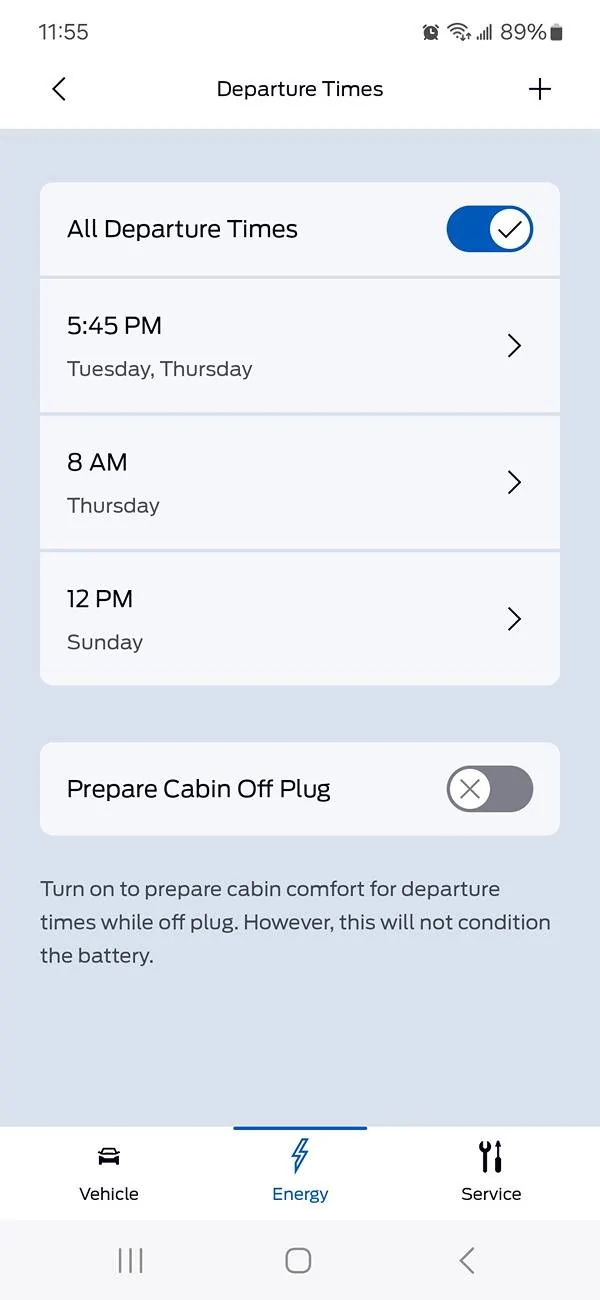

Yes, I accidentally left a Saturday precondition set as this stupid app doesn't have a 1 time use setting for preconditioning. Maddening!
