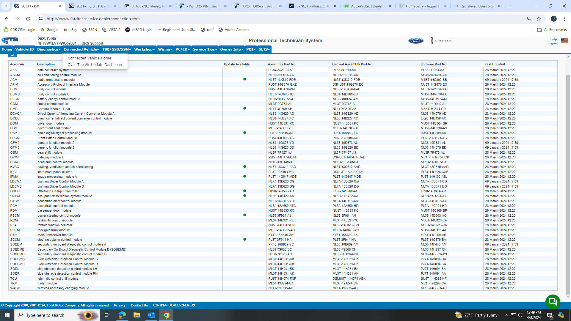

Could someone check my updates please? Thank you much!
Last OTA was 6.4.0 followed by the Tesla charger update. You are on the latest Sync version and not showing many updates pending. After digging a little deeper, it seems some module updates were done with FDRS on 3/29, so there are certain OTA's you won't get since they were done manually. Nothing to be concerned about here.

No OTA's have been sent to you yet, but your truck was built 4 months ago, so no surprise there. Modules with pending updates are below.

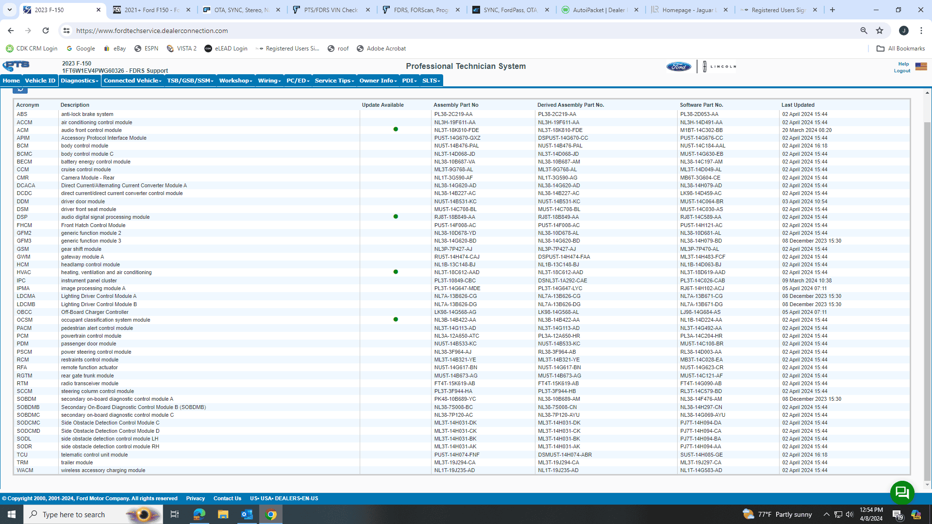

Modules pending updates are below. I don't see anything wrong with your truck. OTA dashboard shows you got your first two OTAs sent in the past two weeks. Hopefully the trend continues and you continue to get more.
thanks @rugedraw

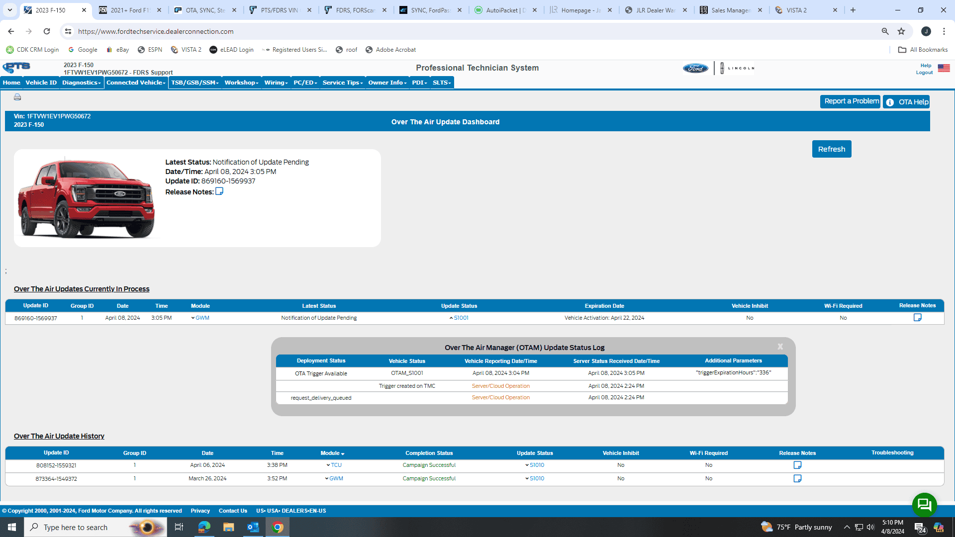

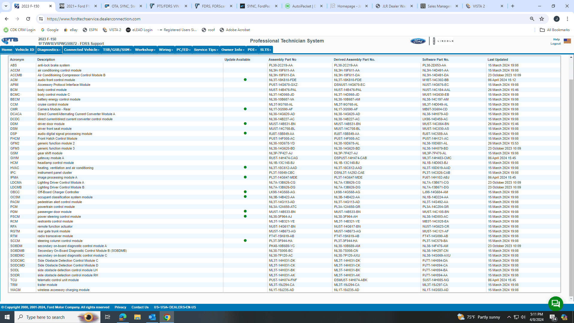

This is an awesome offer! Can you take a look at my OTAs and modules?
VIN : 1FTVW1EV1PWG50672
OTA 4.2.3.1 is queued up for your truck as of 2 hours ago. Next time you start the truck, it will proceed to download and install the update if all goes well.
Ford F-150 Lightning PTS/FDRS VIN Check Thread 1712610680747-jo
Modules pending updates are below:
Thanks!
