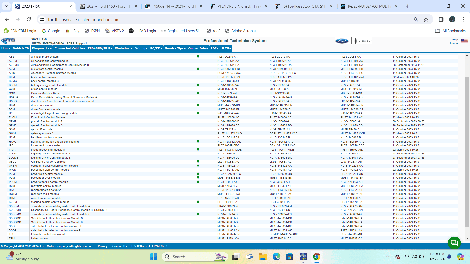

Please let me know about mine, I just bought it and want to see if it is behind on updates. Thank you!
1FT6W1EVXPWG60654

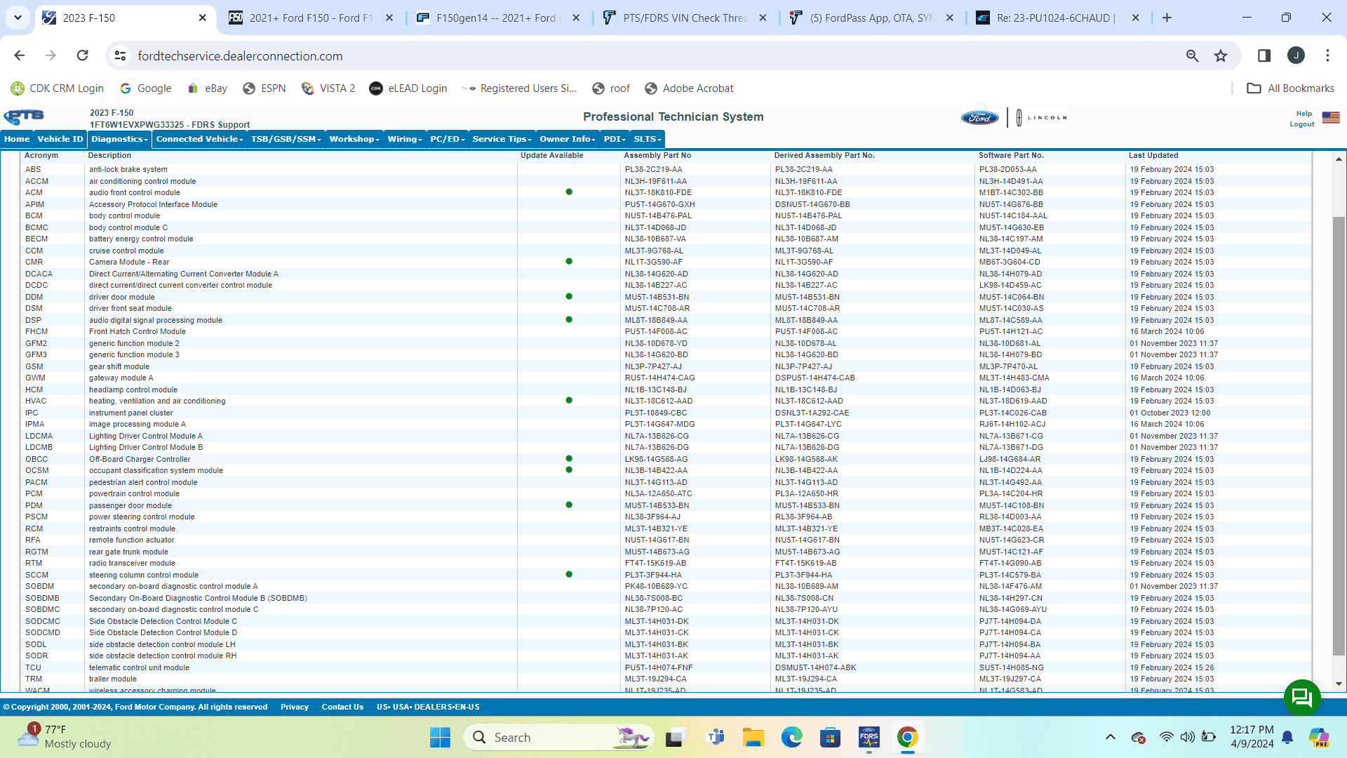

I have to say it's really nice of you to be doing this and checking. If you'd be so kind can you please check mine? It a Sept 23 build and only 1 update so far. Thanks again!
1FT6W1EVXPWG33325

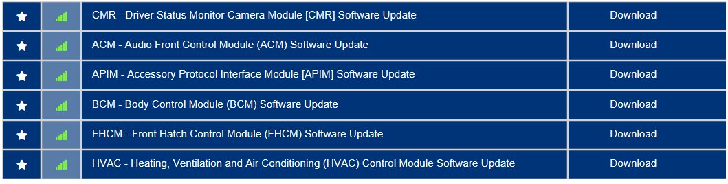

4.2.1.2 was sent to you in February and nothing before or after. Modules pending updates are below:
Ford F-150 Lightning PTS/FDRS VIN Check Thread 1712679434868-qr

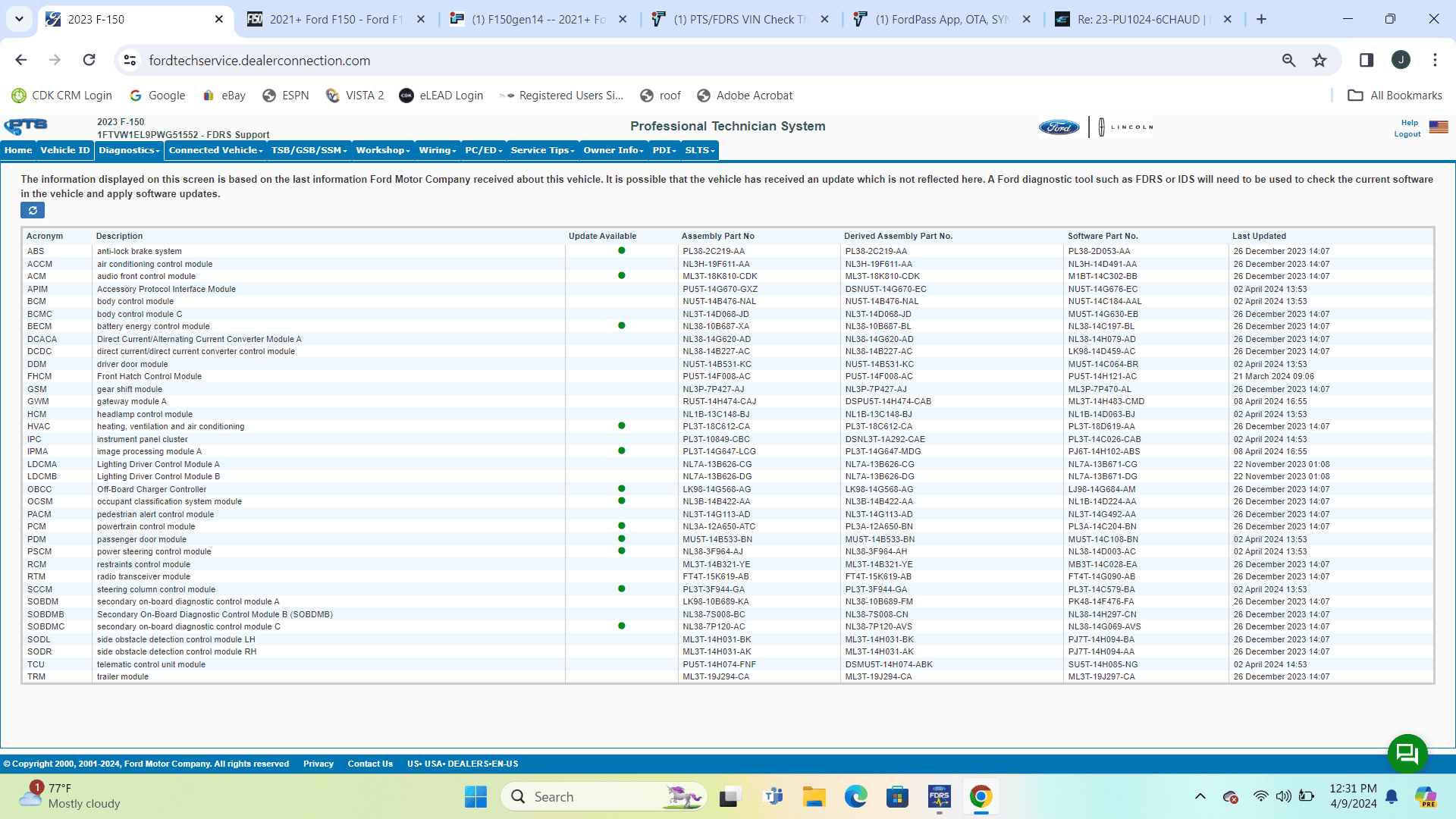

1FT6W1EV8PWG35106
can you check it all? Thank you very much!
No OTA's recorded yet; truck seems to be talking to the cloud just fine. Pending updates are:
Ford F-150 Lightning PTS/FDRS VIN Check Thread 1712679527776-jx

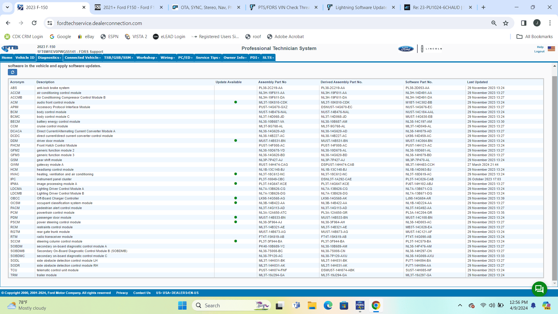

1FT6W1EV0PWG14461
Thanks!!

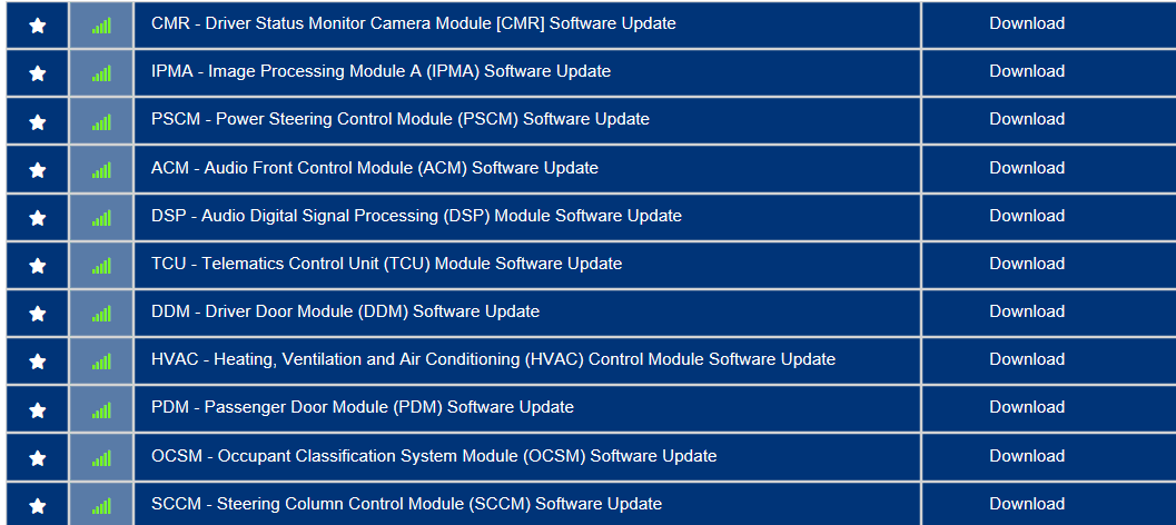

Last OTA attempts you had were APIM update 23-PU1103-NAT-VCE that was sent twice toward the end of last year but failed due to a software/manifest mismatch. Your last successful OTA was 6.2.0 last October. Pending updates are below.
Ford F-150 Lightning PTS/FDRS VIN Check Thread 1712679714393-mw

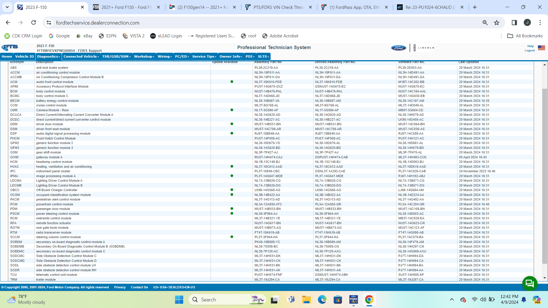

1FT6W1EVXPWG60654
Sync 23159 is one behind the latest version. Pending updates are below:

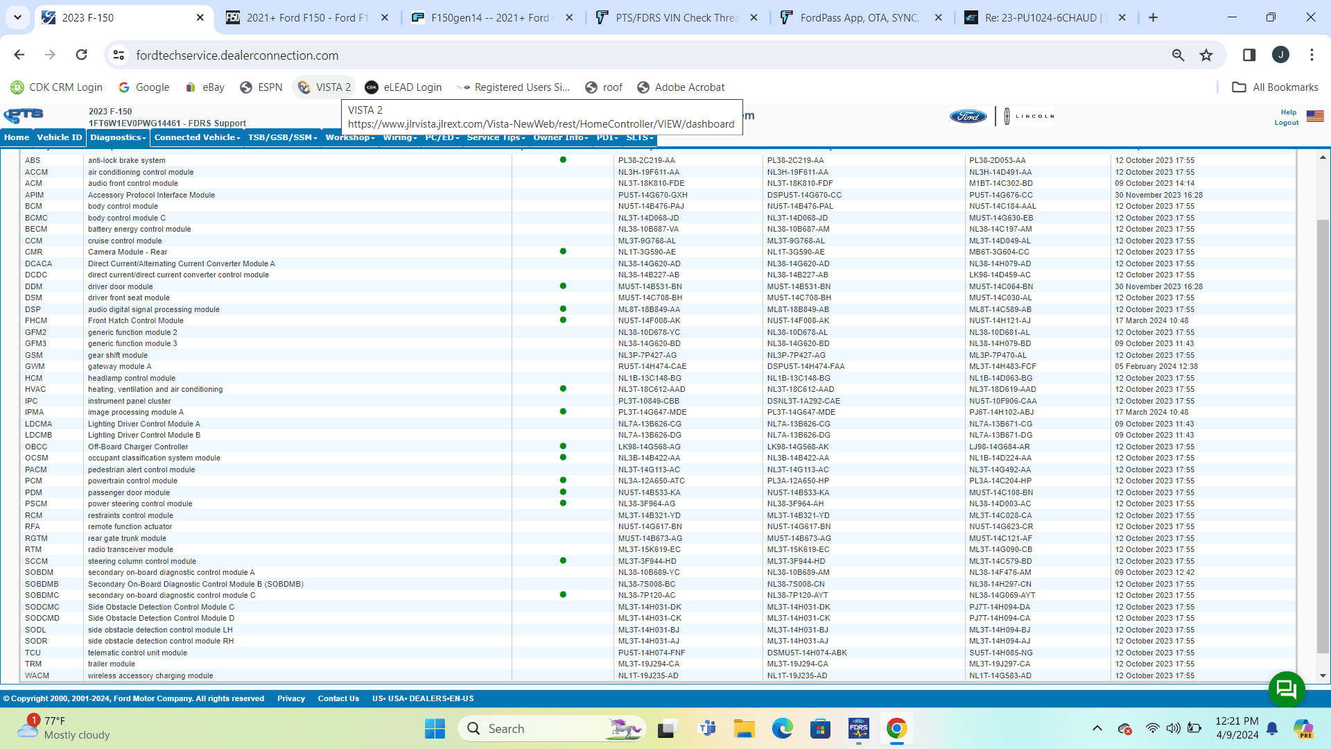

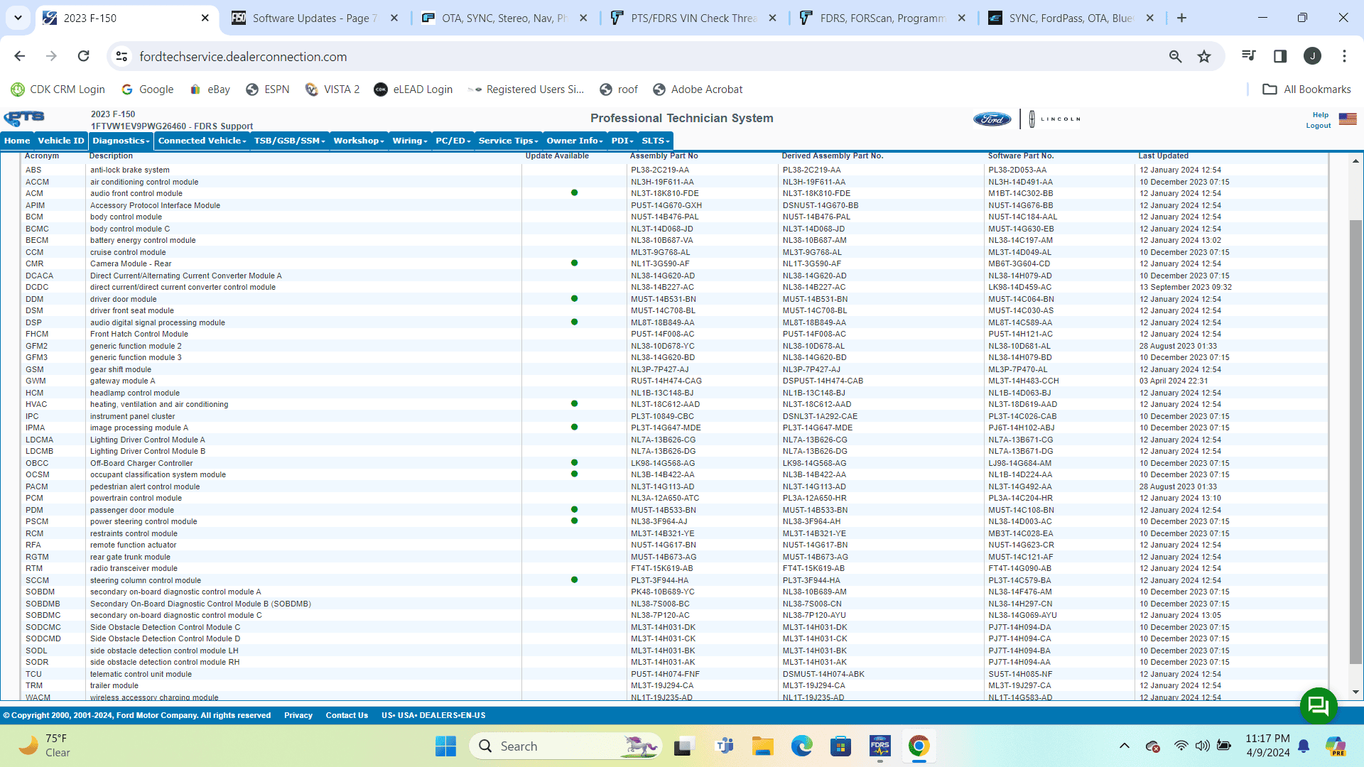

Acquired mine a week ago and looks like I’m behind on software.
1FTVW1EV9PWG26460

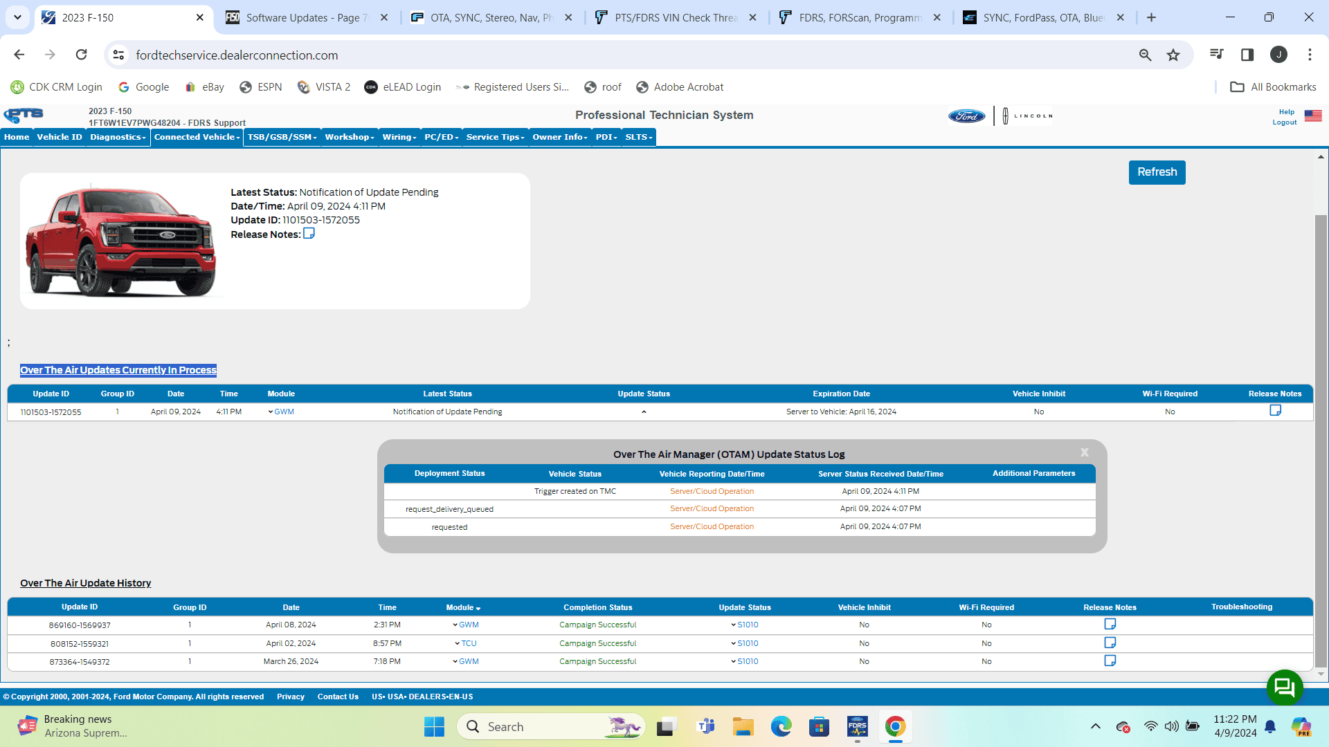

Please check mine too? Only owned it for a month. Getting weekly updates, but long way to go, I think. Thank you in advance!!
1FT6W1EV7PWG48204
1FTVW1EV9PWG26460
Yea, it's a bit behind. Also missing APIM, GWM, TCU and IPC updates not shown here. Hopefully now that it is being driven, it will touch base with the mothership and you start getting updates sent. Nothing wrong with the truck itself.
Ford F-150 Lightning PTS/FDRS VIN Check Thread 1712719123204-
1FT6W1EV7PWG48204
OTA 6.1.0 was sent to you earlier today. Next time you start your truck, it will allow the OTA trigger to go to the next step and if all goes well, download and install the update.
