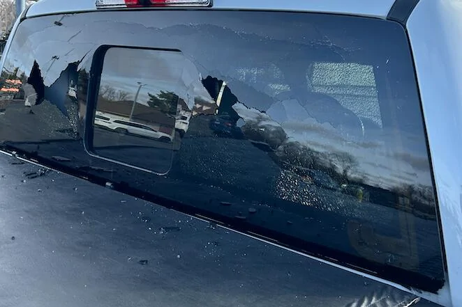

Well, we found the reason for the rear glass shattering!
When the glass installer was removing what was left of my rear window, they discovered that the wiring connector for the rear defroster was completely MELTED! It wasn’t just damaged—it was a glob of melted plastic fused with glass shards. 😂
This pretty much confirms that the issue was overheating in the rear defroster system, which likely caused thermal stress on the glass until it failed.

Wow, but what caused it to overheat, just being on too long? Reminds me of the heated back seat discussion. I still have concerns why just your truck has got too hot twice ...
Do you think that is the original connector, that was in place when the first window burst? It looks from your photos the source of the heat was the hottest at the contact point (splice) where the wires are secured to those within the window. The more contact area, the less heat at that point.

So did the dealer do the replacement as warranty then?
Bad solder joints can lead to hot spots like that, or any loose or corroded connection, like when people don't torque down their FCSP power wires or in a breaker box.
Made in China? I have seen a lot of bad solder joints in inexpensive stuff made in China - light fixures, solar cells on outdoor lights etc. Sometimes I can resolder them, other times it's back to the store for a refund.
Had a GE hybrid water heater that had bad welds on the compressor tubing - GE tech came out and looked it over, then they replaced the whole water heater...then that one failed the same way, and Sears came out and replaced that one...then that one failed! So Sears came out and looked at it, ordered a part - from China, which took several months - then welded the part on.
I bought it with the 5 year service contract free when it was on sale. The water heater paid for itself in less than a year in lower electric bills, but what a hassle with repairs!
That glob of plastic on the wiring might have been a seal on the solder joints between the car wiring and the heating element in the glass.
My theory anyway.

I’m wondering if anyone else with an F-150 Lightning has experienced their rear window shattering for no reason? I’ve now had to replace my rear window twice, and neither time was it struck by anything. Once in late October and now again in early February (colder months).
The first time it happened, I brushed it off, thinking maybe a small crack had formed from some unknown impact and later failed. But now that my replacement window randomly shattered last weekend while I was driving, I have a strong suspicion that this is a thermal issue.
I believe the problem might be related to the automatic preconditioning system. When the vehicle warms up on a cold morning before departure, it seems like the rear window defroster turns on automatically. Then, when I get into the cab and fully start the vehicle, the defroster turns off until I manually reactivate it if needed. This means the rear glass is potentially going through multiple rapid heating and cooling cycles every single morning, which could be causing stress fractures and eventual failure.
For reference, I have an F-150 Lightning Lariat with the power sliding rear window and rear defrost.
Has anyone else had their rear window unexpectedly shatter? I’d love to hear if others have run into this issue.

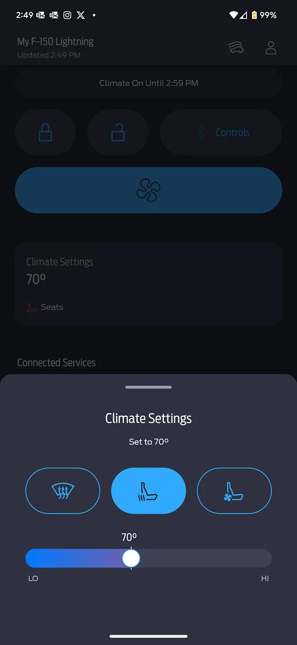

Can anyone see in the climate control programming if there is a temperature during remote start that the rear defroster automatically turns on as a convenience to try and defrost the rear window before you leave?
