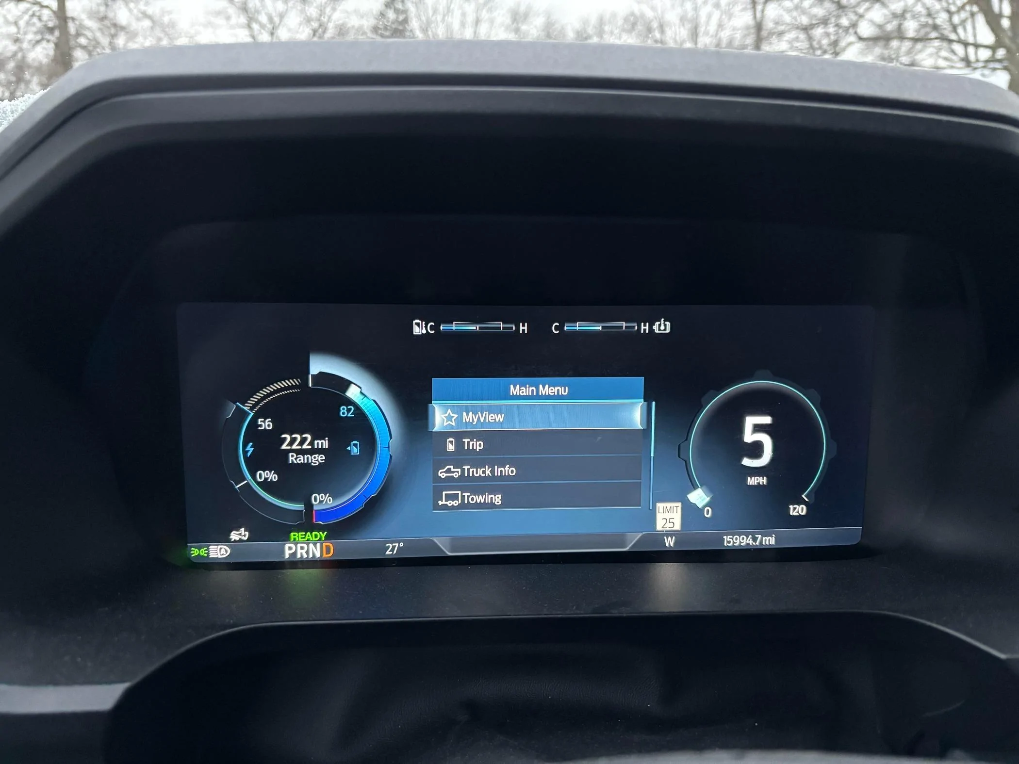

Happened again this morning. Not too cold. Good charge. Definitely saw front motor was not charging/powering.

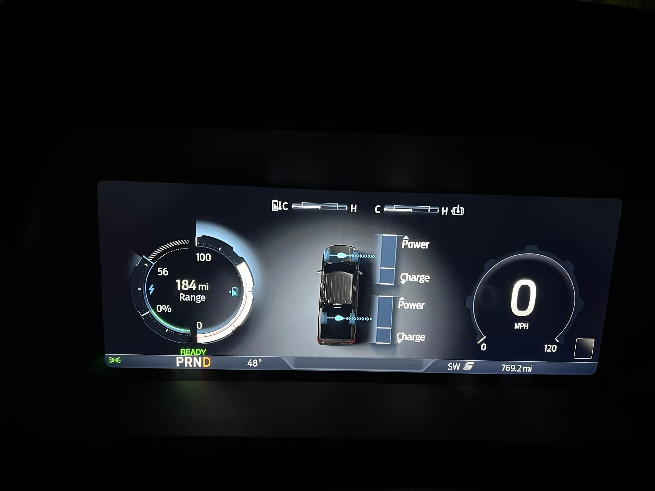

This all just happened to me; I've only had this truck for a week, will have to keep my eye on that. I noticed there was no "punch" when I hit the accelerator.
Didn't think to take a picture / check this at the time; as a newbie, wouldn't even have thought to notice the 56.
Just went out to take it around the block and see if it was just in my head- started up at 100% but I hadn't moved 10 feet in my driveway before this dropped off.
Will keep an eye on it tomorrow and fingers crossed it fixes itself. Jeez louise- I don't even have 1000 miles on this yet..
Ford F-150 Lightning Reduced power with no Fault code Image (1)
thequackenbush
Ryan
Apr 10, 2024
100
106
Upstate NY
Lightning Lariat 2023 Extended Range
Marketing
Brought my kids to school this morning, happened again immediately after beginning to move. Dropped them off, restarted and this is what i figured out
I usually drive in Sport mode bc of the brake regeneration and its a bit more fun. When I start in just normal mode and then switch over to sport, this time is was fine.
Maybe it's a software glitch associated with that. @Ford Motor Company is this a known issue?
