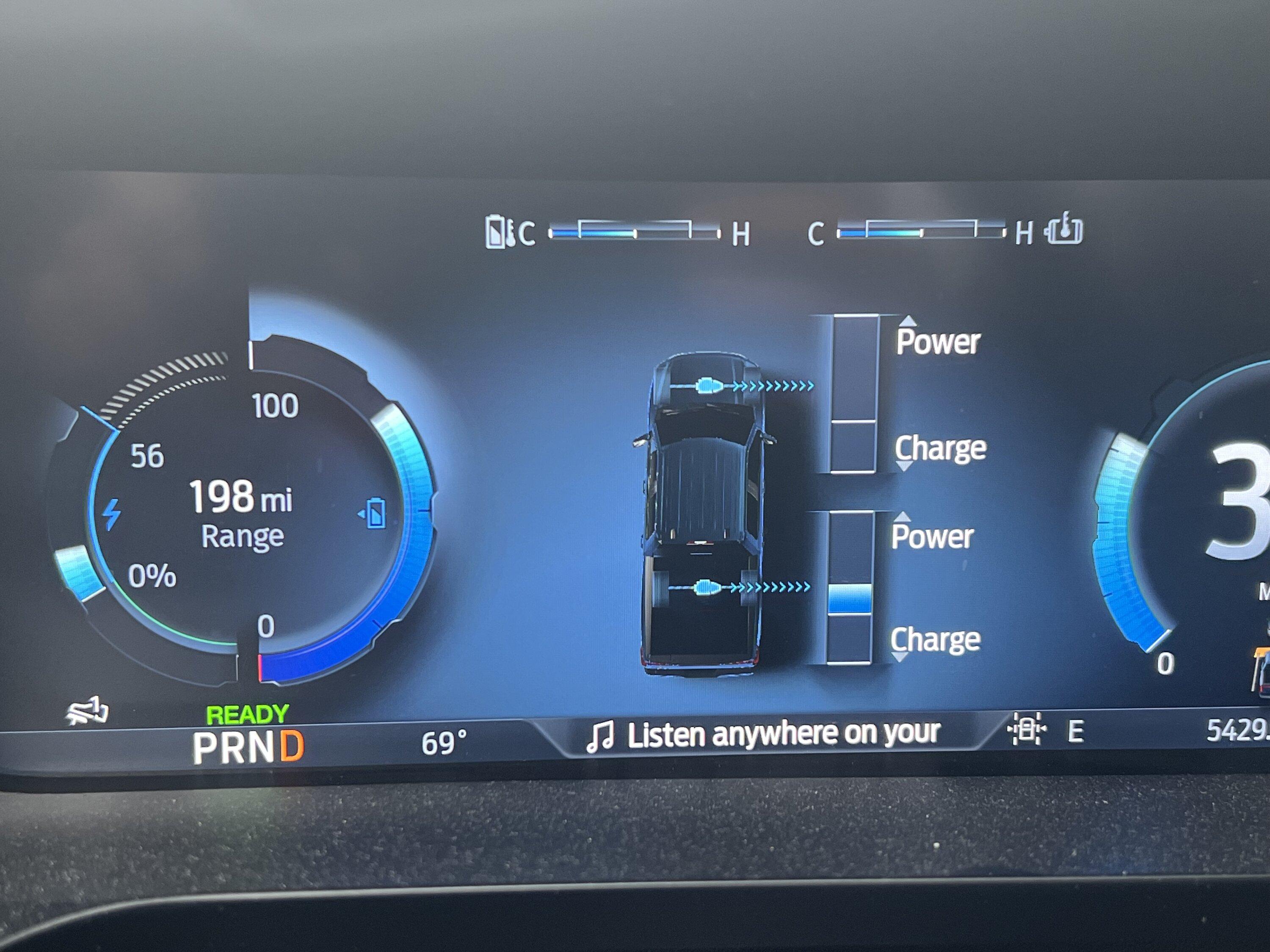

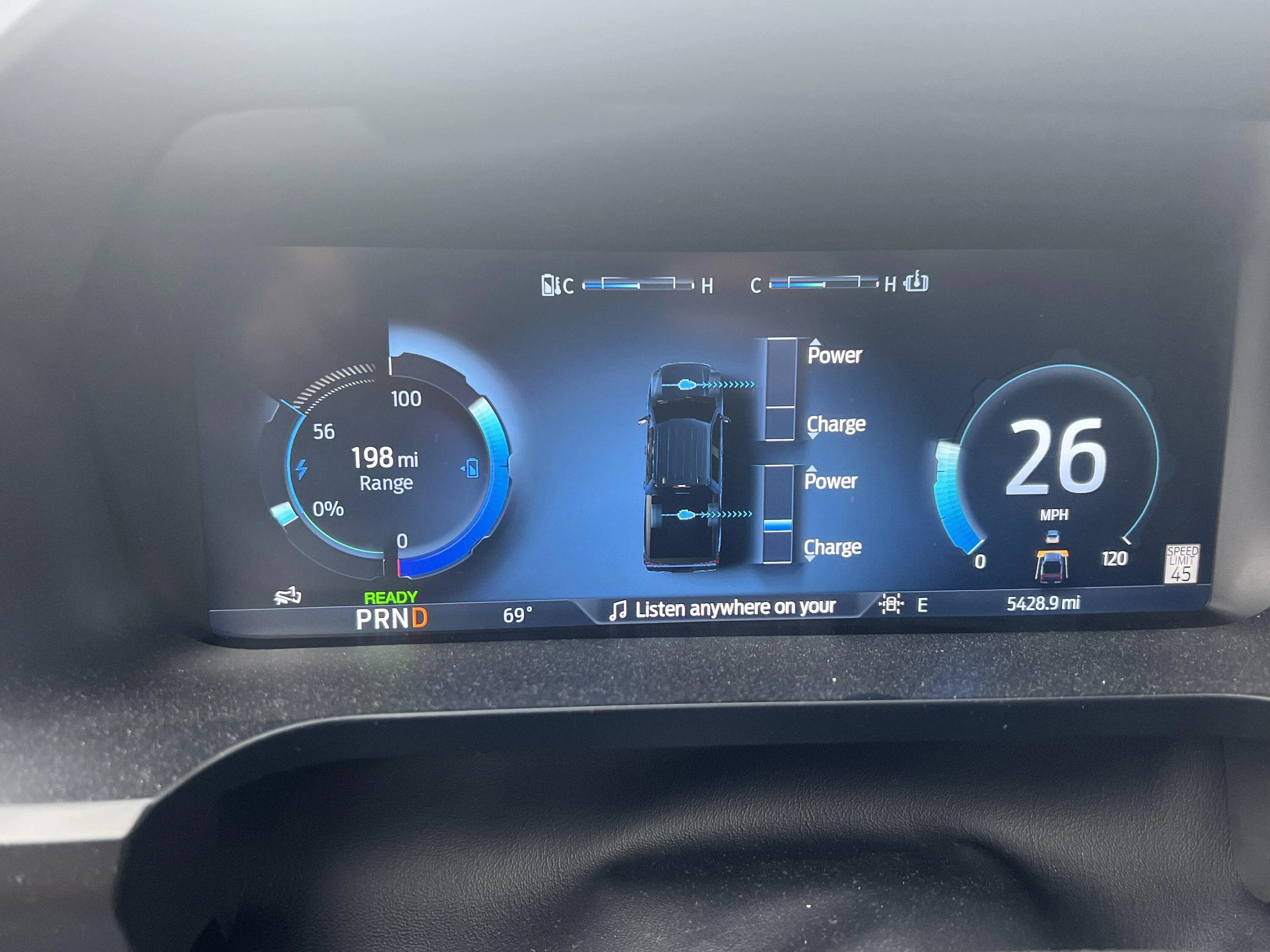

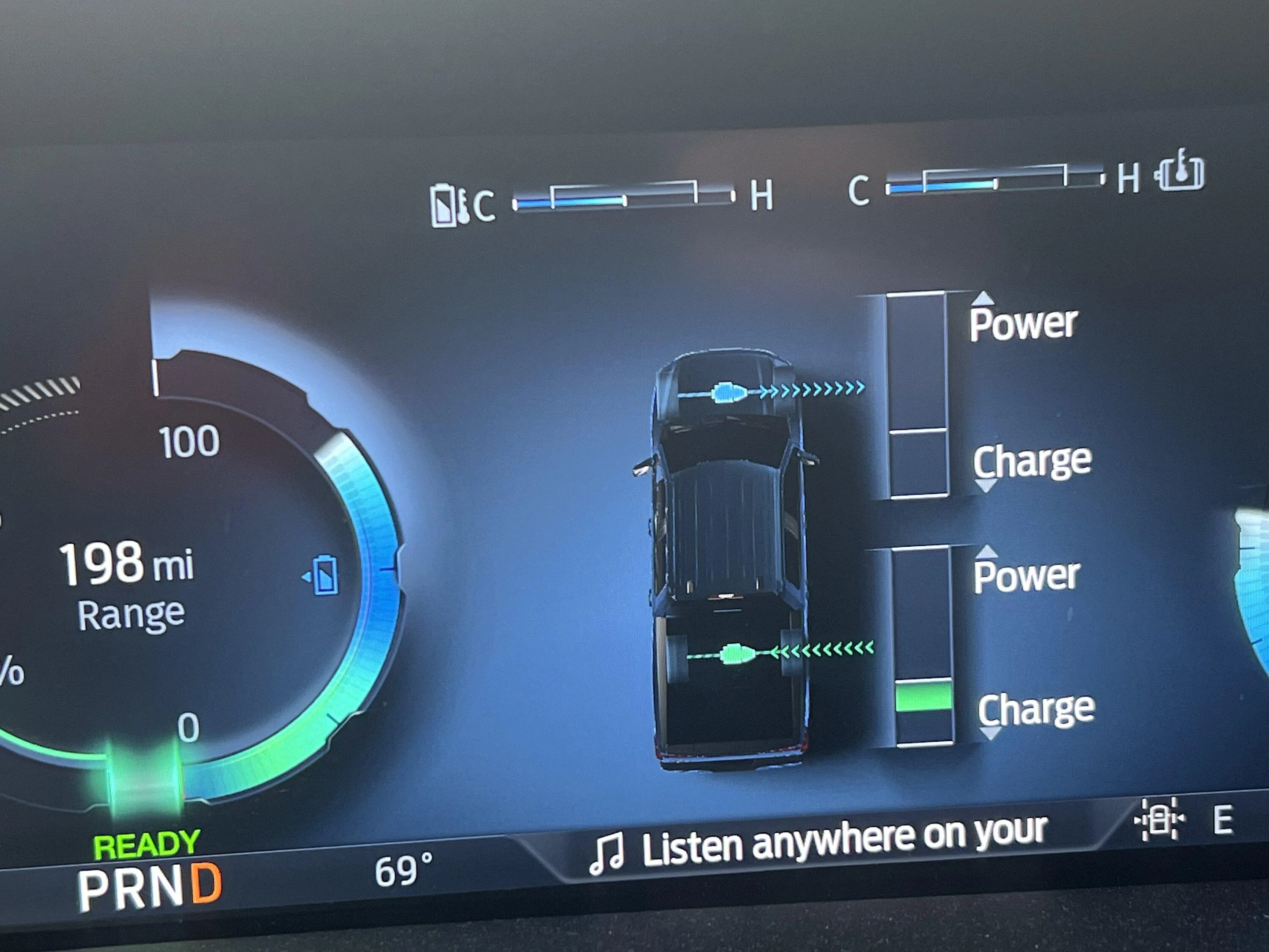

I had this happen now a second time (that I noticed). First time was after a DC fast charge, last night was after a Level 2 charge (very low rate ~3kW) but on charge for around 10 hours.
No fault code, front motor not operating as others have said.
after making a stop for a bit, returned to normal, but is this a “walking wounded” scenario?

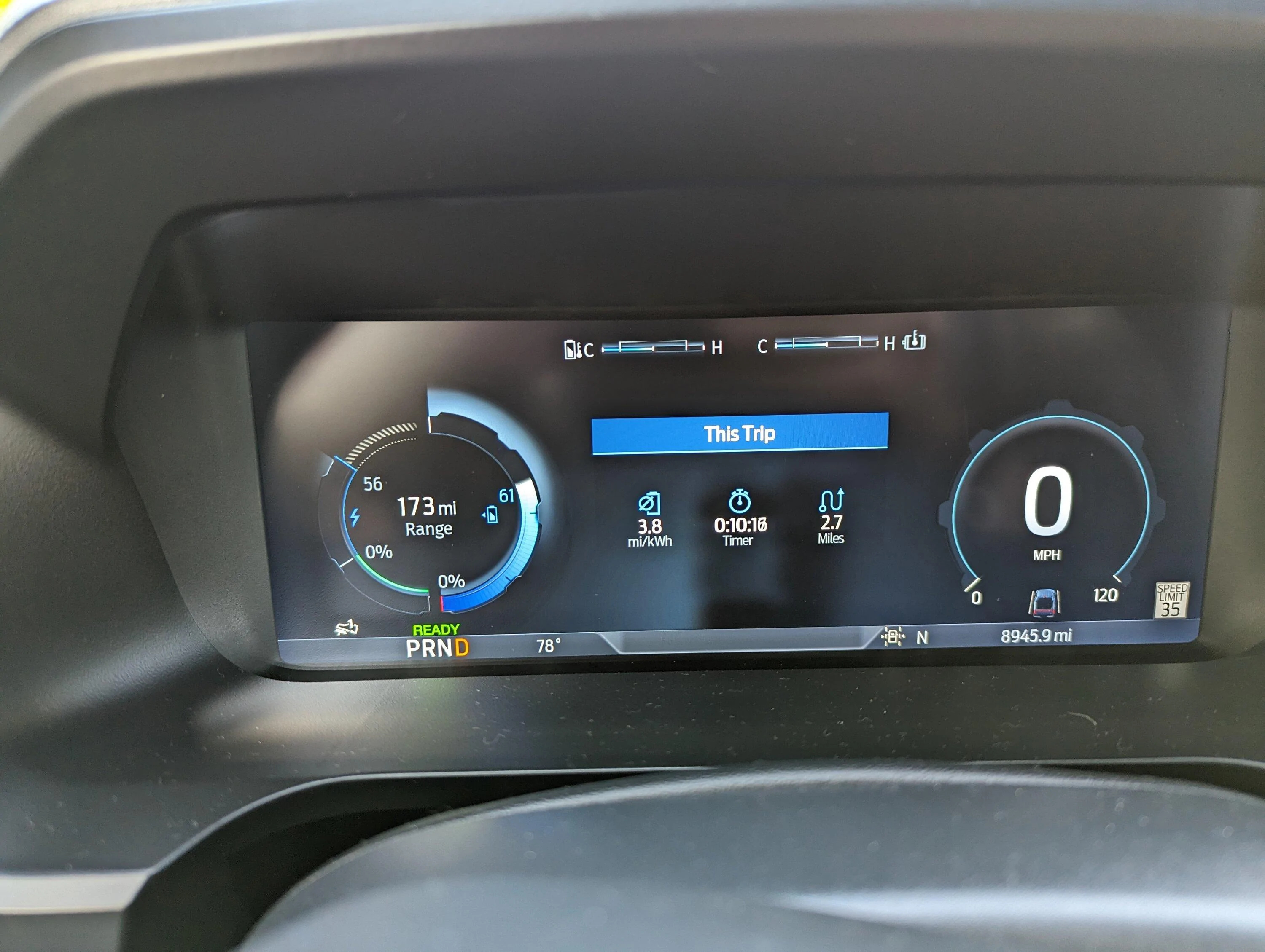

Happened to me again today after charging at work at ~5KW.
Similar to others no power to the front motor.
Reset after sitting around for 5 minutes. At this point I'm not sure if it's a software bug or a hardware fault. Either way I don't know how to get it fixed given that no error codes are being given.
