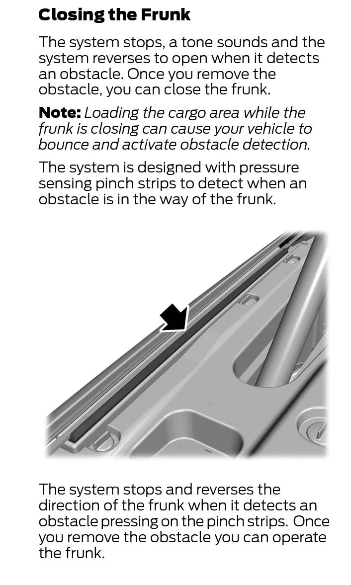

I reread the "Luggage Compartment" portion of the manual. There is no mention of remote start being shut off or not being able to press the button to close it if the truck is locked.
I hope some of the funky Frunk quirks (cannot close via button on frunk if truck is locked and this quirk) do get a "fix". For all I know this might have a real programmed intention, it's just not listed in the manual.
I did learn that our trucks have pinch point sensors. I guessed that's what it was as I hadn't seen those strips in previous F-150's.
