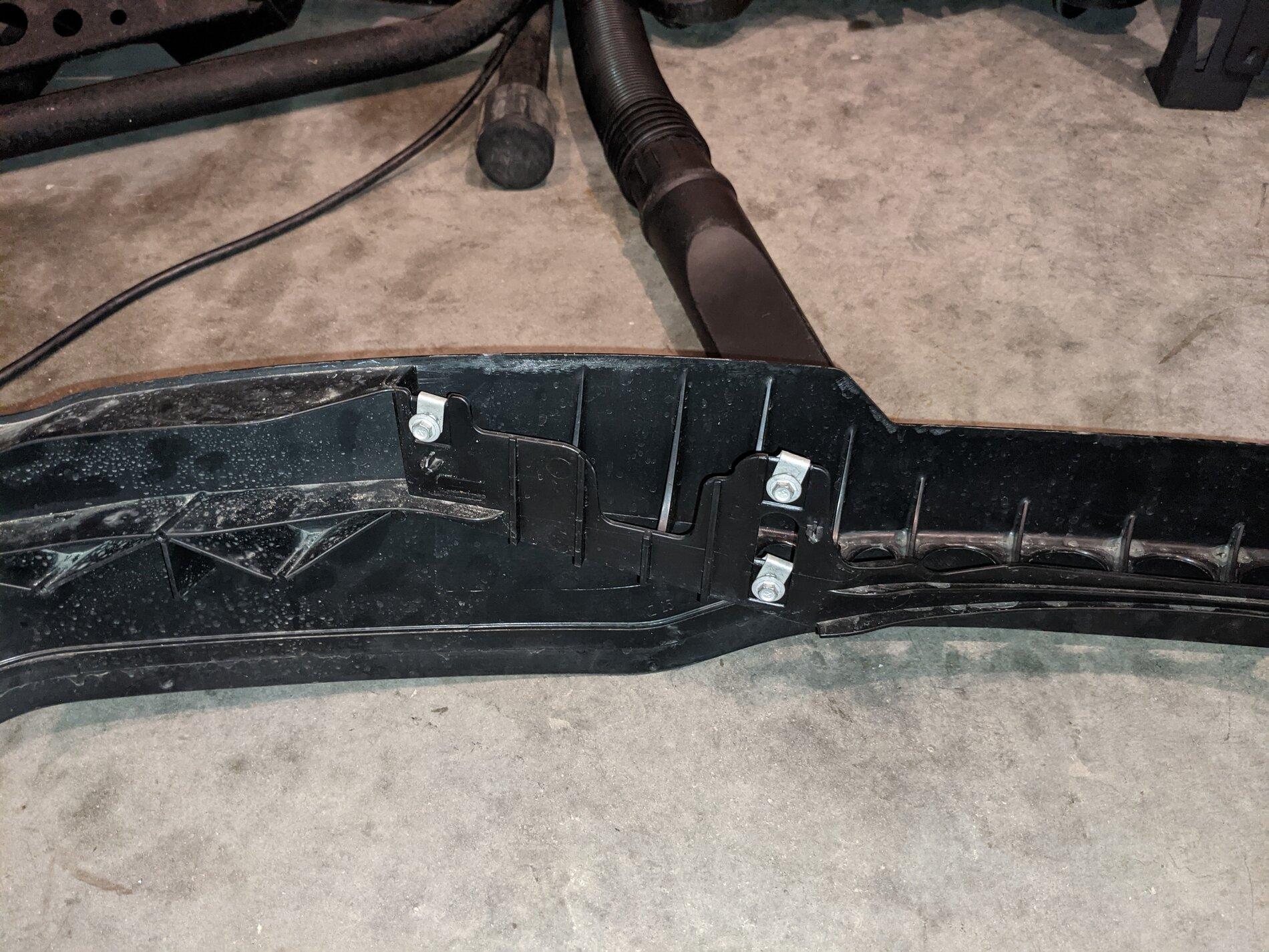

To remove the fixed airdam you have to remove roughly 16-18 nuts.
* Three underneath each foglight.
* Two on each corner.
* About 6 or so in the center behind the license plate bracket area.
In addition to these screws there are 3 plastic retainers (the squeeze and pull kind). 1 in the middle, and 1 on each end.

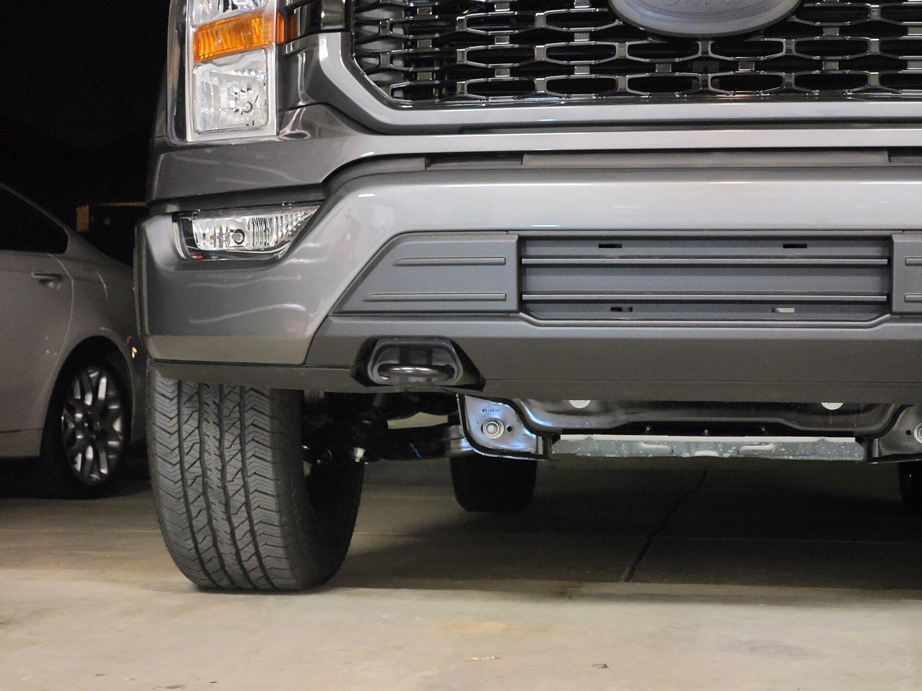

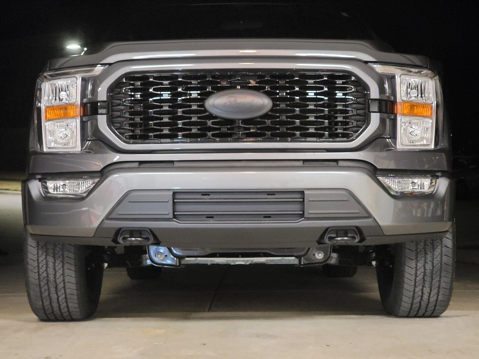

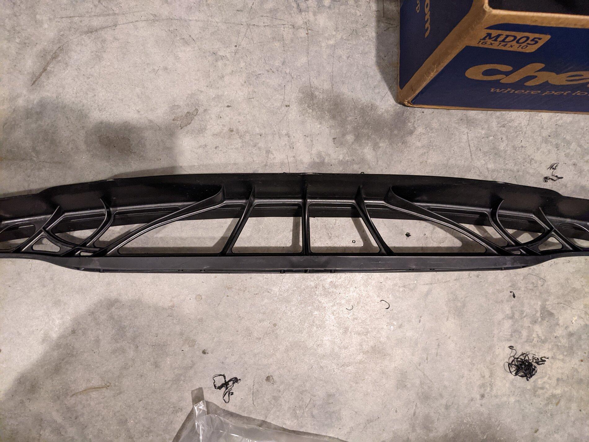

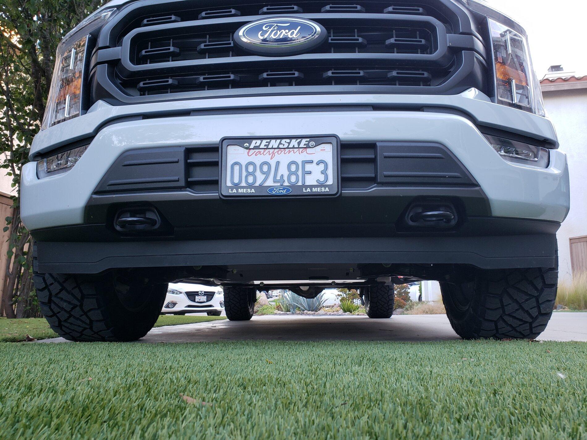

So with the valance completely removed you'll see the towhook rubber filler panels are exposed (the bracket on the left is my foglight hanging). Other than that there isn't any junk hanging below the bumper so you could theoretically stop here.

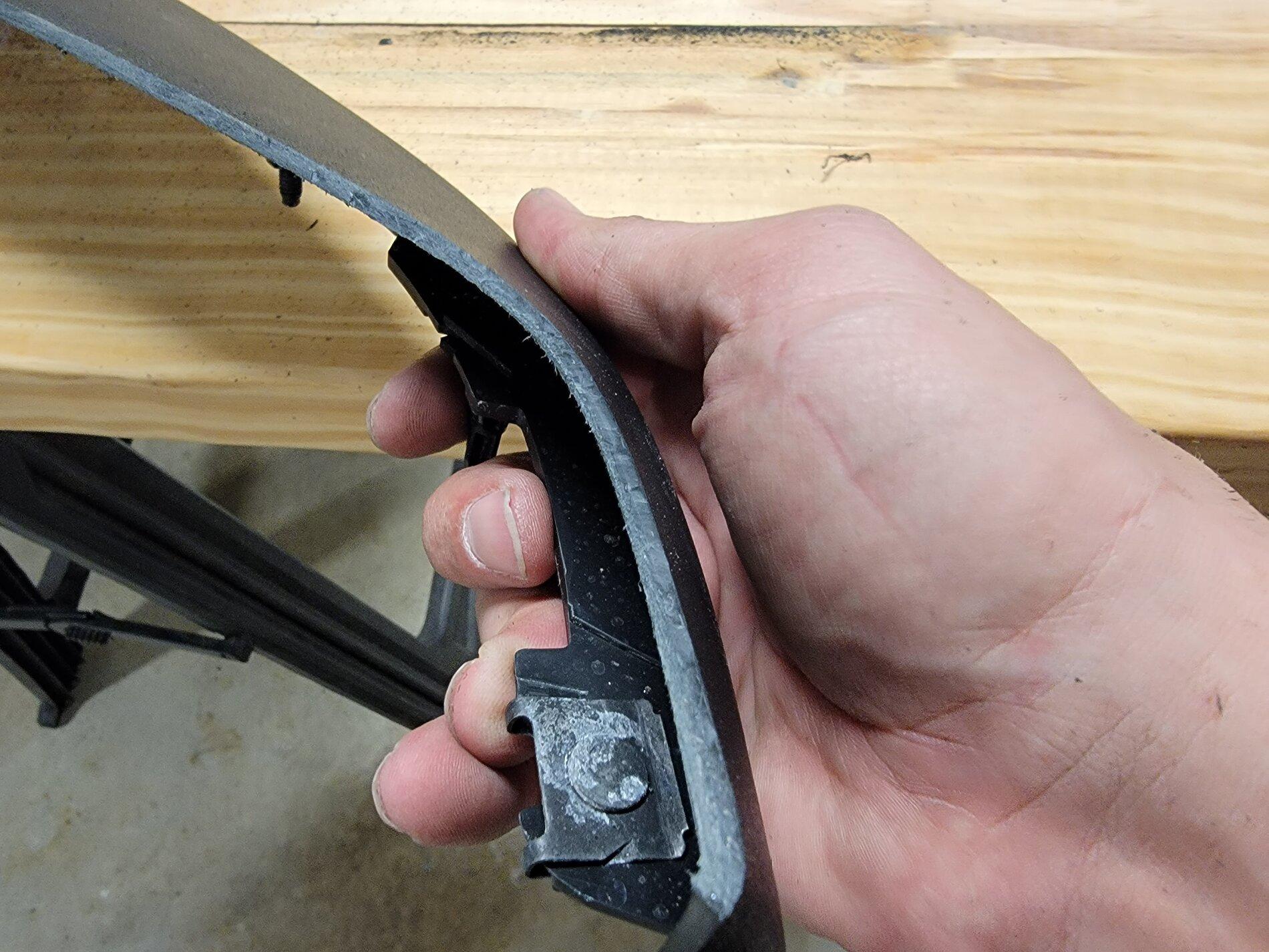

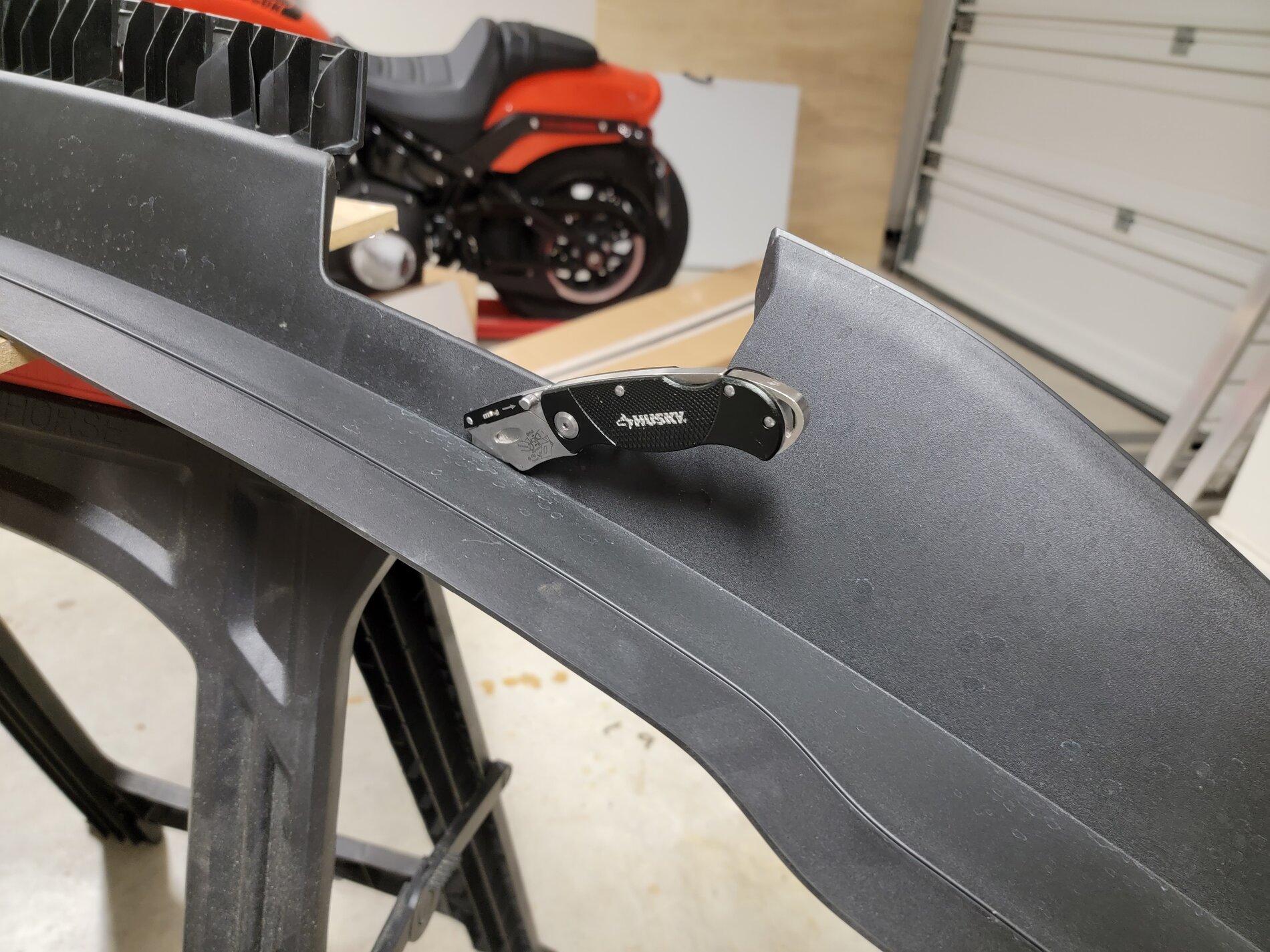

I decided; however, that it would probably look cleaner if part of the airdam was reinstalled. So out came a razer blade (was late, didn't want to wake the neighbors with powertools) and sandpaper.
Then finally after cleaning that up I put it back on the truck.
One thing of note, I noticed without the airdam the plastic that passes under the towhook is a bit flimsy. It will probably be fine, but I decided to put a few zip ties on it for good measure. You probably WONT need to do this, but you'll understand why I did once you trim yours.
I recommend trimming it ON THE TRUCK if you wish to go that route. Will turn a four hour job into about 10 minutes. Hindsight.
The Tremor Skidplate will cover the entire towhook area, and I believe it will use a different lower valance altogether as well. Looks like just end pieces.
So this will do for now on my truck for the extra clearance.

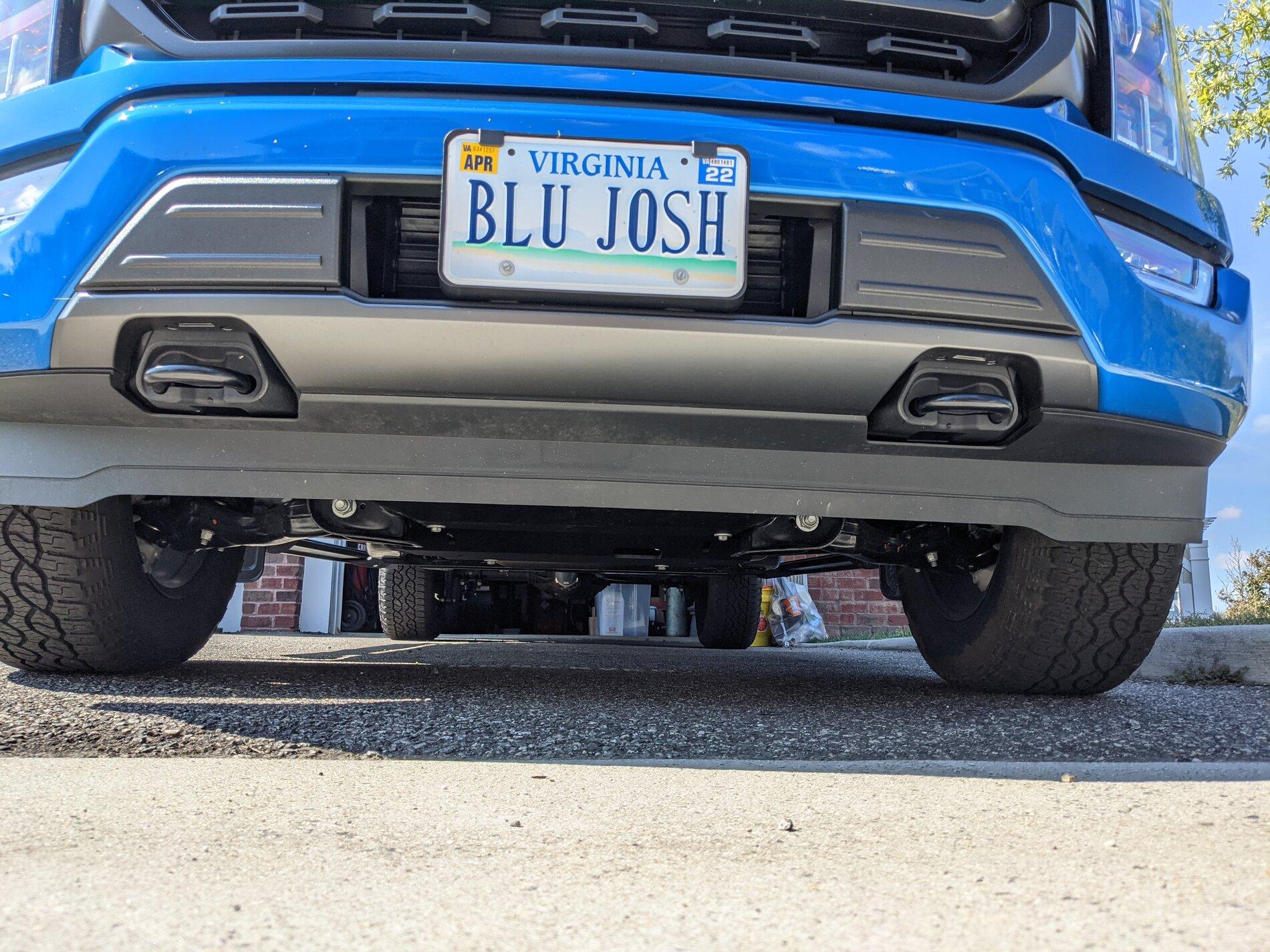

I can confirm, the upper silver portion above the tow hooks is not part of the bumper. I ordered just that part to replace the stock XLT one (I cracked it). After looking at the schematics, it appears that I will be doing some trimming of the air dam once it arrives to make it look correct. I will do a write up similar to yours above and post it in this thread when its done.Here is what the tremor skid plate coverage around the towhook bottoms looks like btw (I believe the upper silver portion above the towhooks is part of the bumper/fascia:

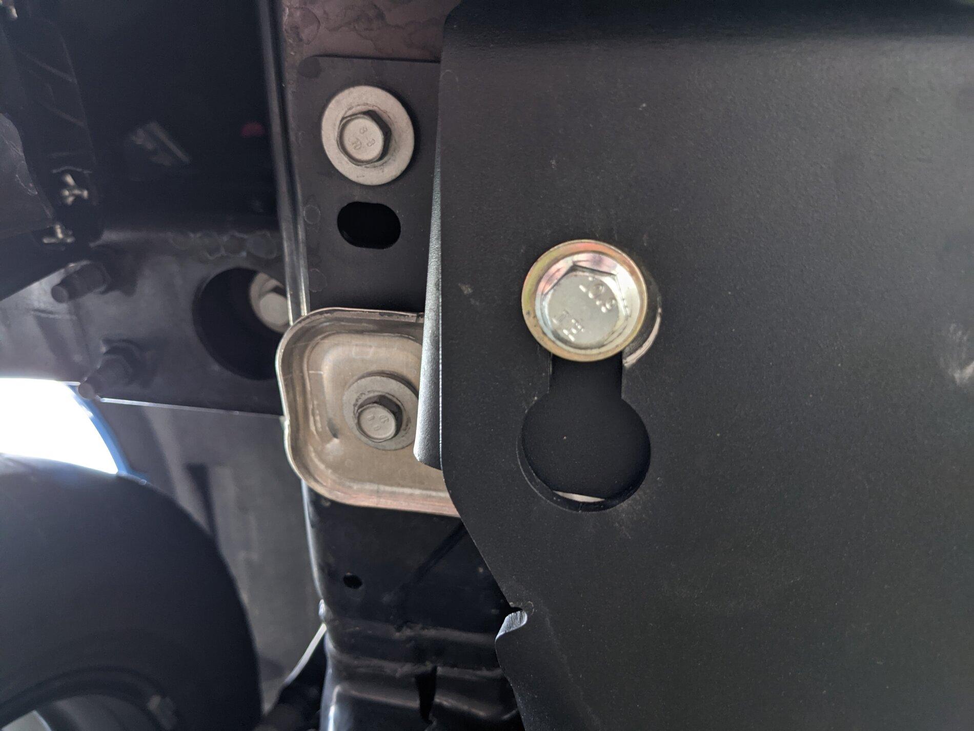

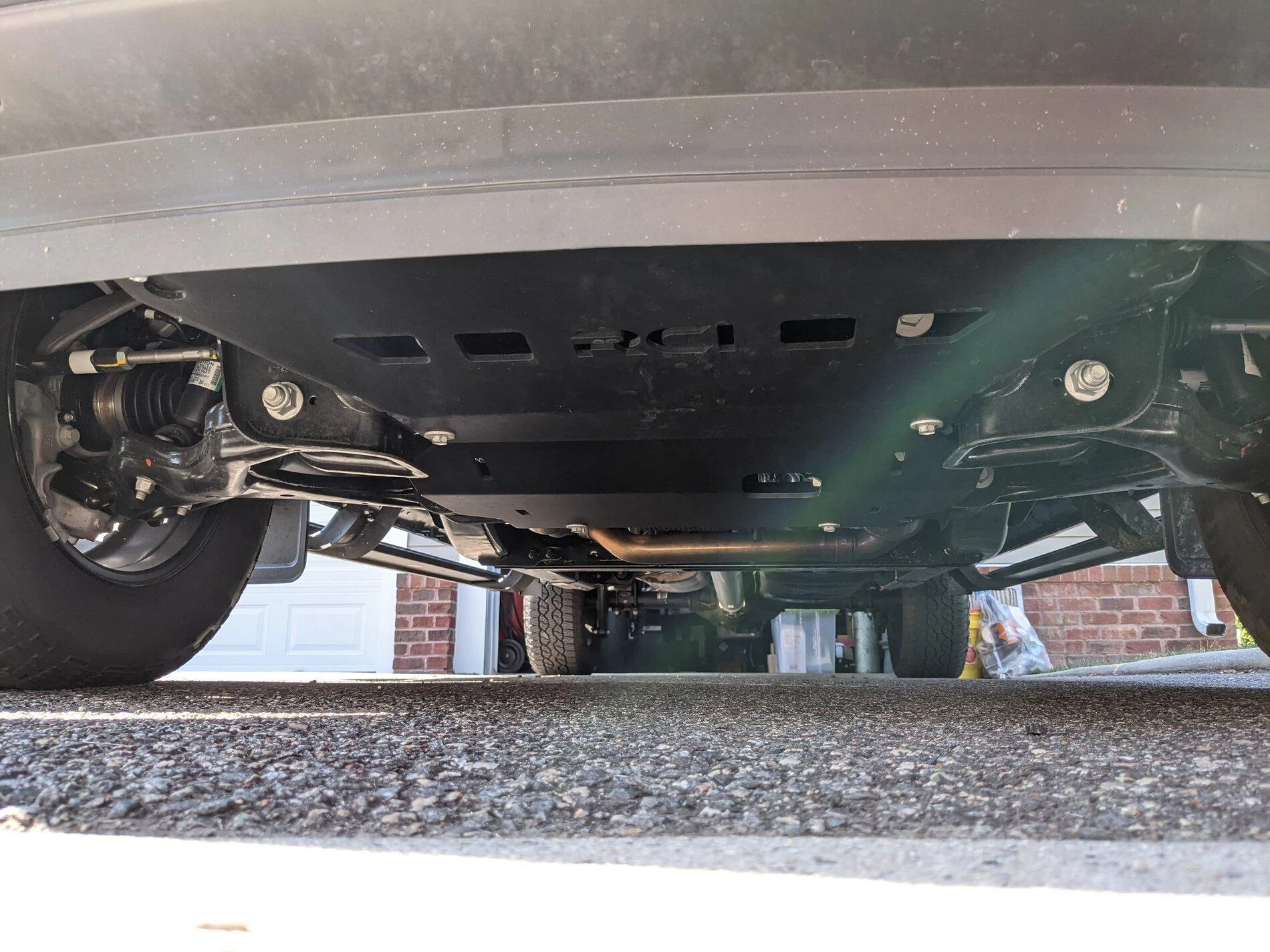

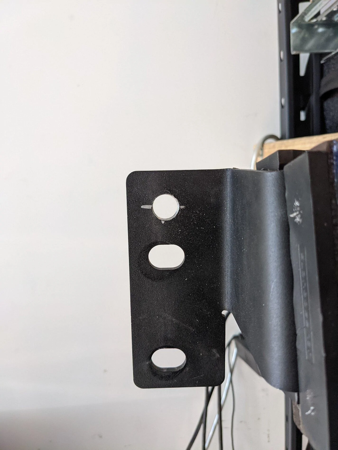

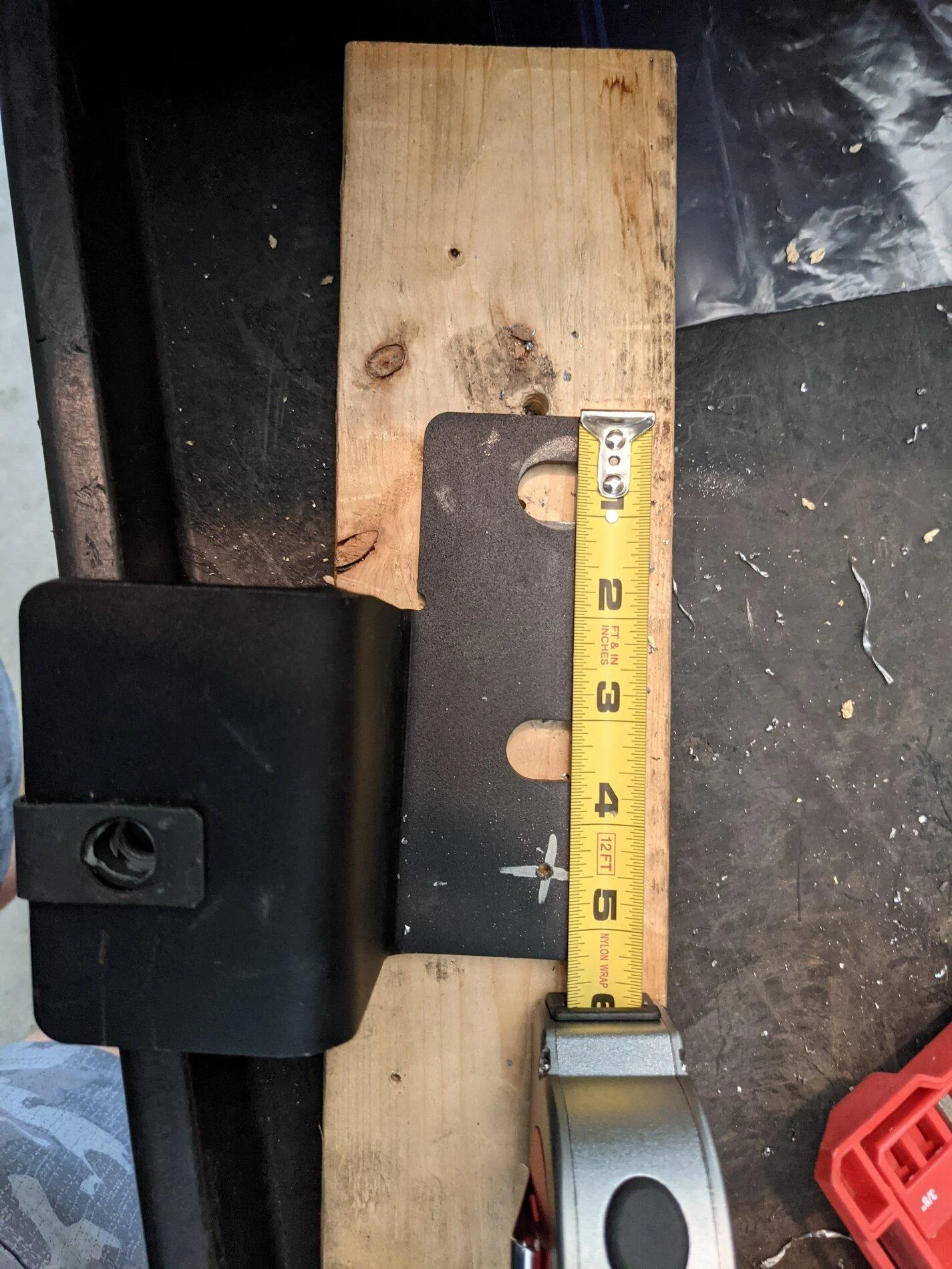

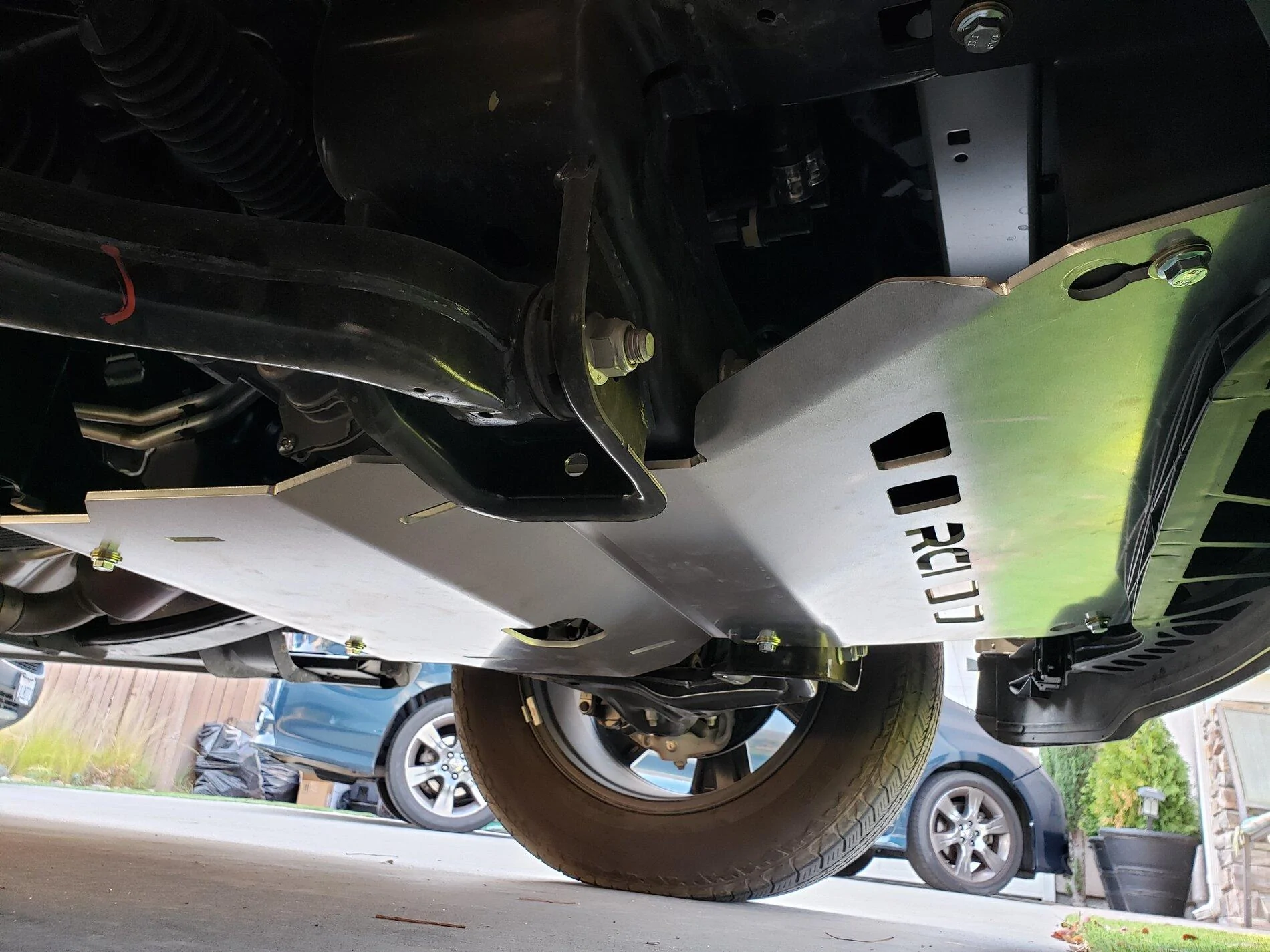

Do you have a pic of this installed?Wow, that's pricey. I wish I would have found this post before I bought the RCI skid plate for my XLT. For what it's worth I just removed the brace from the motors to clear the RCI front plate. It's only 3x M7 bolts on each side. I saw no reason to remove the motors.
Are you asking for a picture of the skid plate installed? I did it in my driveway and there isn't really enough room to get a good overall picture.Do you have a pic of this installed?
I would love to see a pic from the front end, maybe from the ground.Are you asking for a picture of the skid plate installed? I did it in my driveway and there isn't really enough room to get a good overall picture.

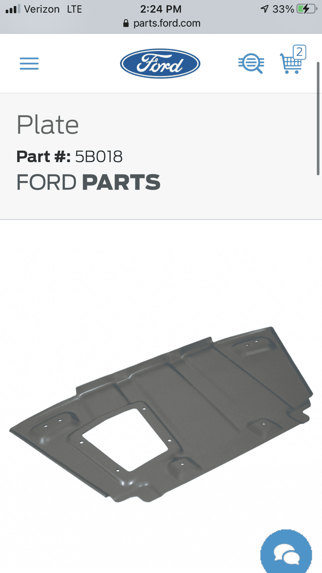

What’s the part # for the silver piece?I can confirm, the upper silver portion above the tow hooks is not part of the bumper. I ordered just that part to replace the stock XLT one (I cracked it). After looking at the schematics, it appears that I will be doing some trimming of the air dam once it arrives to make it look correct. I will do a write up similar to yours above and post it in this thread when its done.
