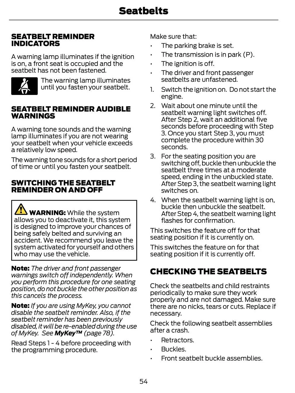

Might try turning the seatbelt chime off. Can turn back on after a bit to see if it still occurs.
From page 54 of the Owner's Manual.

Thanks. I did not succeed in turning off the seatbelt sound. May have been unclicking etc at not quite the right speed. I only tried it once, but I need to get the truck into service for some other stuff so booked it in for this as well.
