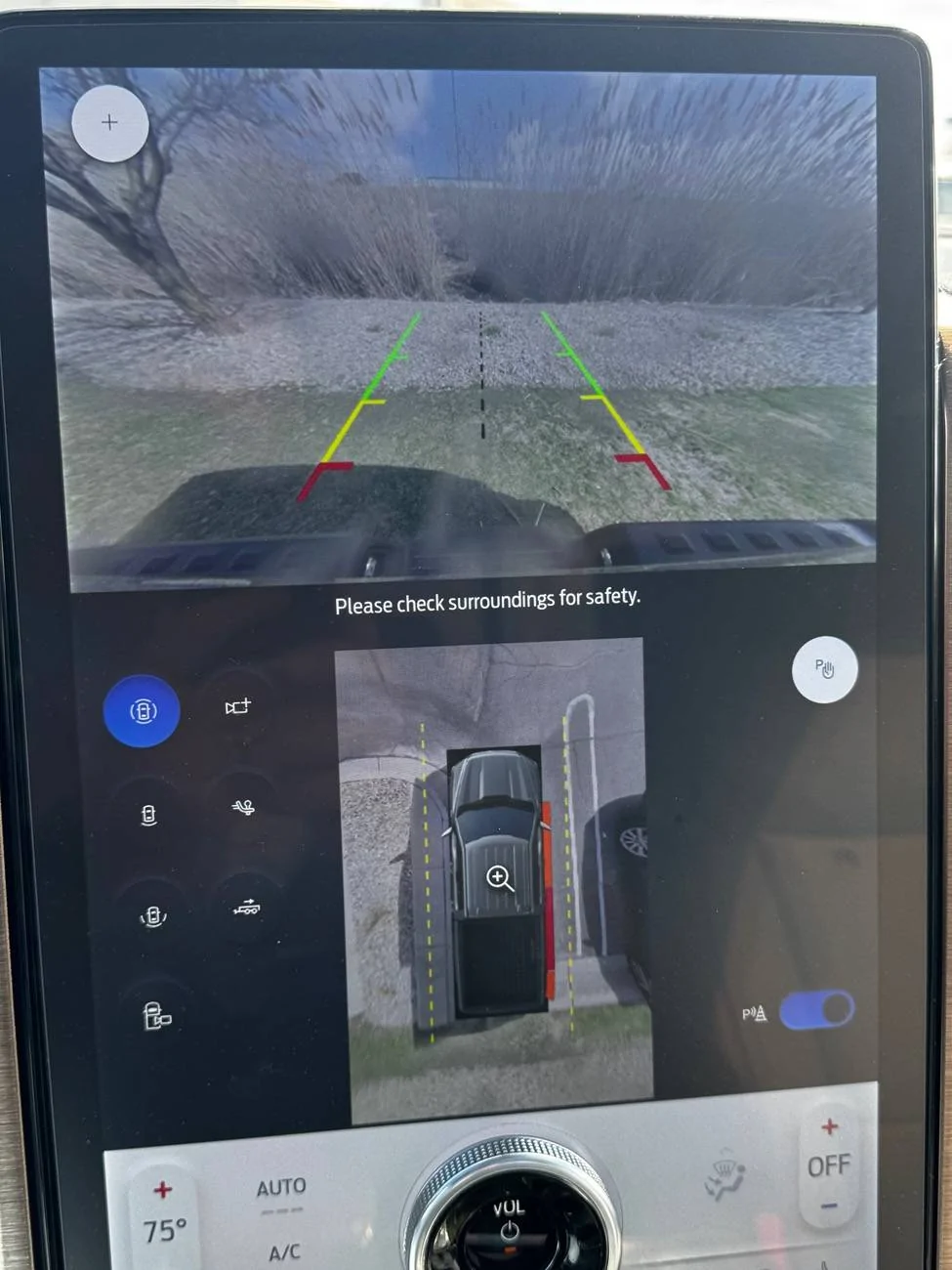

Seems like every time I select reverse, the right side is alerted to an object. Anyone run into this?

Make sure the sensors are all clean.

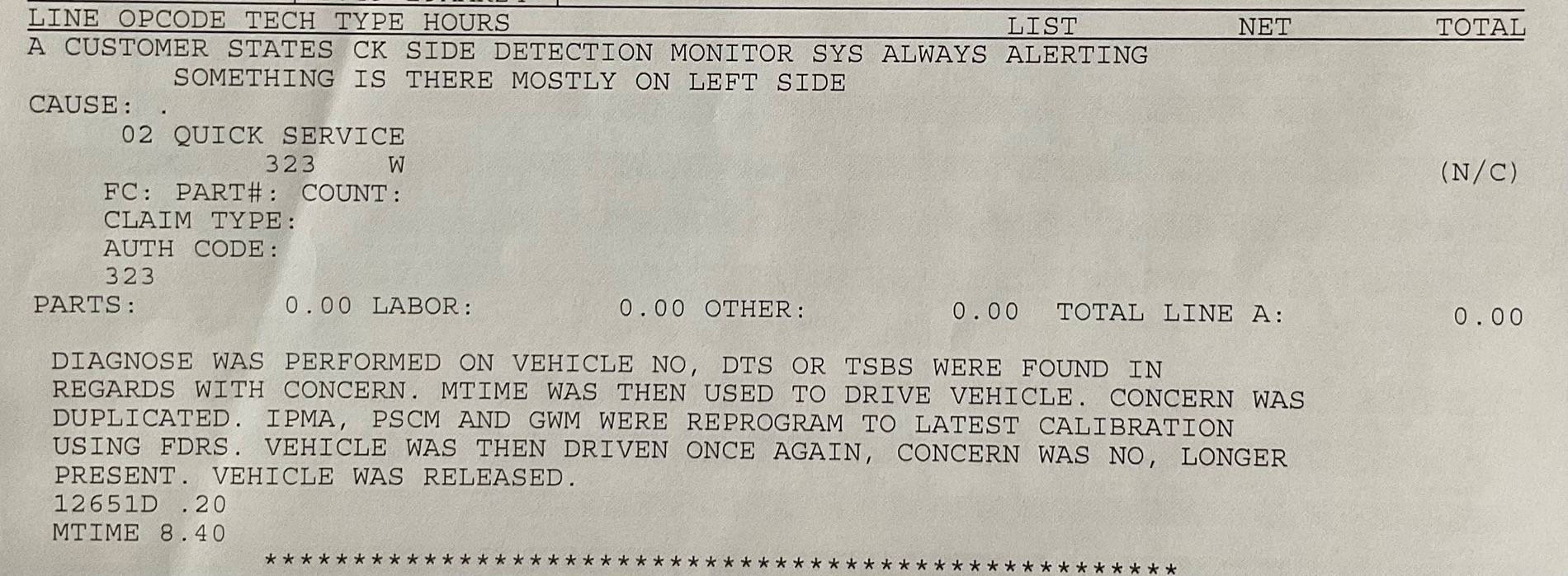

not anymore
This is what my dealer did but sensors still get randomly triggered when nothing is there. I donā€™t ignore them ā€yetā€ in case something really is there
Ford F-150 Lightning Side sensors constantly alerted IMG_0025
Brad
Jan 18, 2025
Lincoln phev ā€˜21 & Platinum Lightning ā€˜23
not anymore
I shouldā€™ve added that their programming approach was good for several months but itā€™s reverted bad to its old ways within the past few weeks. I do keep the truck clean so I know that stuff on the sensors hasnā€™t been the issue.
