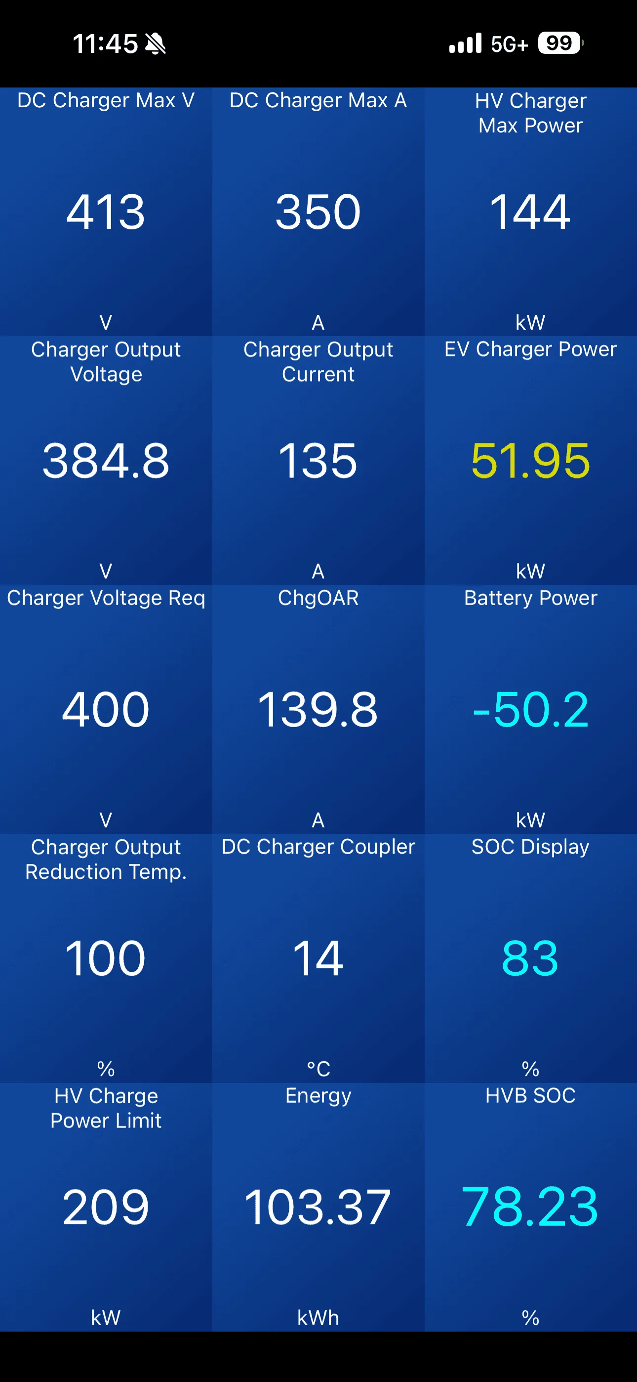

Also for those people first time heard a place called Electrify Canada
They are terrible as they throttle their 350kw charger to 350A, not like EA is the full 500A charger
You're above 80% sub 60's is normal for my experiences on 150KW EA units
Displayed value is 83%, I'm assuming that is the dash display of the HVB vs the 78.23 raw HVB SOC
you may wanna look at the “DC Charger Max A” value, this value is irrelevant to the SOC, and it’s communicated from the DCFC station.
What is your best rate of charge considering this limitation, 120 ish KW?

Glad to hear Plug and Charge is finally working. I've not seen it yet but I haven't used DCFC since the update. The numbers you are showing are still 144kW which is more than our Lightning can handle for more than a few minutes. I'd be happy with 144kW. The average for me is 125kW on my ER between 20% and 80% and quickly drops below 50kW after 80%.
Any chance your invoice shows a Ford PnC Discount? Wishful thinking....
But my actual charging speed is actually only 50kW...
This is normal with your SOC at 83%. If you'd checked a few minutes before, you were likely running 120kW at 75% SOC.
Correct, basically 375V*340A/1000=127.5kW
I think for those of you cares about charging speed, get an OBD adapter and start to get data out of the DCFC station.
It shows all info you want, even when the speed is throttled when the charging port is overheat (truck has no way to read out the overheat of the charging plug, as the speed will throttle by the DCFC station, and you will notice the DC Charger Max A starts to diving down from 350/500Amp)
